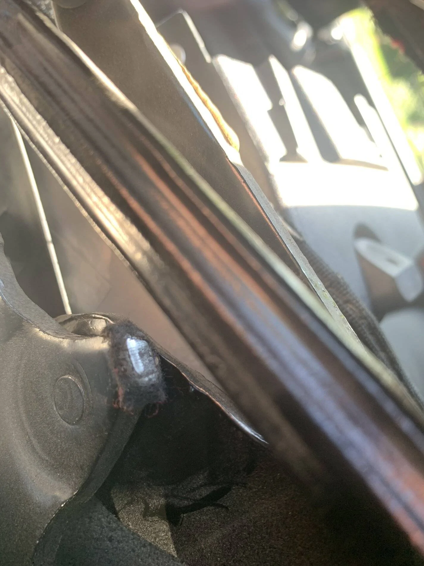

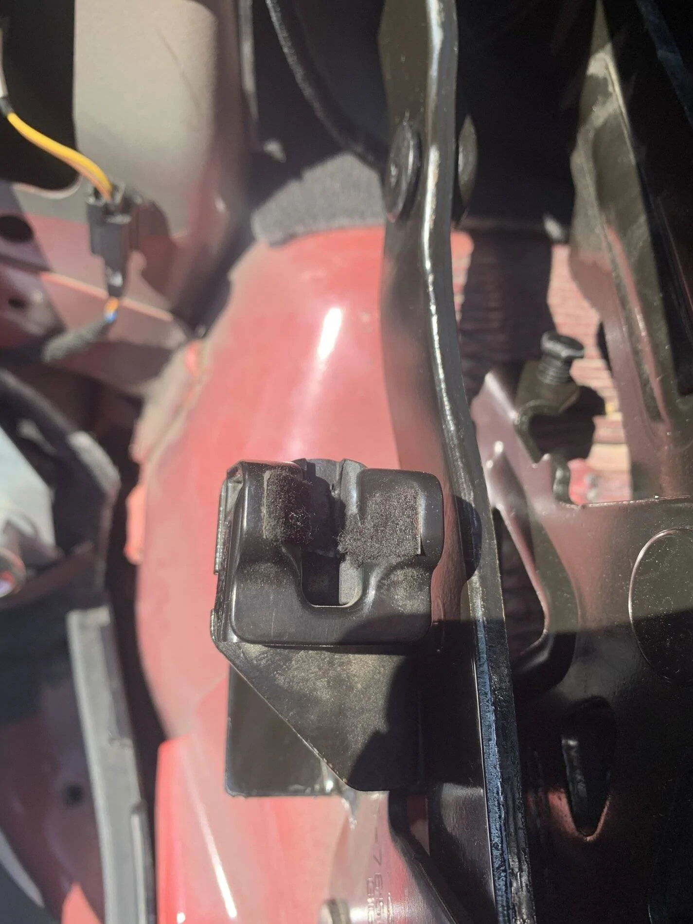

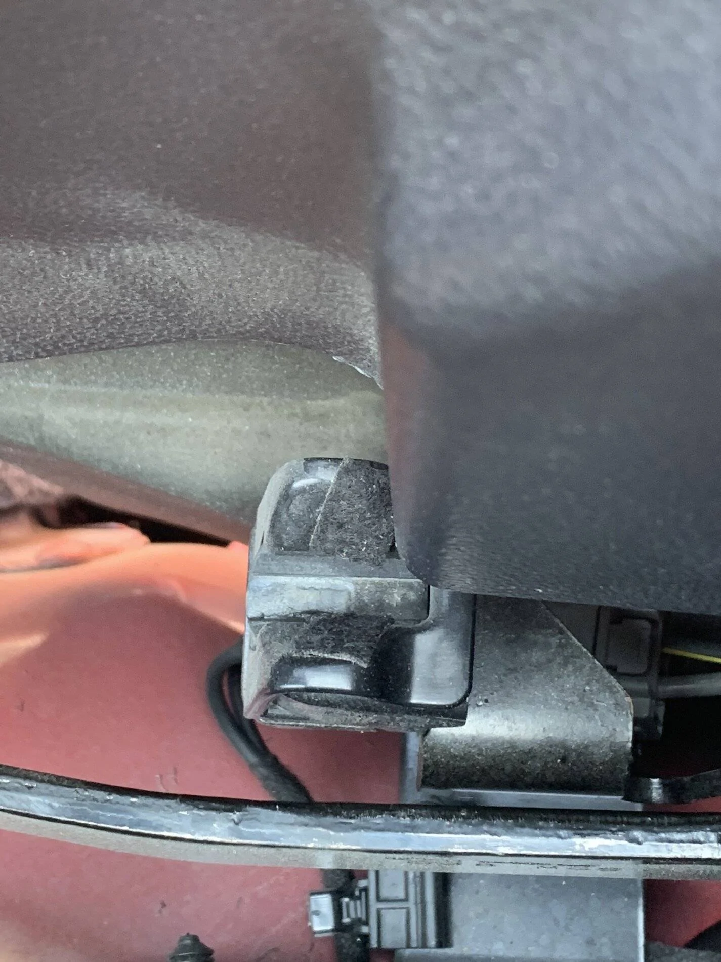

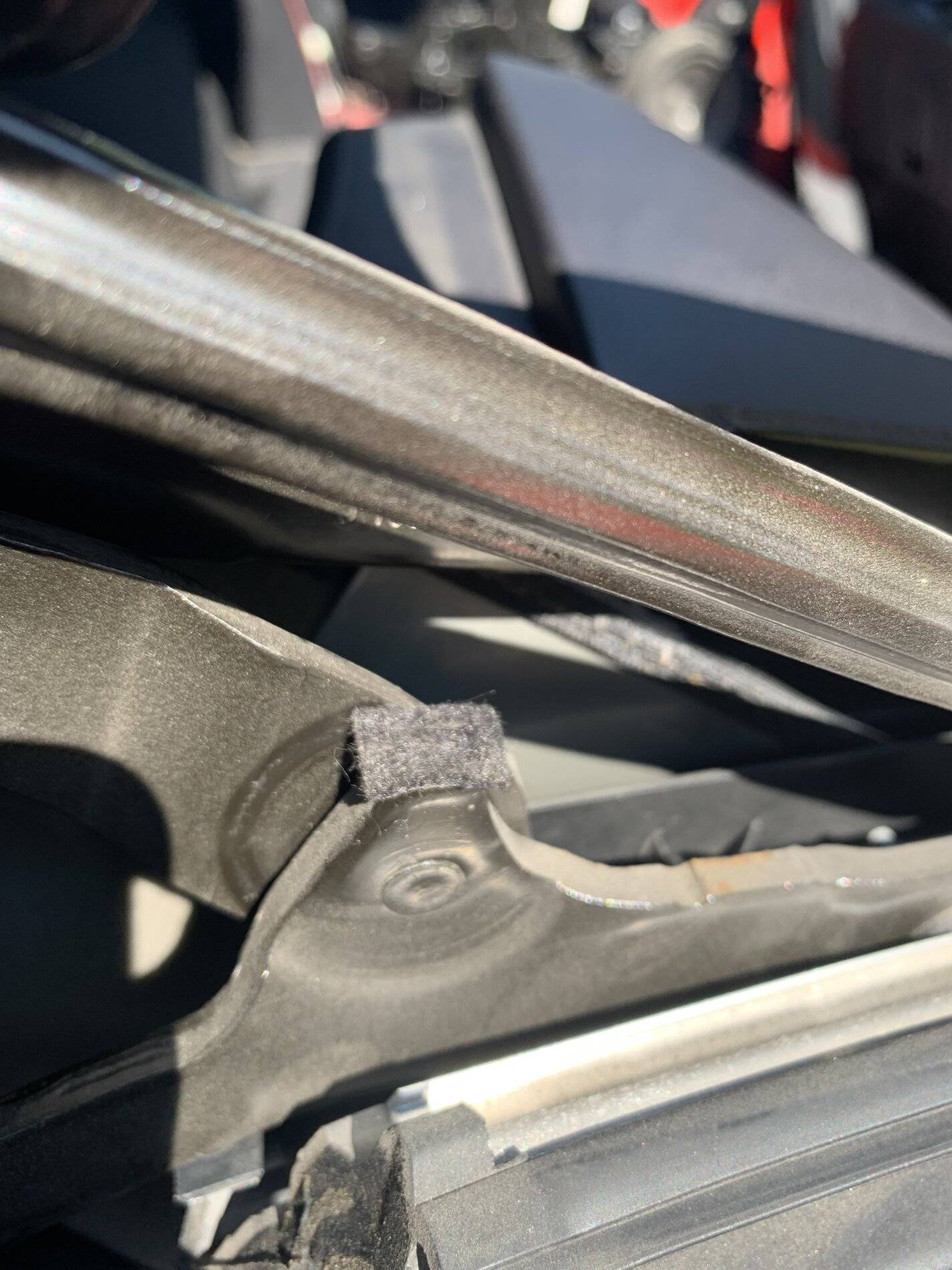

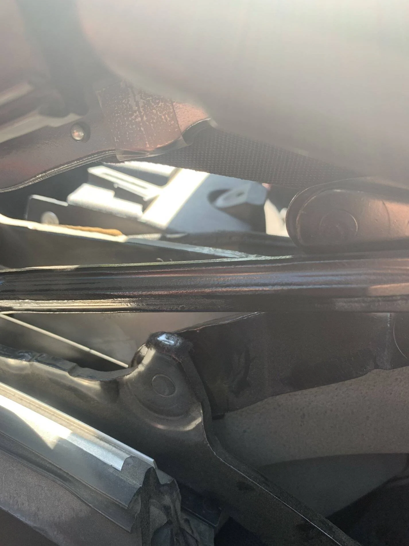

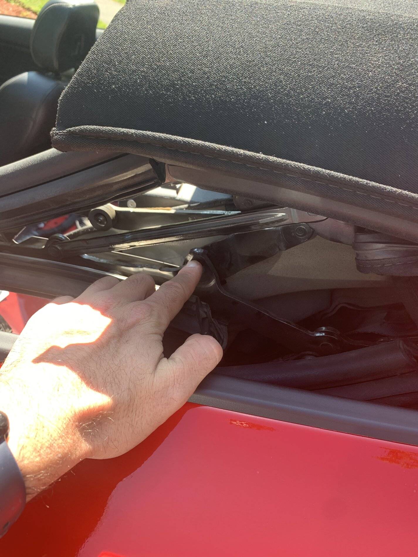

I fixed it!!!
If you raise your convertible top 1/4 way, you can see 2 pinch points that Ford lined with foam pads to prevent metal metal contact. One receives a tab of a metal bar, and one is in between 2 headliner bars that touch each other once folded. Those pinch points should be lined with felt pads, and the side that chirps had completely worn off felt pads, especially at the headliner pinch point. That explains why the chirp goes away as soon as you raise the top the slightest. Metal on metal is the chirp. I tested it by shoving a rag in there, lowering the top, and driving around. The chirp is gone! So check your felt pads.
