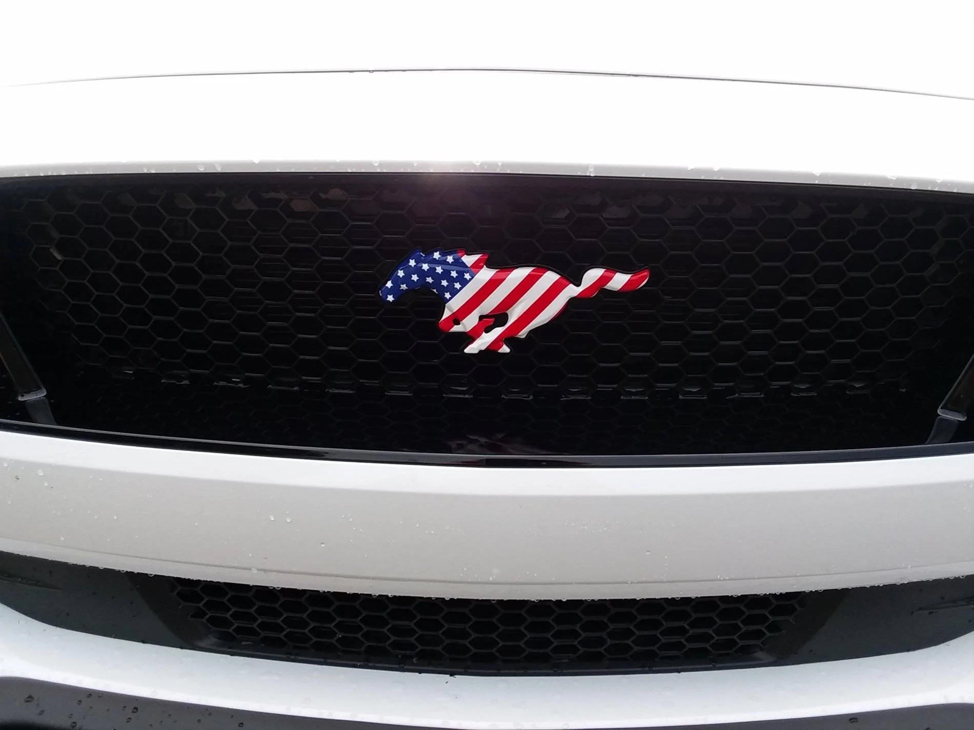

I see you still are running the heat soaker stock running horse grill...yeah, once you ditch it and go with an RTR upper like I have and look over the list of mods my car runs, you too could have an ambient to iat readiing that's nearly identical. Before my mods, especially the upper, the difference in mine running on corn still was about 25 to 30 degrees. You need a better upper grill and better hood venting to cool things down a bit, ask anyone else who's also done it. well worth the money spent. only thing was I liked my pony in the grill, that was a hard switch to make, but running cooler temps now is cooler than my old look was visually.

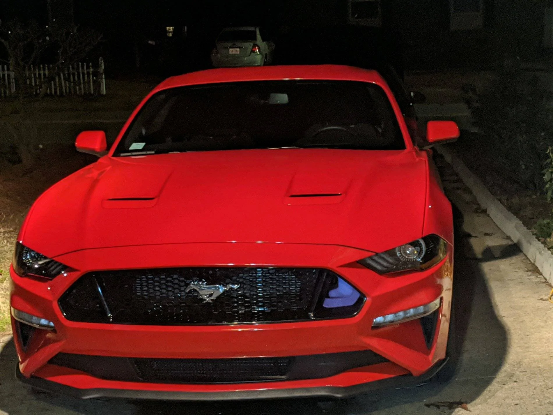

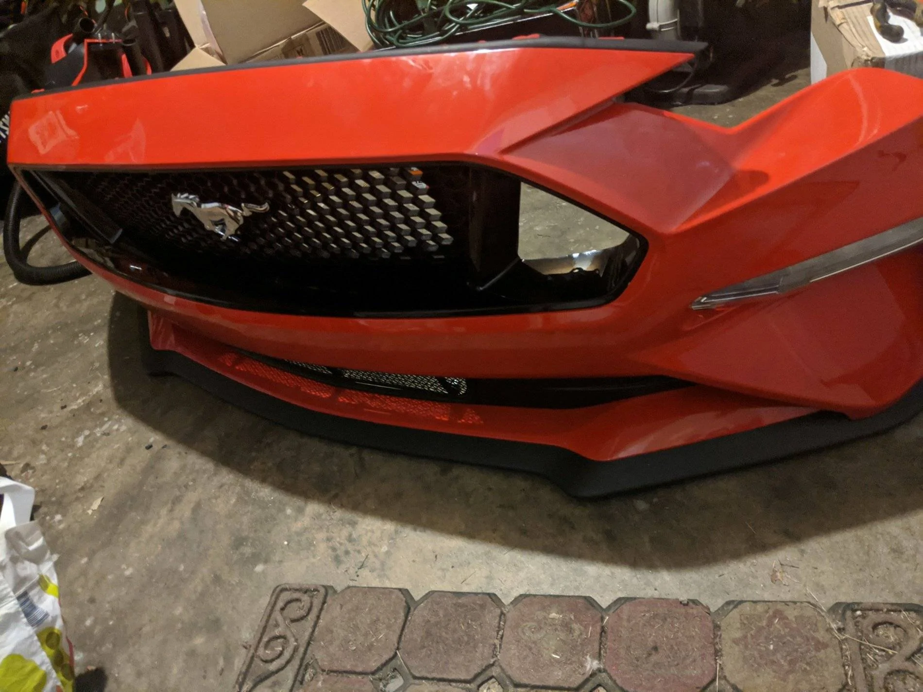

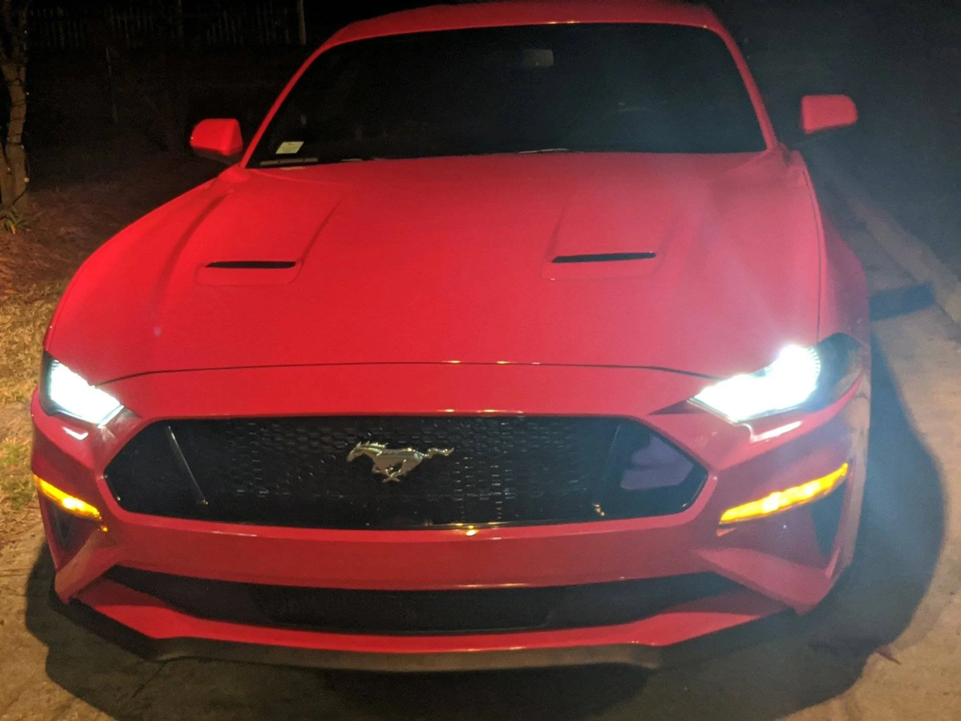

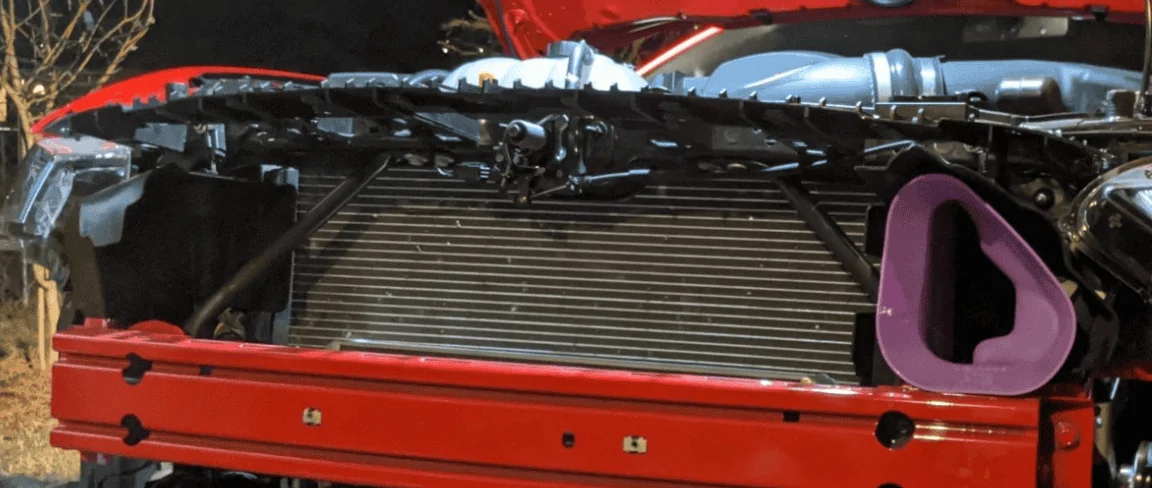

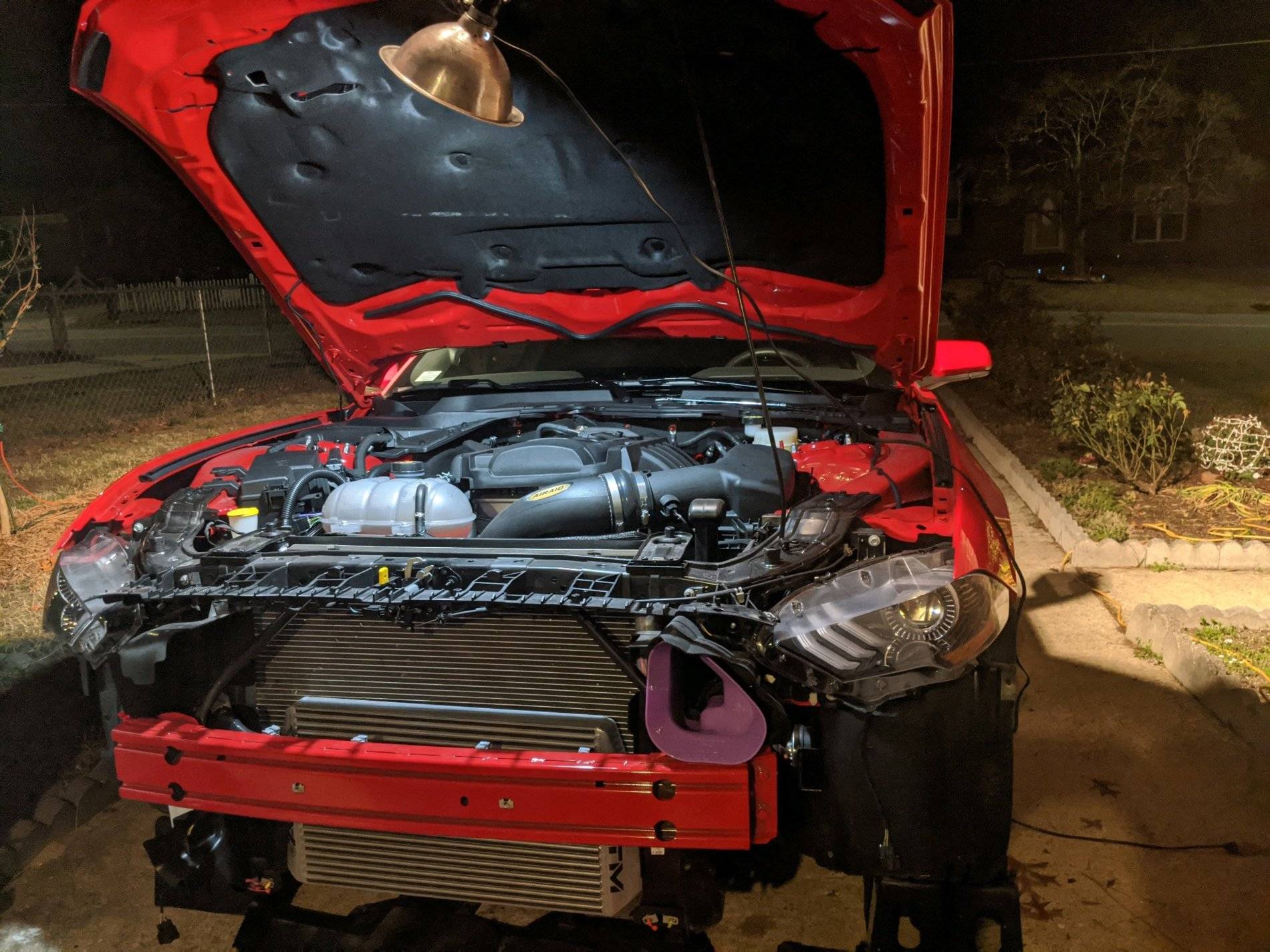

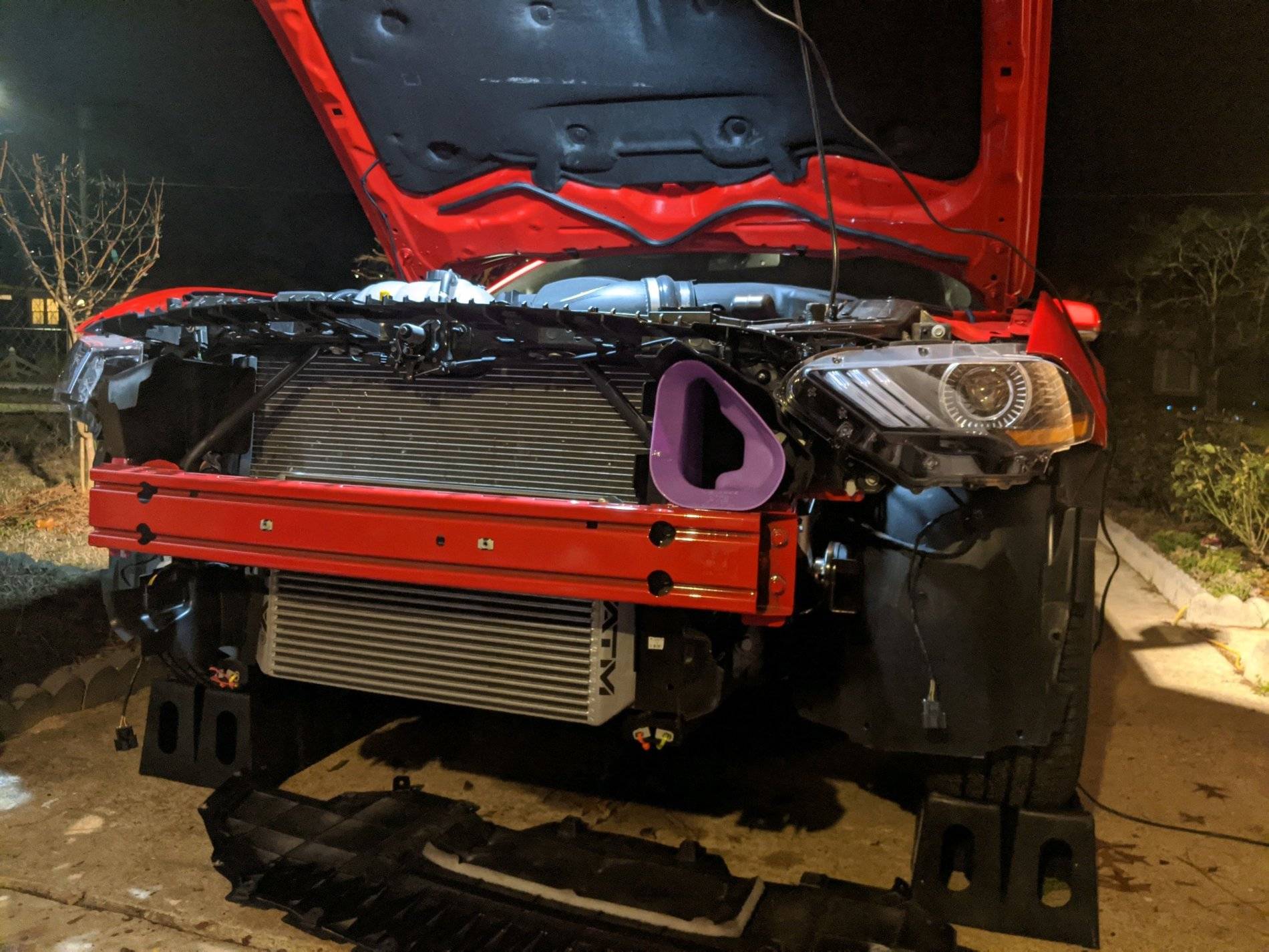

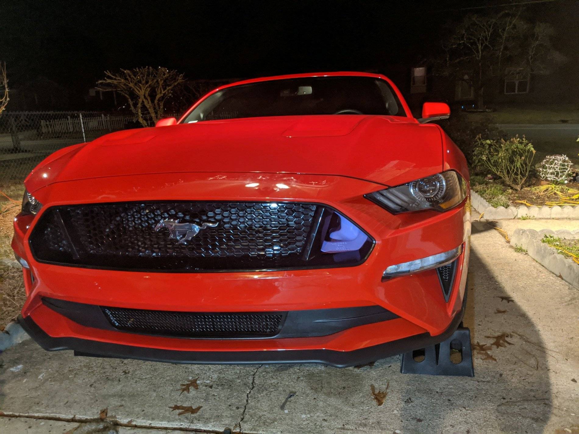

Velossatech on a 2019; fitment is not 100% like the 15-17s but close enough to not make a significant difference. Looks really good on the 18+ models! :thumbsup:
I think the understanding is the driver/intake side duct works more or less as as designed for MY15-20, the big change is on the passenger side, so like in your photos:
On a MY15-17 the passenger side corner is a mirror of the driver side, above you can see it's not shaped the same, the plastic[?] shroud makes like a rectangular area vs. the more "triangle" shaped space.

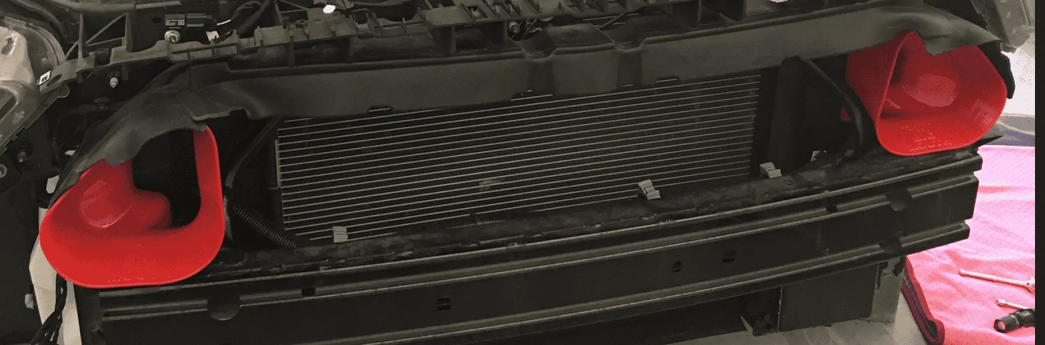

Here's the install, without the fascia from my previous MY16, you can see the corners of the area behind the fascia are pretty much symmetric:
