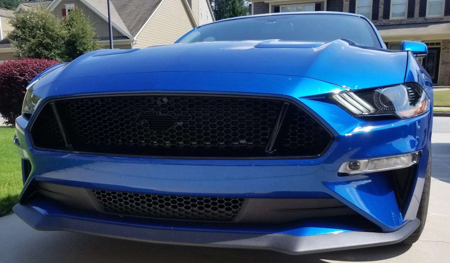

The reason I didnt do the Velossatech was that it physically changes the shape of the inlet of the intake by proxy of form fitting into the OEM duct, lengthening it etc. Not sure how it impacts the airflow into the pipe/etc or the resonance and airflow within the OEM setup, but since the OEM one works great I just focused on more flow overall since at speed, air temps drop rapidly to ambient (in seconds) with sufficient flow incoming either way.
What I did instead is i removed the OEM pony and carefully trimmed out all but the silhouette (kind of like the camaro's flowtie on the Z/28 in 2014), as well as opening up all the honeycomb on the drivers side inside fang area and the other side of that fang too. What I can tell you is that this made a huge difference in throttle response and cooling efficiency for my car. I suspect the pony causes turbulence and air to be pushed up/away from the other grill inlets so once its gone and that is open inside, the overall flow is more direct and not as turbulent, of course including more air overall directly towards the OEM inlet area and through the middle of the honeycomb. I am one very happy camper with this done. :)
I call it, my Flow Pony, or Flowny for short lmao. Use a carbide bit drill (small, then medium, then large size bits) to drill center holes in each honeycomb. Then switch to a Dremel and use the gray metal grinder cone shaped tools and literally grind it out carefully. Once the plastic heats up the dremel will cut it like butter, hence the nice smooth cutout of the horse I did in about 1hr.
Link to info about this type of thing on the Z/28. Its not about the surface area but rather the disruption of airflow around the blocked off piece:
https://www.roadandtrack.com/new-ca...eewIKE-ngcR9wE6jzqc8lb86cr6MrOlPA5C5W7lbV7Qyo
Pics (dirty car warning)!
And with highlights to where the honeycomb / pony were opened up. The rest I left closed for minimal drag/etc and because temps are well in control, no need to do more imo:
