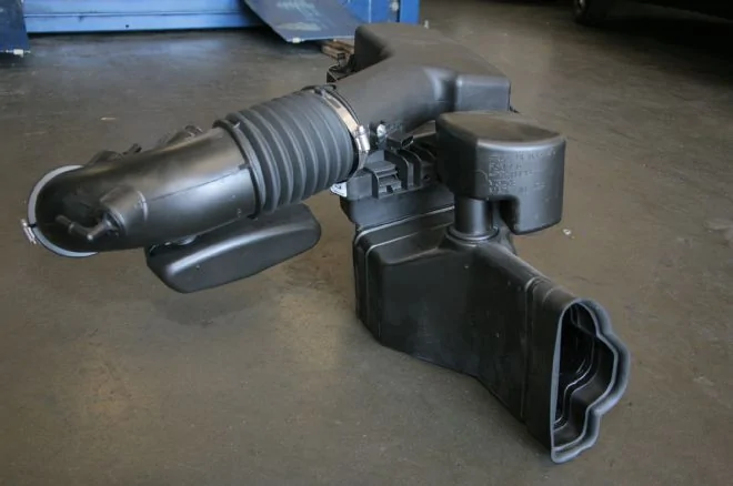

So another maybe dumb idea to not remove the bumper. Really scared of those clips lol, on my 14 I took the bumper off a few times but people seem to break them a lot on the 15’s.
Anyways another idea. What if I take the airbox out stick the big mouth into the airbox then put the airbox back in. I’ve attached a picture of the airbox to see what you guys think.

Oh and if so I would probably cut out the opening of the grill from the front. Just get rid of the closed up honeycombs and not cut out the whole section.

I openned the holes using a router and a 1/2 in bit thru the back of the grill. This way the honeycomb
holes are perfect. with the dremel you scratch the sides of the honecomb.
removing the bumper is not that bad. there a lots of videos about doing it.
you will notice the difference in IAT...our weather is very similar to lower florida....
If not convince yet ,wrap your airbox with thermowrap. it comes in 12x12 panels.
I did it in my 16. and measured the temps outside the box vs inside heating it with a hair dryer
and was a significant difference.
should be around a post about it ....
