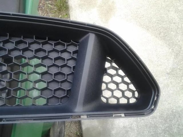

As long as my car is in the shop with the front bumper off, I might as well do this mod. Dremel and almost 2 hours.
How did you do it?
I've seen some people drill a hole and then dremel out...some just sand the back until the plastic is gone. Yours is the cleanest I've seen, it looks stock!

Thanks. Well, it wasn't as easy, or as quick, or as precise as I wanted.
I have a Dremel 4000 series kit, which comes with a long (too long) 1/8" diameter "routing" bit. Spiral flutes. I used a speed of 15-20,000.
This bit also has drill bit style tip. So I just pushed it up into the cell from the bottom, and then worked around the hex frame. Sometimes it wanted to grab, but it never quite chewed into the hex frame walls.
Then I followed that up with a small long-taper cone small grinding bit. This was a way to clean up the final ridge, as well as sand off all the plastic hairs left behind.
In hindsight, I might have looked longer to find a shorter steel bit with higher-rate spiral flutes. That may have given me more control.

How did you do it?
The easy, clean, and quick way is to take a router bit (Dremel or otherwise) to the back side just deep enough to get past the plastic fill, maybe 1/4".

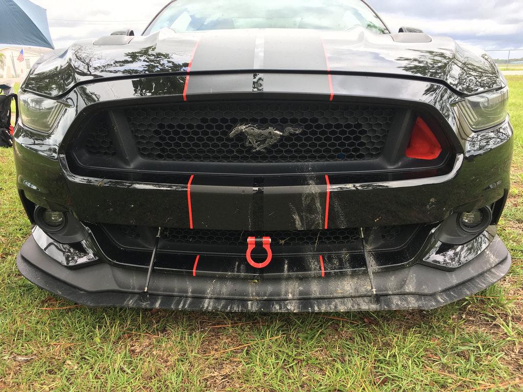

Or just cut the hole thing out and be done with it - don't mind the dirt, did a little off-road at the track in the rain. :)
Untitled by Stoli-v, on Flickr
