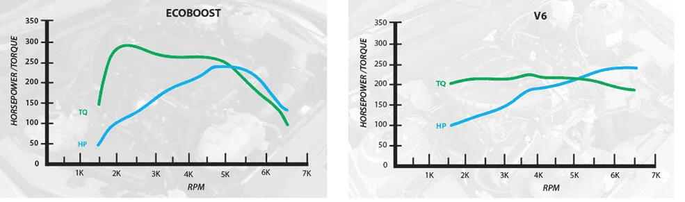

Basing a purchase on a few HP one way or the other doesn't apply here. It's the power band that's completely different. Don't remember where I got this rear wheel chart. Also, I'm real happy with my V6.

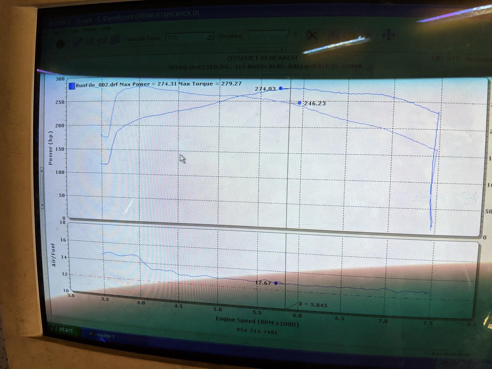

100%, love how linear mine was:

was this your stock numbers?
No, iirc that's with MPT 93 PRX, Roush intake, ported throttle body, and catback exhaust. No idea what the same dyno would have shown for stock.
edit » looking through my pictures, it also would have been with ported intakes too
