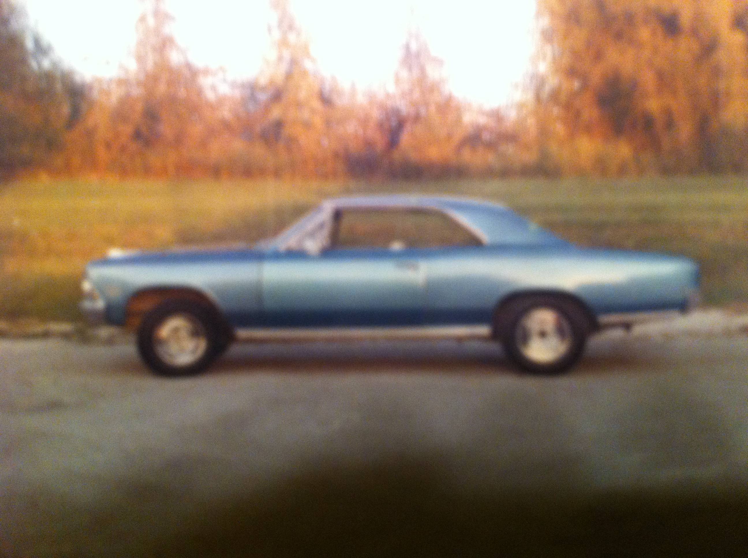

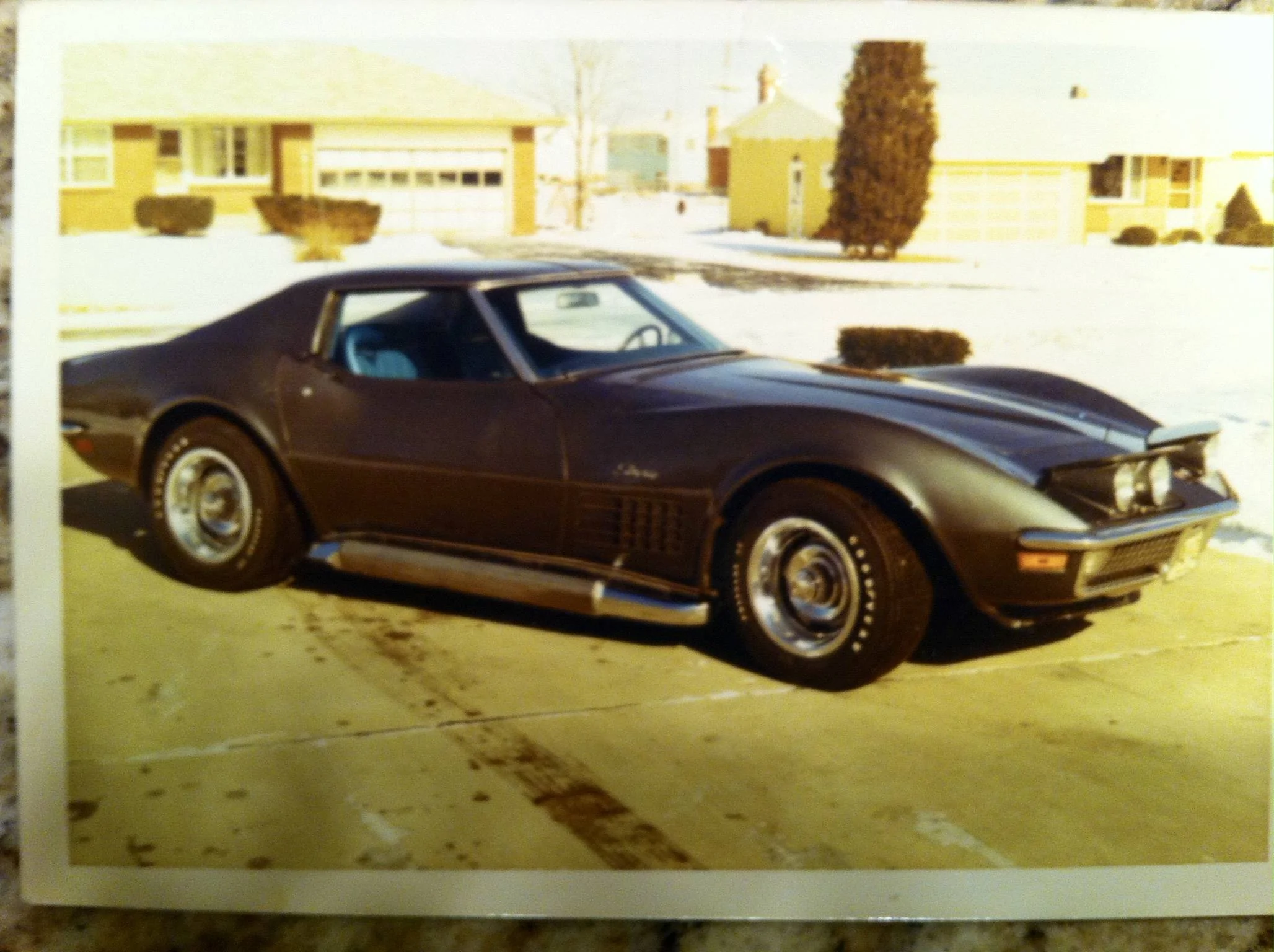

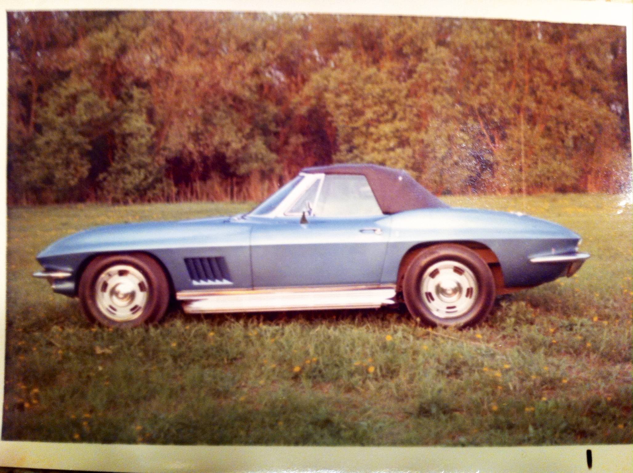

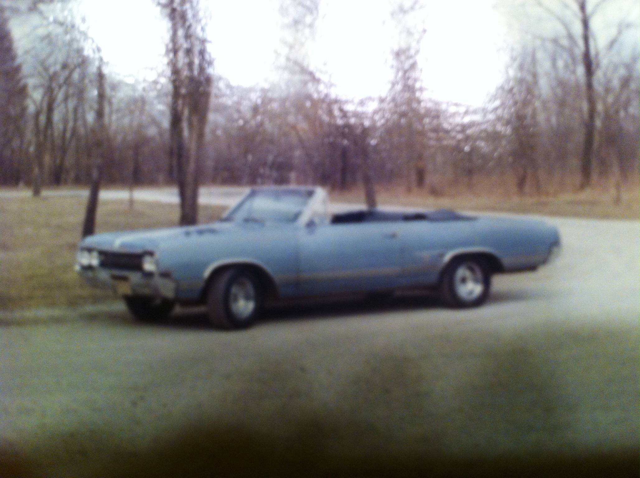

I’m with you!
never had to see problems with my former ‘65 442, ‘66 Chevelle, ‘67 Vette, ‘70vette.🙄

Had a 65 442 too.loved that car.best friend had a 67 435hp vette vert.what a monster car.was stolen never to return

Oh no! That’s too bad. It or parts of may still be around somewhere.
My 66 Chevelle had a 427/435 out of a wrecked 67. Had 77 Impala 427 emblems on it. Some thought it was factory.
