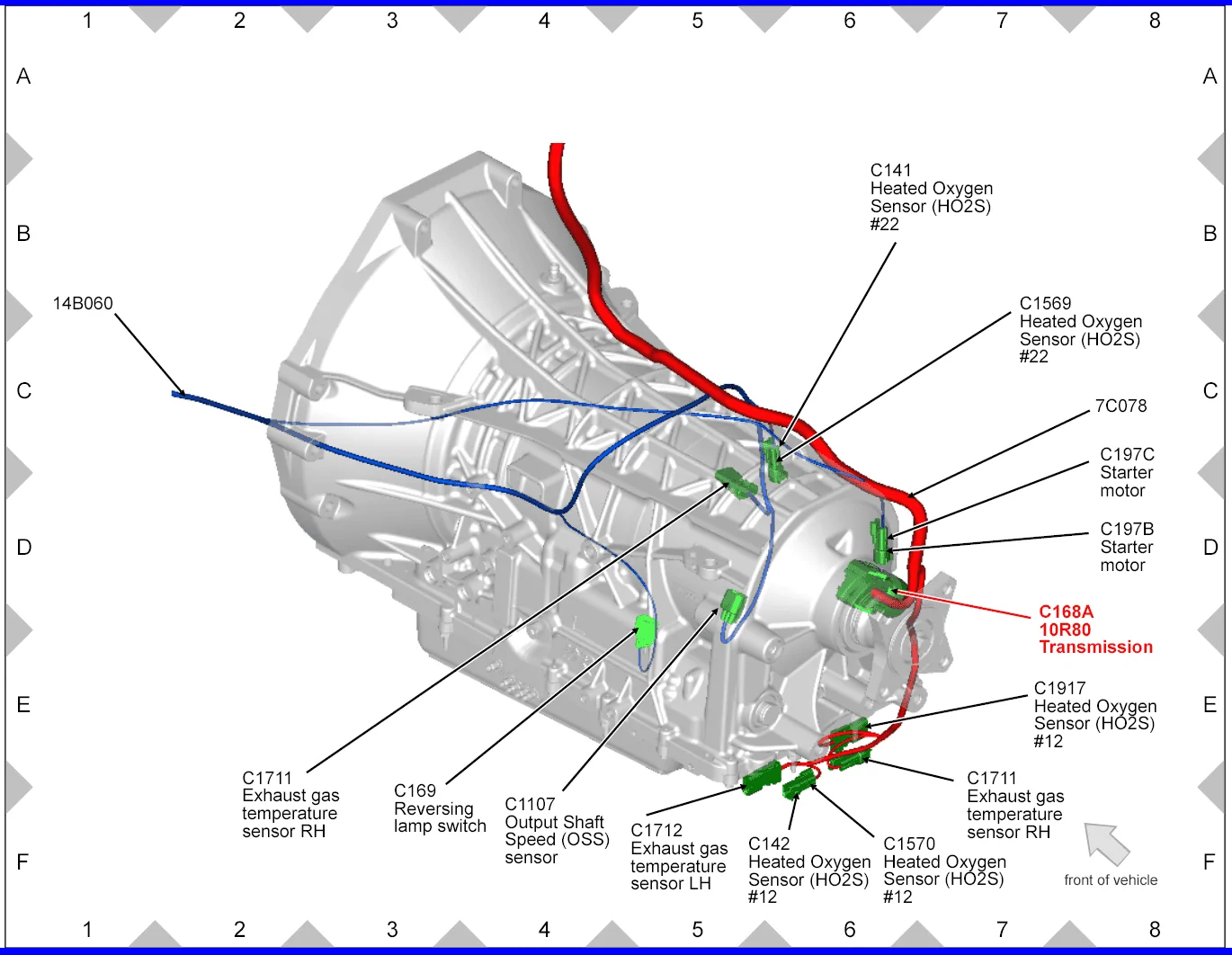

With respect to the engine harness, I'm attaching some documents related to crate engines and harness installations. The logical diagrams will give you an idea of the connections involved from the Powertrain Control Module (under hood, under the fuse box) to the engine components.
If it's from the PCM to the engine and trans, several thousand dollars seems excessive. But if they nicked wires from the fuse panel to the Body Control Module (car interior, with connections to the fuse panel under hood) or other components, that could be very involved. Someone with experience might provide guidance on that.
