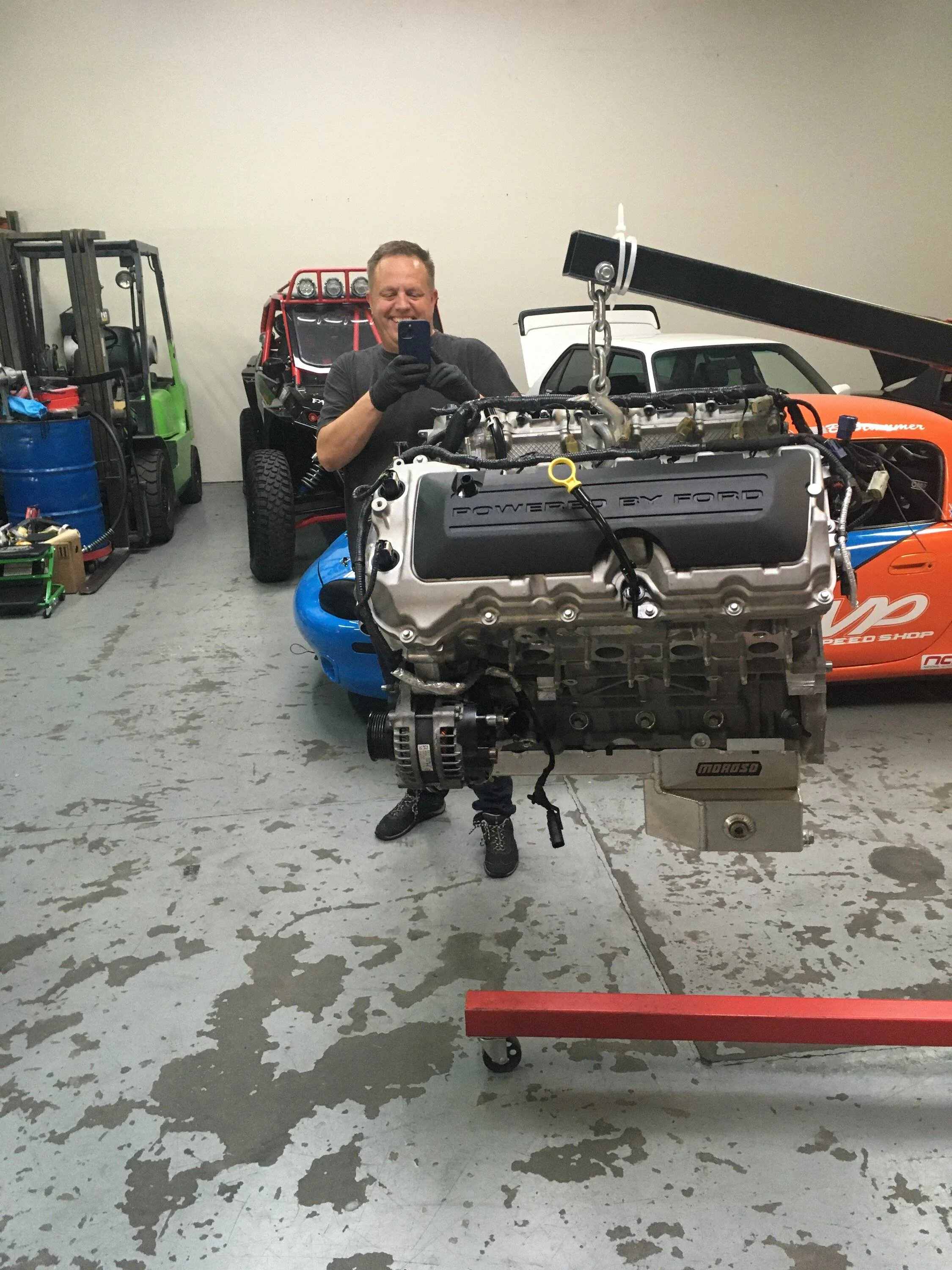

hmm so you have to take the enine out and get that harness replaced? Wish there was a shop like this nearby.
No, you don’t need to take the engine out. The picture was just to show you how the harness is routed on the engine
I see, haha thanks! If it's just the upper engine harness, 7k would be too much..
