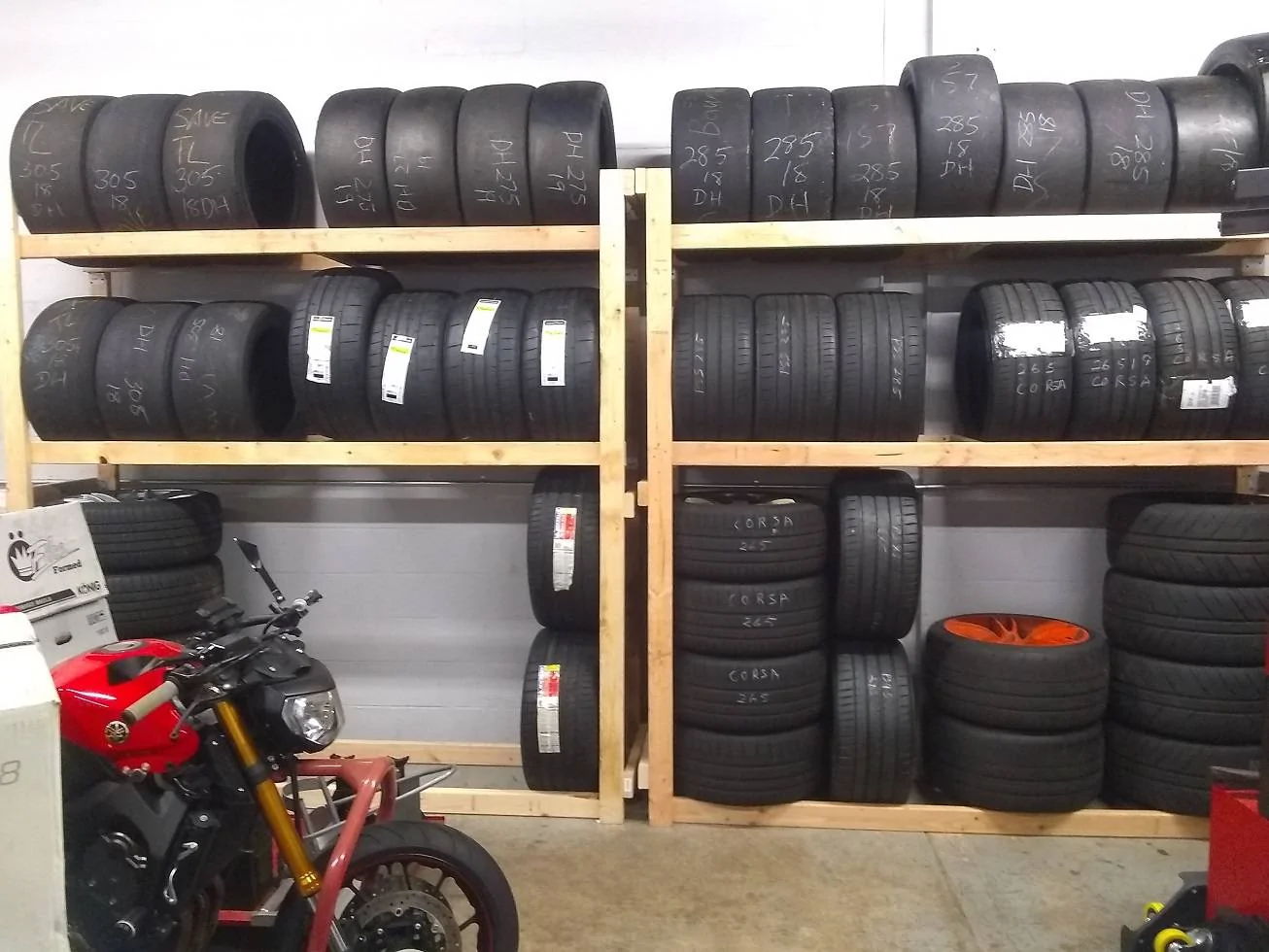

If you fancy a drive over to Manassas you can choose from my tire and wheel emporium. I have Cup2, SC3, SC3R, PSS, PS4S and new wheel sets from 19x9.5/10.5 and 19x10/11, 20x11, and some others.

it's my personal collection and no I haven't yet sprung for a no-touch tire machine. I use a couple places that have Hunter Roadforce equipment.
