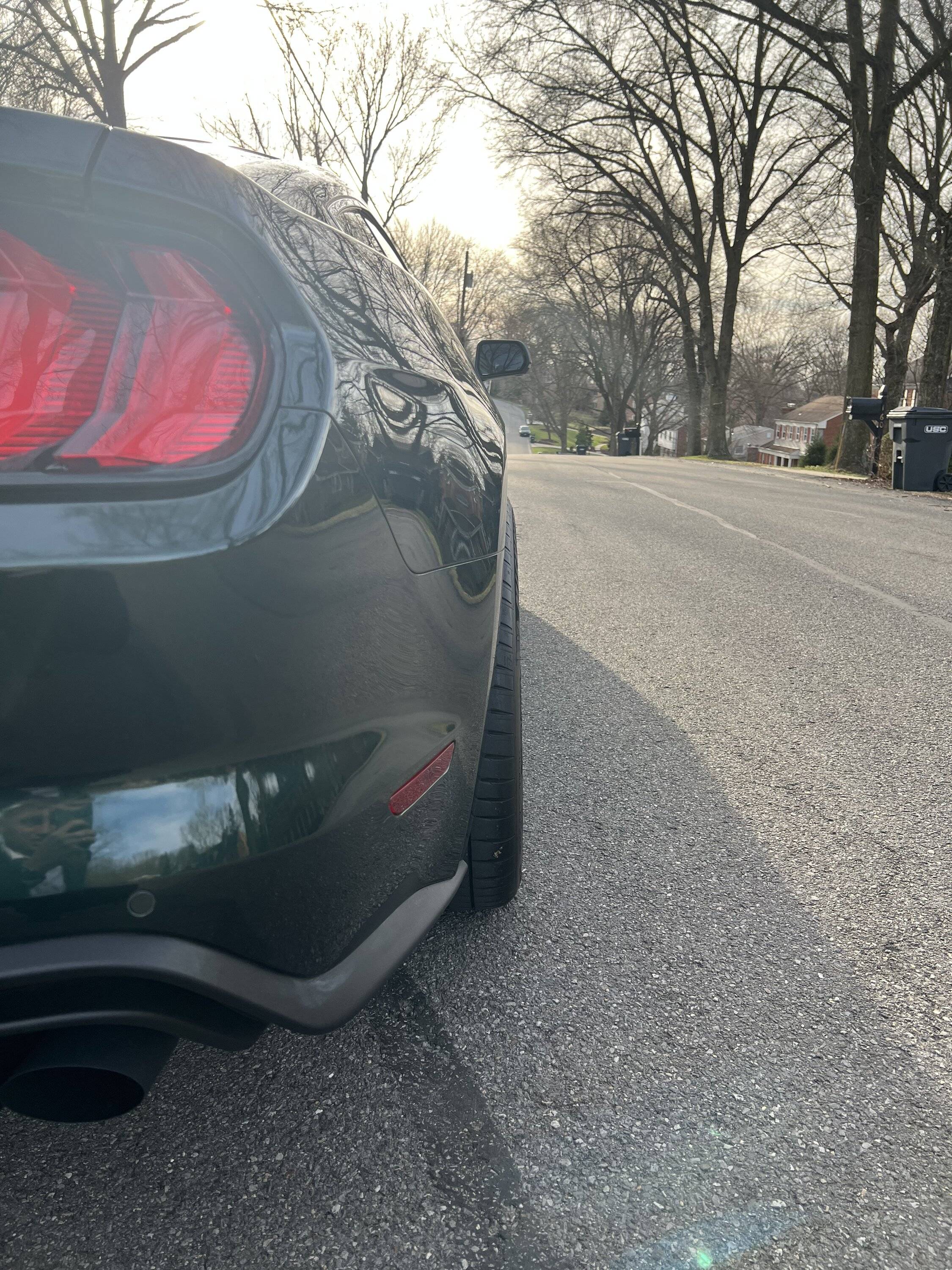

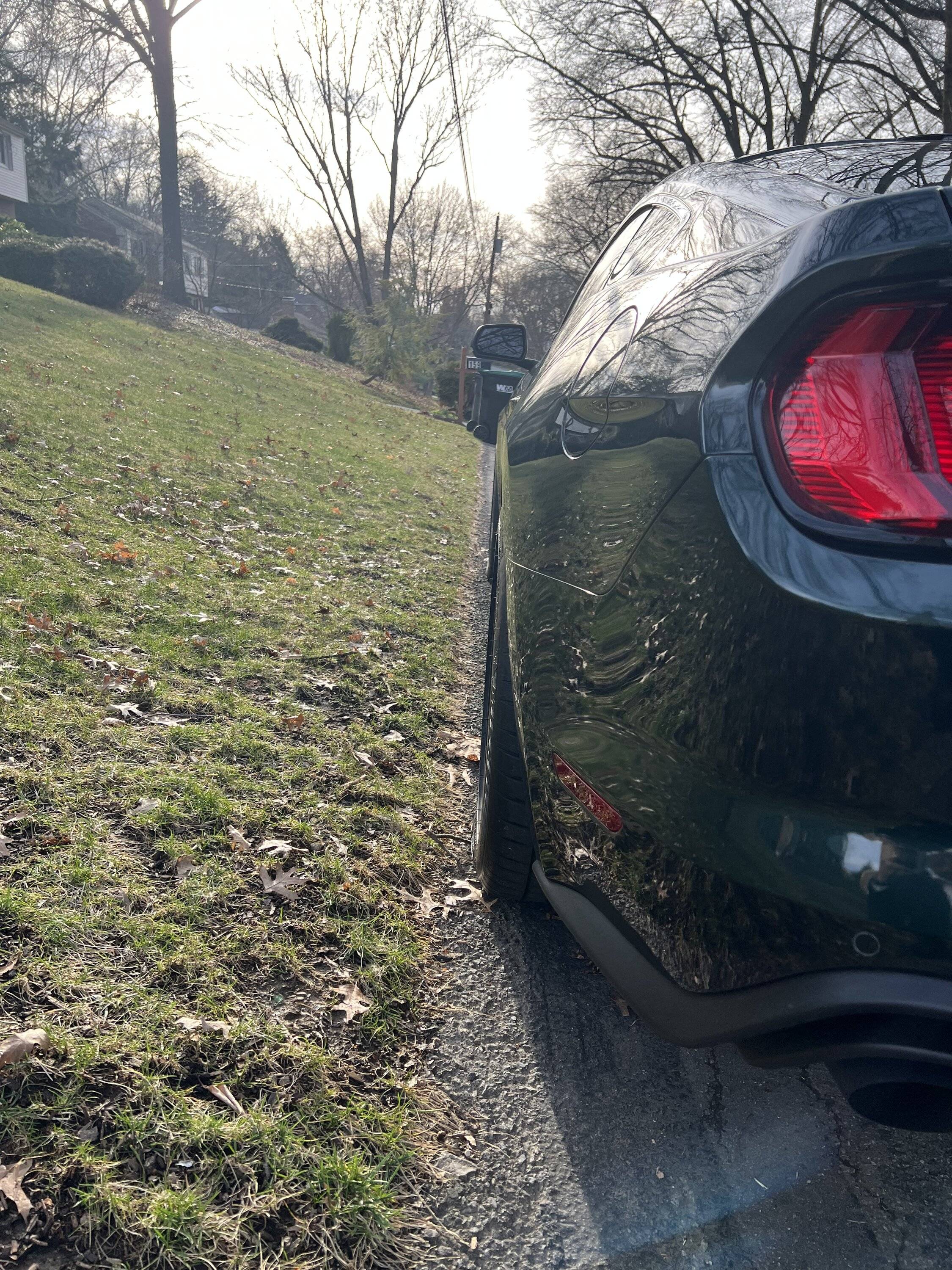

So I just got my car lowered on steeda progressives and put the 20mm spacers on the rear, 1” up front. I didn’t notice it til I got home that the rears are pretty different from the level of poke. I double checked to make sure that the rears were both 20mm. The car was also aligned. Any ideas on what is causing this drastic of a difference ? It’s not bc the car is sitting on a slide curb. It looks the same way when it’s sitting in my garage on flat surface

Check if the camber is actually even, left to right.
Anything that isn't camber or offset is coming from the frame/subframe. There are subframe alignment kits that help with this sort of thing.

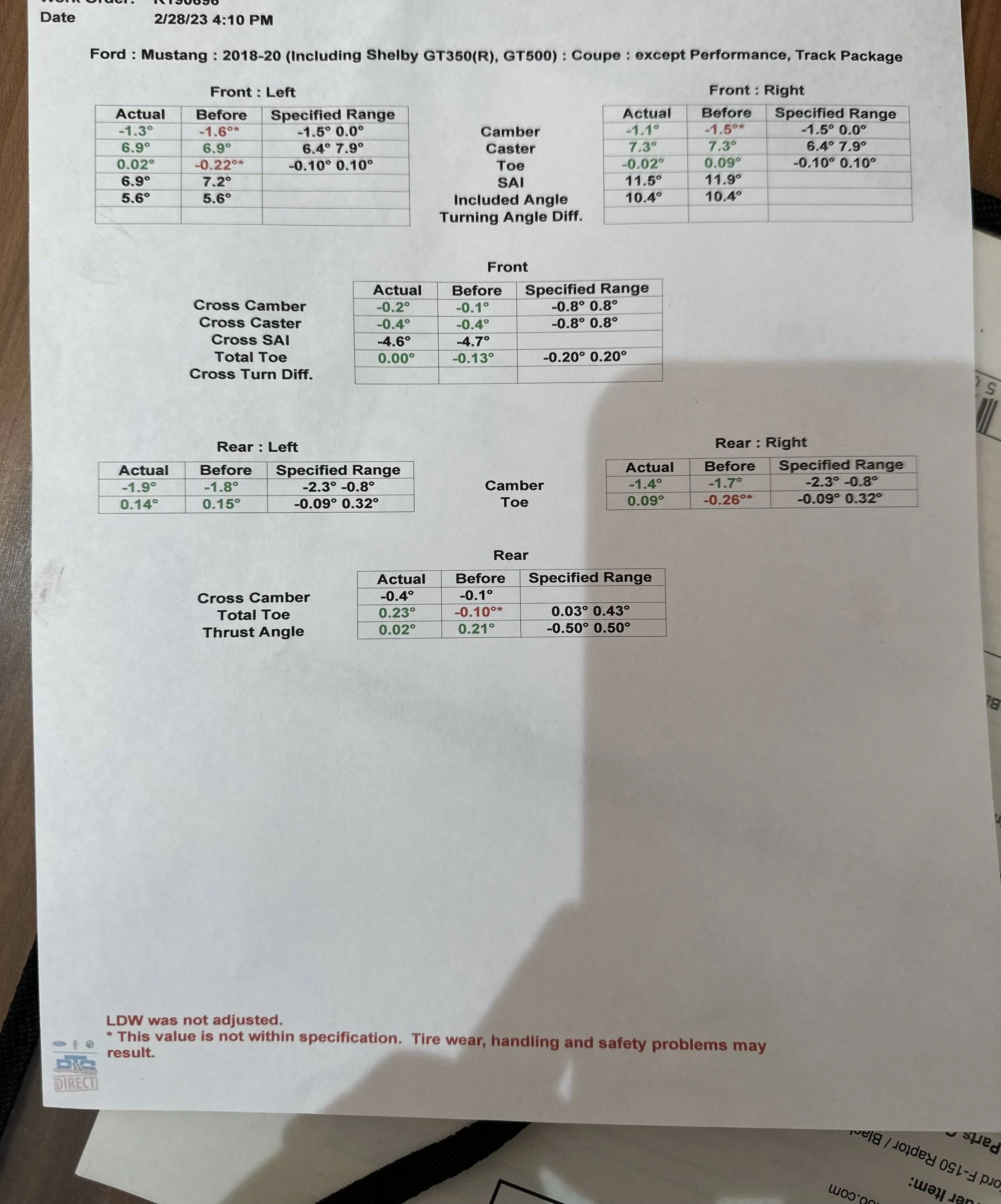

You have .5 degree more camber on the left than the right. I'd take it back and have them even it out. That is the reason for the poke difference.

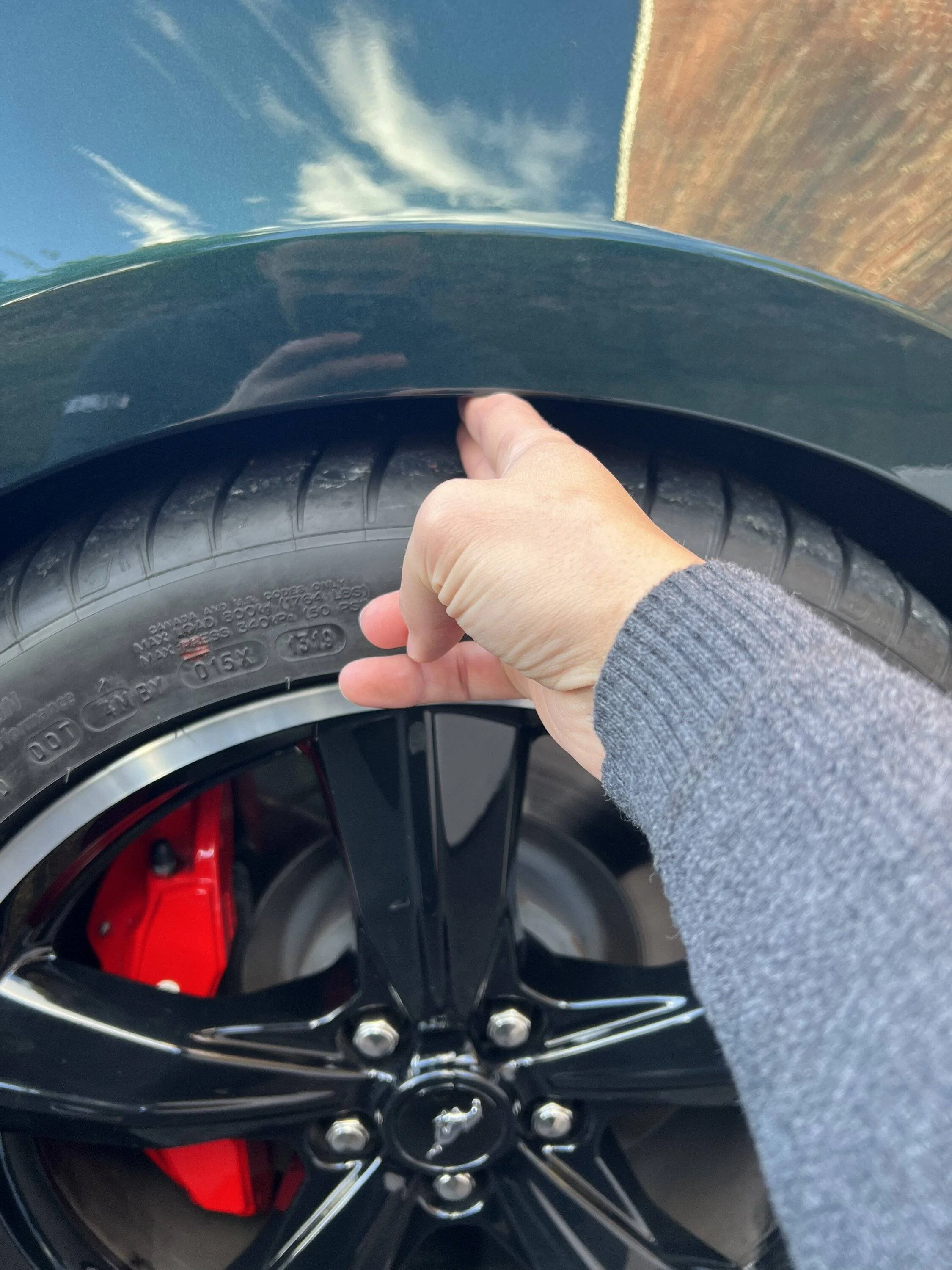

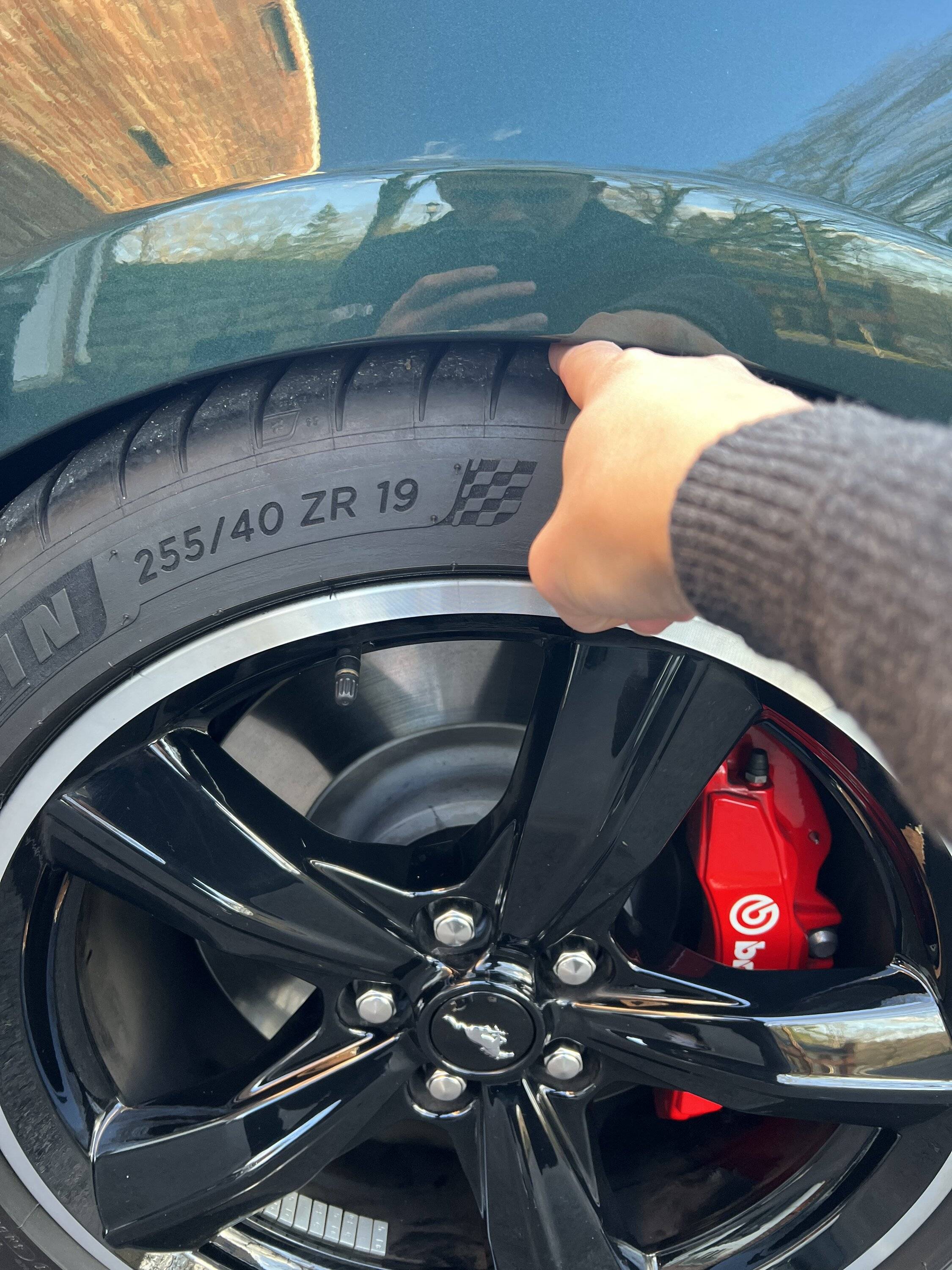

It is best to first place it on truly level ground.
Then check whether it is the upper edge of the wheel or also the center of the wheel that is off.
To do that, place a spirit level over the center of the wheel and aim a plumb line upward to the edge of the wheel housing.
Measure the distance of the string to the wheel housing on both sides.
Eye measurement is basically enough, you are only concerned if both distances are nearly the same.
If it is in the center, the problem you have is quite normal axle offset (as we call it over here...).
Actually you can find it on almost every car
Do you really need the bushings from Steeda?
They only ensure that inaccuracies of the unibody from production cannot be compensated.
The subframe simply has to be loosened, pushed over a bit and then tightened again.
An aditional alignment is of course part of the process, no matter what you do.

Before you spend any money on parts and install take your car back to your alignment shop (not the spring installers) and have them even out your rear camber as @K4fxd mentioned.
It's easy trigonometry but you can use this site to calculate the fender clearance (or difference) for both camber setups:
https://www.gtsparkplugs.com/Camber-Offset-Calculator.html
As an example a stock PP tire of height 27.7 inches (703mm) will have a fender clearance/poke difference of about 6mm for a 0.5 degree camber difference which is likely about what you're seeing on your car.
If you're gonna be working on your rear end a lot then it's a good investment to install the Steeda subframe alignment kit before going for a realignment (you'll likely be charged for a new alignment).
If not take your car as is and have them correct their rear alignment.

But I am betting it's because the camber is .5 different. I would just have it aligned and get the camber to match. My guess is, the tech (if he even know the camber could be adjusted) probably didn't want to mess with the camber on the driver side because it's a giant pain with the fuel filler line right there.
