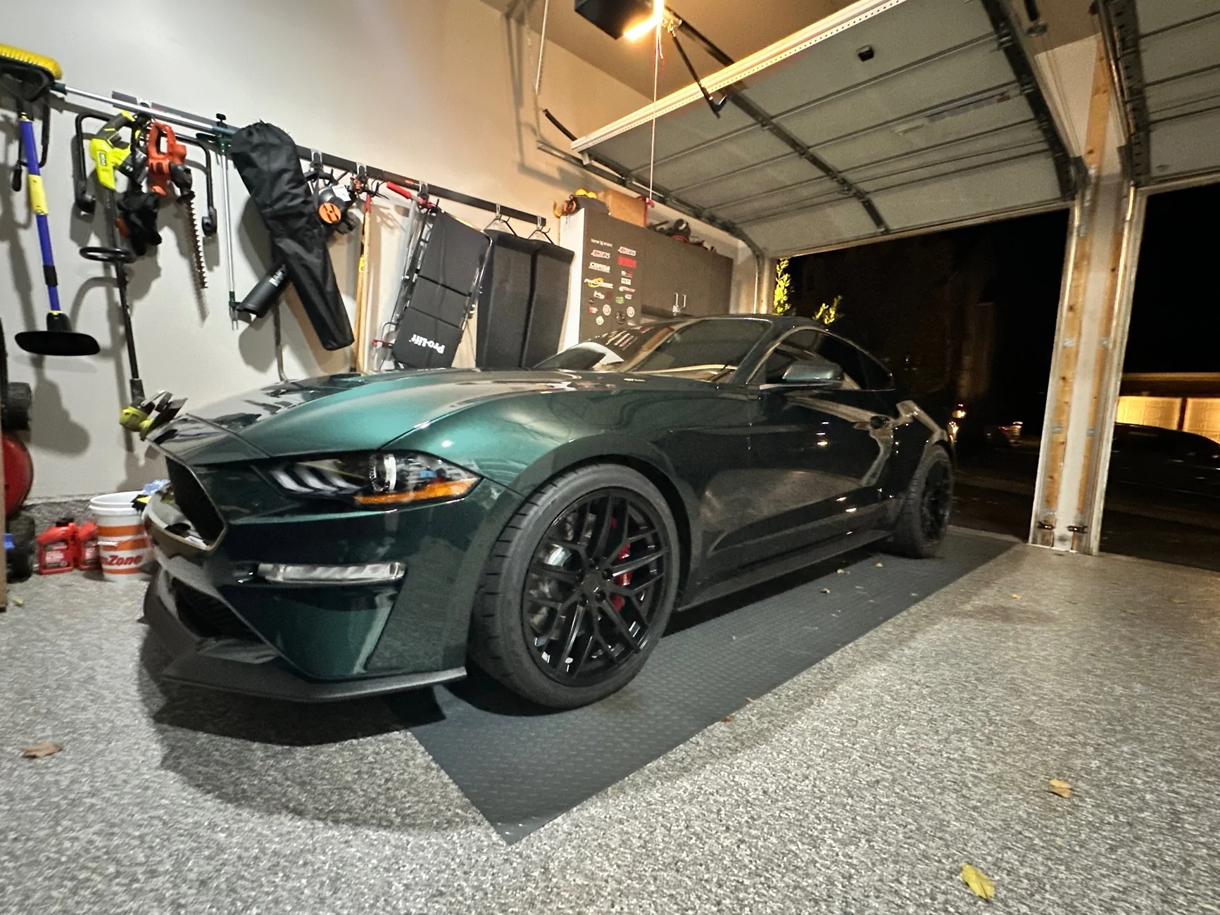

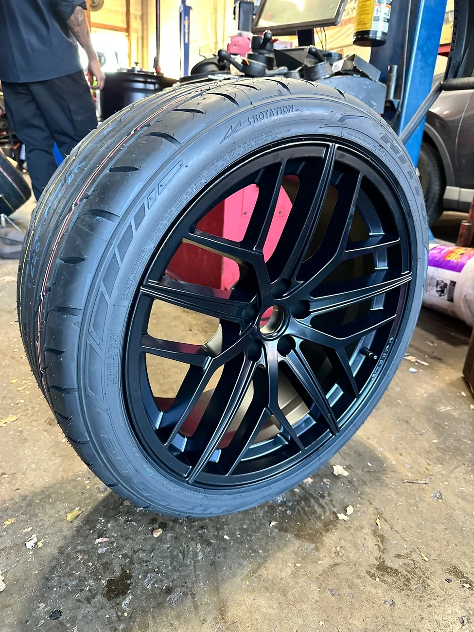

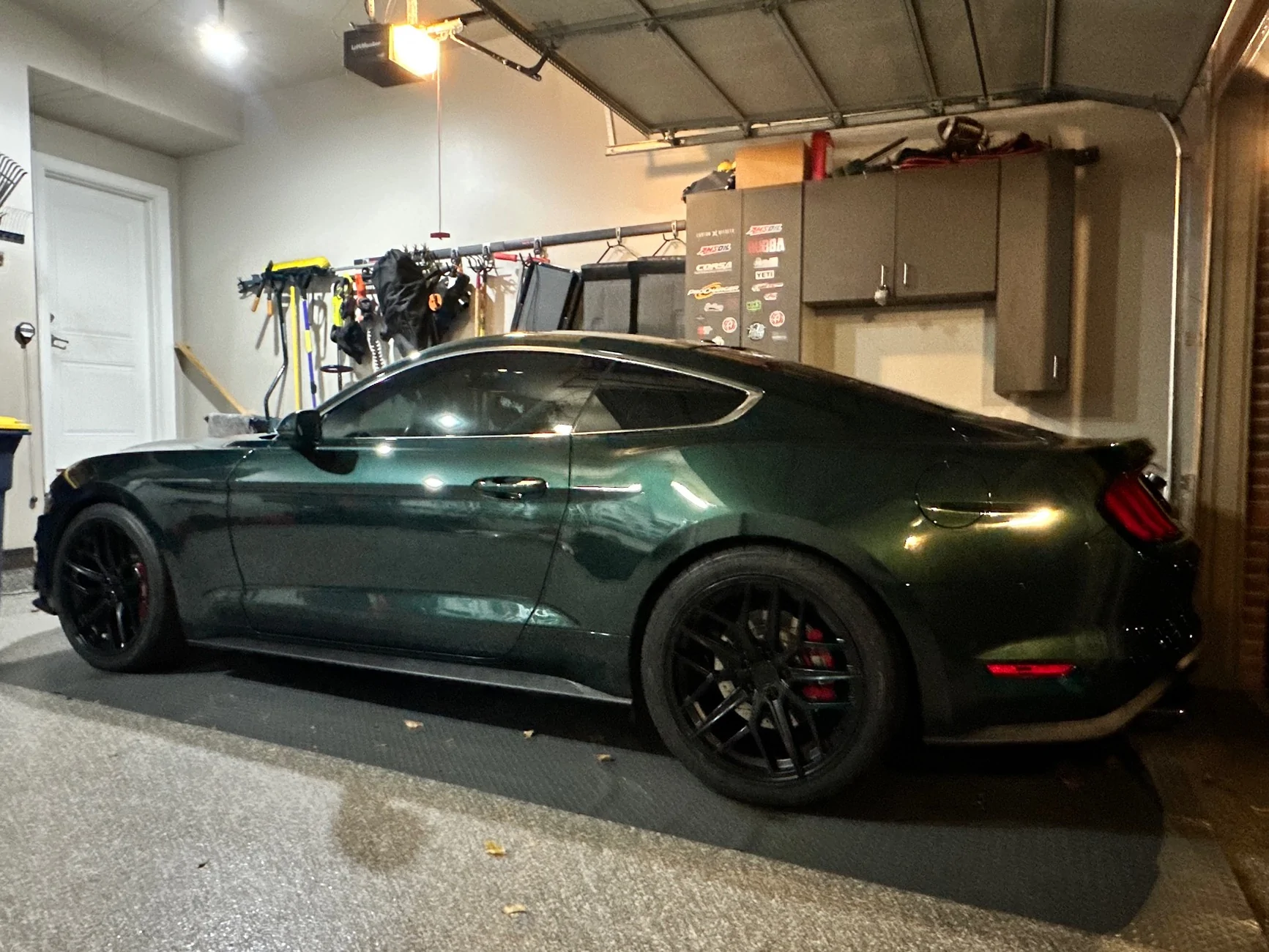

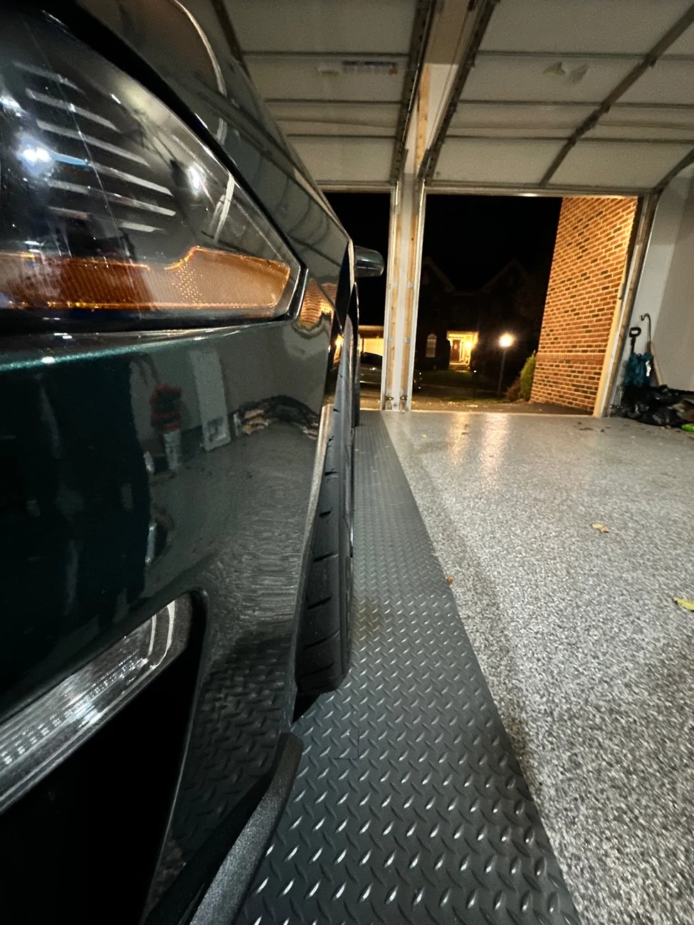

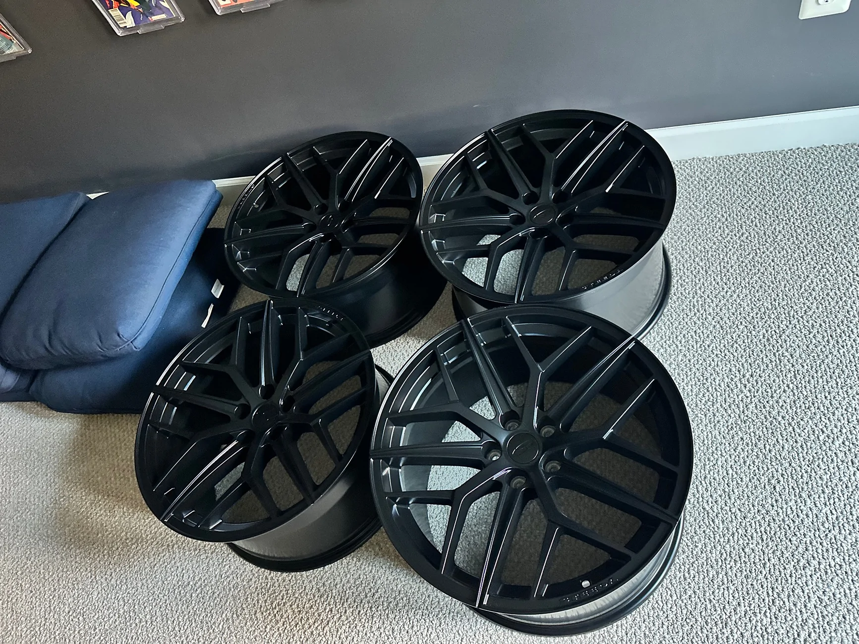

Man, I started this thread in 2022!!
Well, it's over now!
After over a year of your suggestions (which are greatly appreciated), I finally got bigger rims and tires. I worked with Sergio from Steeda (above), who helped me immensely!
They came in on Sunday. I went to a shop, had the tires mounted and balanced, then took them home and put them on. I'll get an alignment today. Please excuse the tires looking a little ashy.
Steeda Mustang Trident Satin Black Staggered Wheel Package - 20x10/11
NITTO NT555 G2
275/35ZR
305/35ZR
