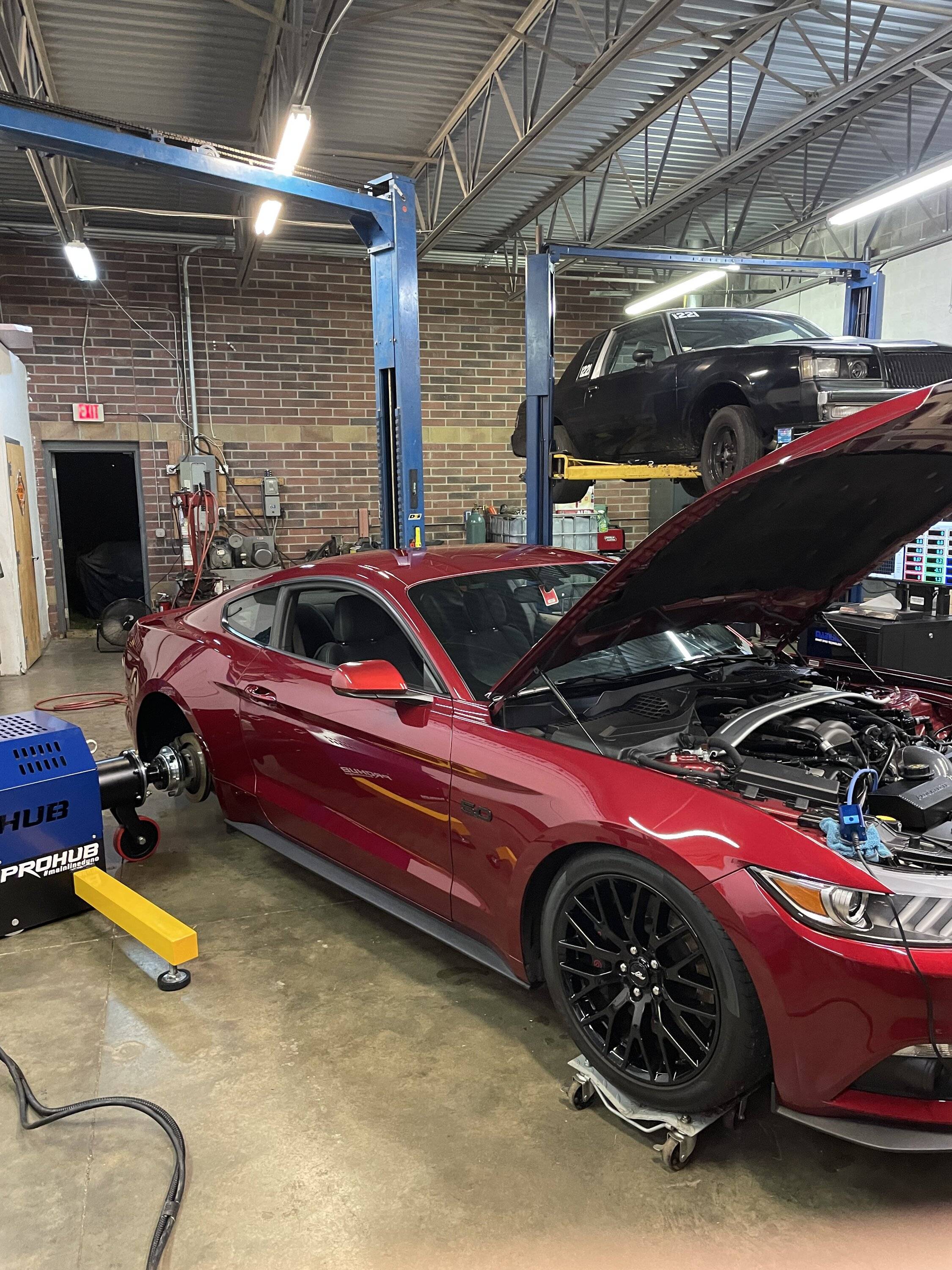

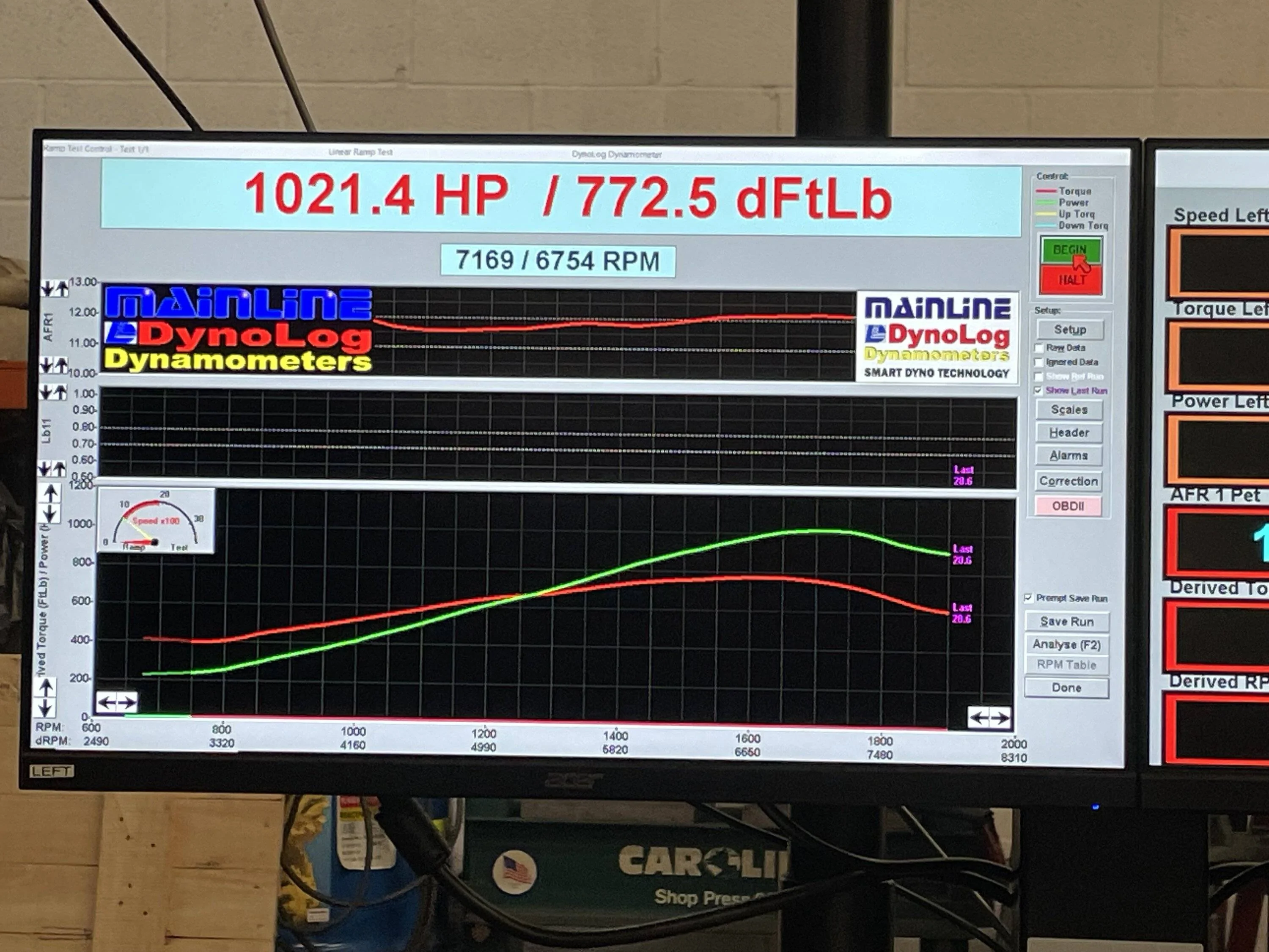

Wow. What is your mod list? Over spinning the blower?
Forged rods and pistons
Fore fuel system running E85
3.7 pulley probably spinning around 67,000.
This dyno run lost a couple pounds of boost because the belt slipped. Was tired of beating on the car that day so called it good.

solid ass power.

Damn yall are stuck on that over spinning stuff LOL
I know, it’s a habit. Like if it wasn’t a worry why would Procharger cap it so low… 🤷🏼‍♂️ ideally, for me, it’s more to gather data. The fact he made that power by barely going over with having virtually no other mods is very impressive.
But how far can you go? I imagine they set an rpm for various reasons - internal bearing limits, impeller wheel load in reference to rpm (its billet so there’s no alloy flex), to excess amount of heat - again we can’t dismiss the laws of physics… compressed air generates heat, but after 65k does it heat up like crazy?
But, again, you’re right. I’m used to hearing about all the horror stories of Paxton 2200SL failing because of it. :/

Just bought a 3.625 griptec pulley. Hope to help belt slip and what’s another 1000rpm blower spin 😁🤣
Sweet. Get it! Haha

Once the weather turns I’ll see if the car will hit 1050 if it stays together. Let me know what other information you’d guys be interested in. I tune the car and own the dyno.
