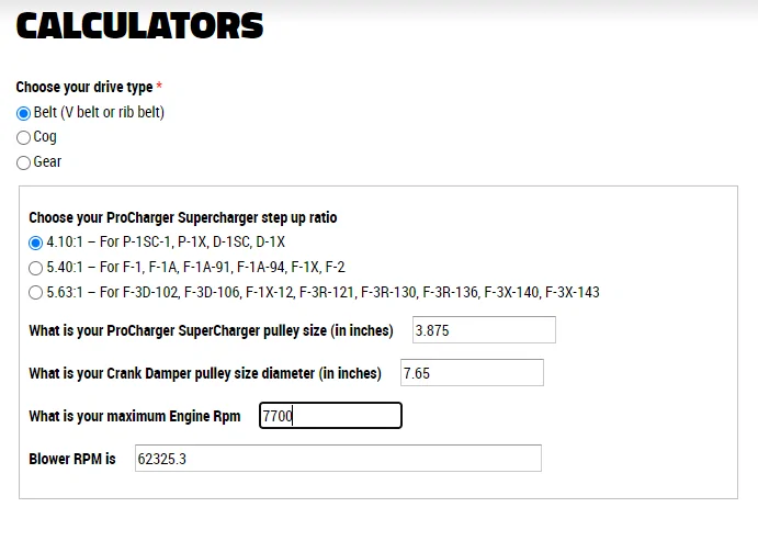

I am running a similar system; however, running a D1X. If you run a 3.875 pulley, you would max the charger at 7700 rpm. I would pulley accordingly based on your use of the car.

Only one problem. The p1x doesn’t max out at 62,000

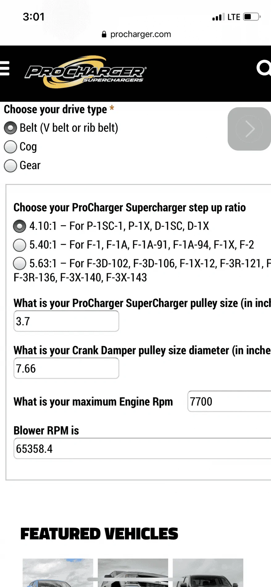

Thank you Jackson 1320. Your correct. The blower doesn't max out at 62k. Contacted procharger directly yesterday, and they claim that the smallest pulley available for my application is 3.5. Curious what numbers that would make if I can ensure no belt slippage.
1000whp+

Yes, I was thinking 62k from the D1x that’s I’ve been in the middle of installing/tuning. Procharger ran their orange pumpkin car on a p1x to 900+ for a tuning session. There is a YouTube video with the detail.
