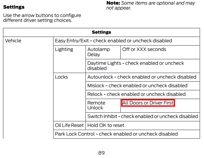

Maybe you guys can answer a question for me:
I could swear that up until a few weeks ago, if I touched the drivers door, it would lock and unlock both sides.
Right now, if I touch the door, it locks both. If I unlock, it does drivers side only. I have to either use the remote or hit the unlock button inside to unlock the passenger side. If I touch the unlock button on the pass side, it unlocks (not sure if D-side unlocks)
Does yours unlock both with 1 touch on the drivers side?
For the unlock, it's a setting you can change. I have mine set to unlock just the driver's door. From your steering wheel -> Settings -> Vehicle -> Locks -> Remote Unlock -> All Doors
Page 89 of manual
this question was answered in the post above. i have it set to open both doors the first time too. but if you have it set to driver's door first, u just have to tap the inside door handle a second time to unlock the passenger door, no need to use the switch on the inside.
unless that's not how the fords work, but this is how the toyotas/nissans work.
