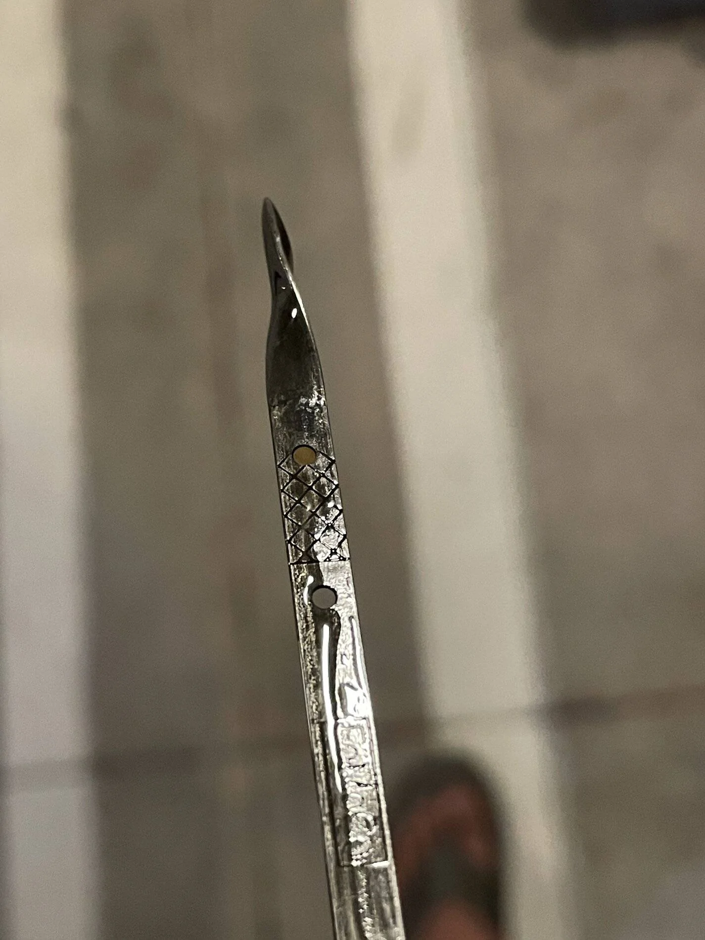

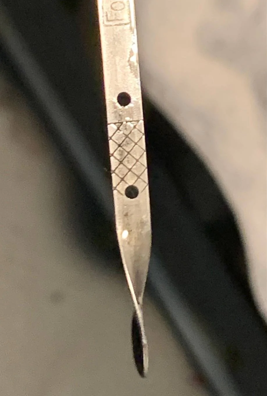

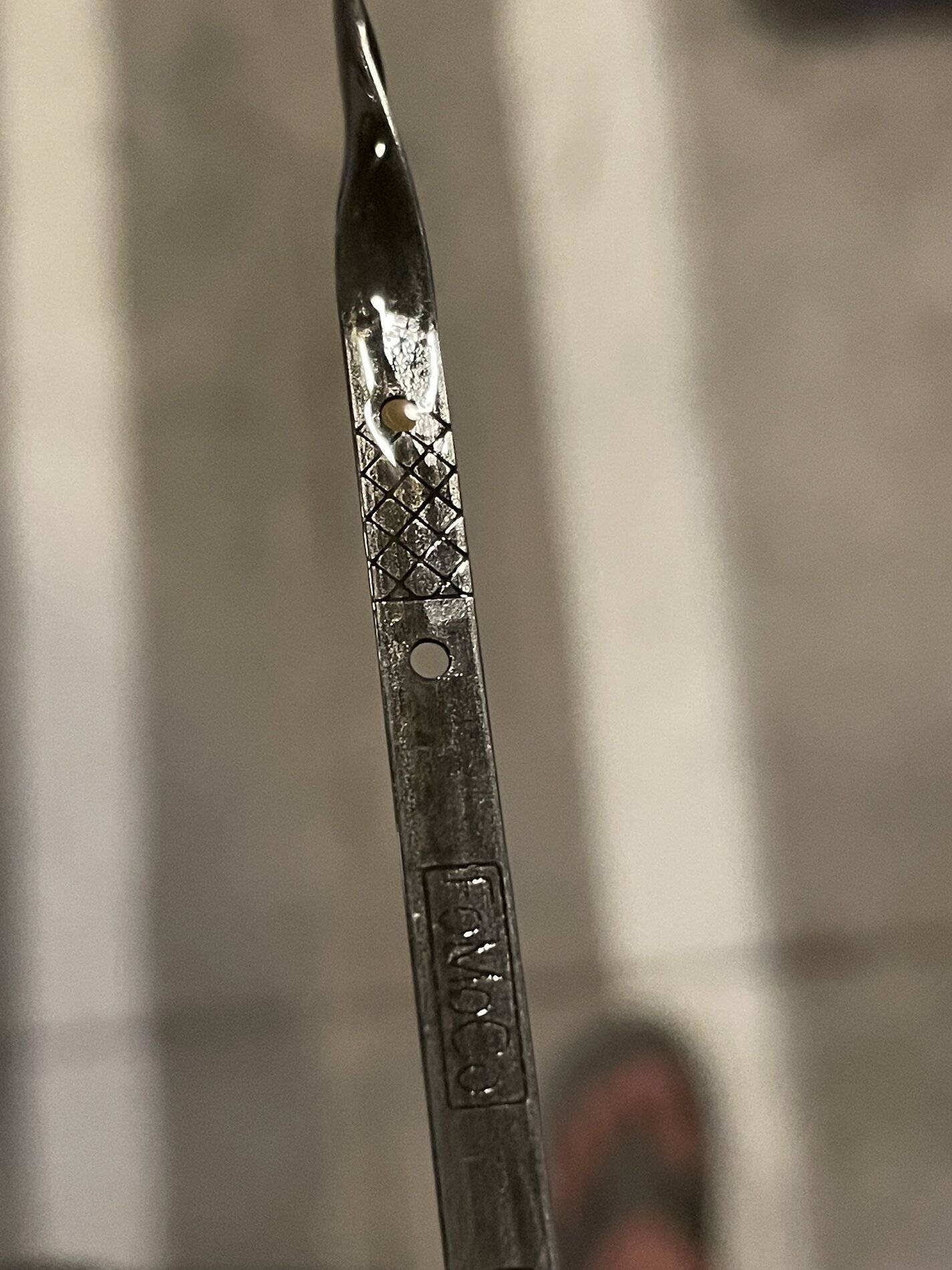

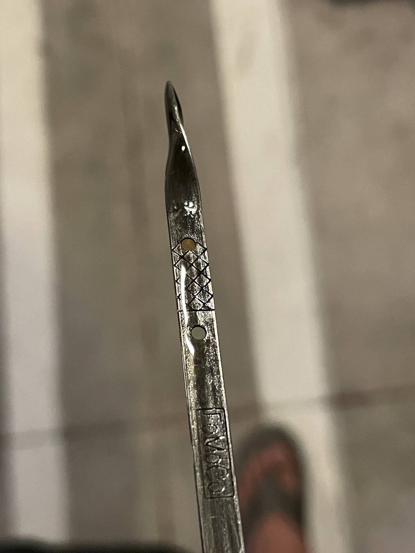

Hey Folks!
Had a quick question about the GT350's oil dipstick. Due to the way oil sticks to the dipstick I've always had a hard time reading the amount of oil in the engine, but I seem to be having a particularly hard time now.
If you see the attached pictures, oil seems to be clinging onto one edge of the dipstick and not on the other. How can I find out the oil level like this? Am I doing something wrong? I pull out the dipstick, wipe it, put it back and then pull it out to check the reading.
Any suggestions or recommendations would be really helpful.
Thanks in advance 😊
Pat

I get that, but the issue is that the oil is smeared in a way that the level is different on either edge of the dipstick. If you see the first picture, the oil goes way above the top hole of the stick on one side, and below the bottom hole on the other.

Can you take a pic with deep stick holding down instead of up. When did you take the measurement? The manual said at least 15 min after parking the car. I have no problem reading my oil.

Not sure why your stick is so dark. I pull the stick from the windshield side of the cross support bar. You have to sneak your hand down in there, but it helps to get a clean pull.

Looks like there's oil all over it. Wipe it off, stick it back in the hole until it's fully seated, pull it back out and check it again. My advice is to check it when the car is completely cold and all the oil has settled.

Kinda confused. I can't tell if you are reading it wrong then? I don't know if you have it like that for a picture or because that is how you are reading it. I feel like your are tilting it up which is messing it up.
Like you are supposed to read it as if the spiral is the down position. so as long as there's oil filling up that last hole you'll be good.
Its hard to do it when the engine is hot but I'd check it while it's cold.

The oil will coat the tube as the stick is pulled out. The more the stick is pulled out and replace, the wetter the inside of the tube, the result oil level hard to read.
Reading the oil level is hard when new cause it is clear. Using a sharpie, blacken the grid, clean the dip stick first, lacquer thinner or acetone. A black surface will show a liquid better than a bright surface that reflects.

Exactly what Rapid said, each time you pull it out it's going to coat the tube just a little which results to an inaccurate read. Even that little amount on the tube can be a pain. My suggestion is what rapid said earlier... just come back the following morning and clean it, stick it in, and pop it out slightly but WAIT. Reach from the back of the strut bar and pull it out so that it comes out neater. it works for me... don't ask. obviously hold the dip stick's bottom aimed towards the ground so the oil doesn't flow the other direction causing another incorrect read.
from the picture, it looks like your holding it horizontally so that's fine too.

I was having this problem and cleaned the dipstick with parts cleanser before re-inserting it and the oil seems to cling to it better and in a more uniformed manner.

Yes if you check it in the morning all the oil that easily drains down will be in the pan. This helps you get a better reading and there is less variation. If you check it shortly after running the engine, oil is still splashed everywhere, still up in the valvetrain, etc.
For seeing where the oil is, I just use indirect light and tip the dipstick until the reflection is in the right spot to make the oil level easier to see. You want a strong light but you don't want it shining directly on the dipstick.
