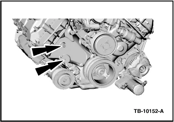

If I knew my engine front cover had placeholders for ac tensioner pulley, I'd already tried it.
Grab a flashlight and go take a look at the front cover. If the front cover has threaded holes in the two locations shown by the arrows in the figure below, then the kit should bolt right up.
already did. my '17 has it. ordered the tensioner.
