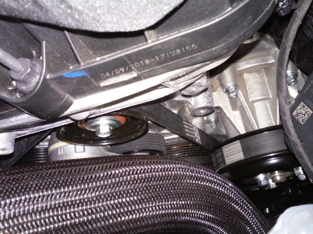

Well, it took a whopping hour to install. So, first I'll write down the basic steps I used to install it.
1. Remove engine cover. Two 10mm nuts on the front under little covers you can pop off with a screwdriver. Then, the rear of the engine cover just pops off.
2. Remove Air Intake by unclipping from the filter box, unclip and remove the two vacuum hoses and sound tube. Just set them aside. Fully loosen the big hose clamp on the throttle body, and pop off the intake. Set the intake aside gently, so you won't need to unplug the MAF sensor.
3. loosen both 10mm bolts holding the coolant expansion tank in place, and gently set it forward on top of the radiator. You really don't need to disconnect the little overflow hoses if you're careful.
4. Remove the main serpentine belt.
5. Remove A/C stretchy belt. I just used a box cutter.
6. Install the tension arm first, using the position hole that puts the arm in the lower position. The upper position will not work, as the belt is not that long. I recommend you loop the belt over the top of the tensioner as you install it, because it is almost impossible to route the belt behind the pulley when the tensioner is fully tightened.
7. Install the upper idler pulley.
Note: I believe both are torqued to 18ft-lbs per the TSB.
8. Install the belt per the diagram in TSB 12-8-14.
9. Reinstall the main serpentine.
10. Reinstall the coolant expansion tank.
11. Reinstall the Air Intake.
12. Reinstall the engine cover.
Ok...Done!!!
So, what are my results?
Well, the results were immediate. I warmed up the car, and did not notice any idling tick while warming up. One would think not much would happen just from adding a belt tensioner, but...the whole tone of the engine at idle changed. ALL idling tick is GONE!!!
As I went for a quick 20 minute drive, I noticed virtually ALL of the "rattle" I was getting around 2,000rpm is seriously subdued by about 80-90%. It still seems to be slightly there, but it's actually much harder to hear now.
Now, as for the tick while blip revving in neutral...GONE!!! It might still be there, but I honestly can't hear anything that wouldn't be considered normal. My ears are good, but not THAT good! It's virtually negligible.
I honestly wish I had done this the moment I bought the car. Maybe it would have prevented a lot of the ticking issue to begin with. I have not found any metal in my filters, or in the oil pan yet. So, I'm hoping/praying there's no damage to the engine. I may talk to the dealer to see if they can at least bore scope the cylinders, just in case.
But aside of all that, it does sound so much better.
