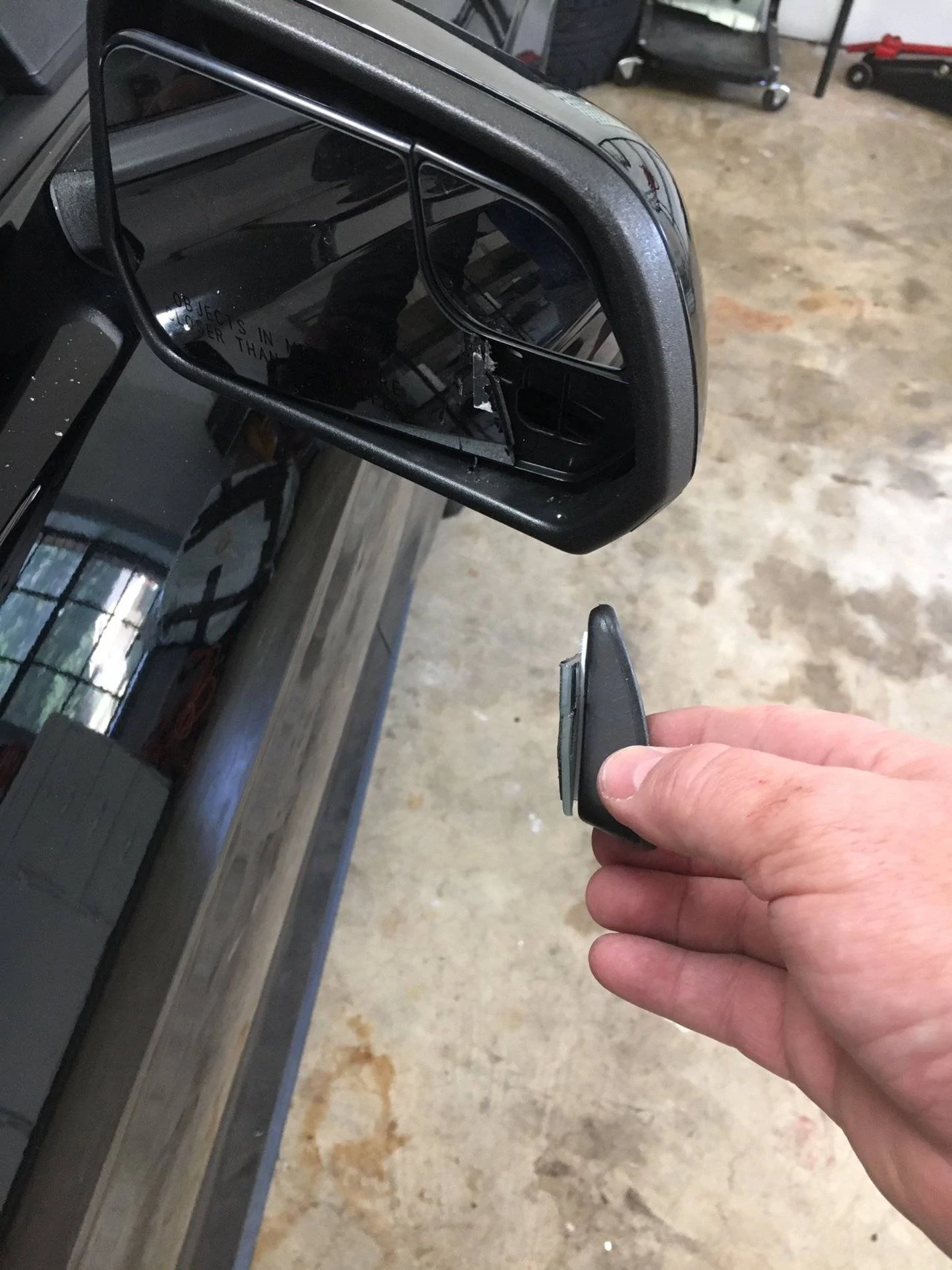

I broke just the mirror on the passenger side mirror. Any idea how much this will cost and is it a DIY job?

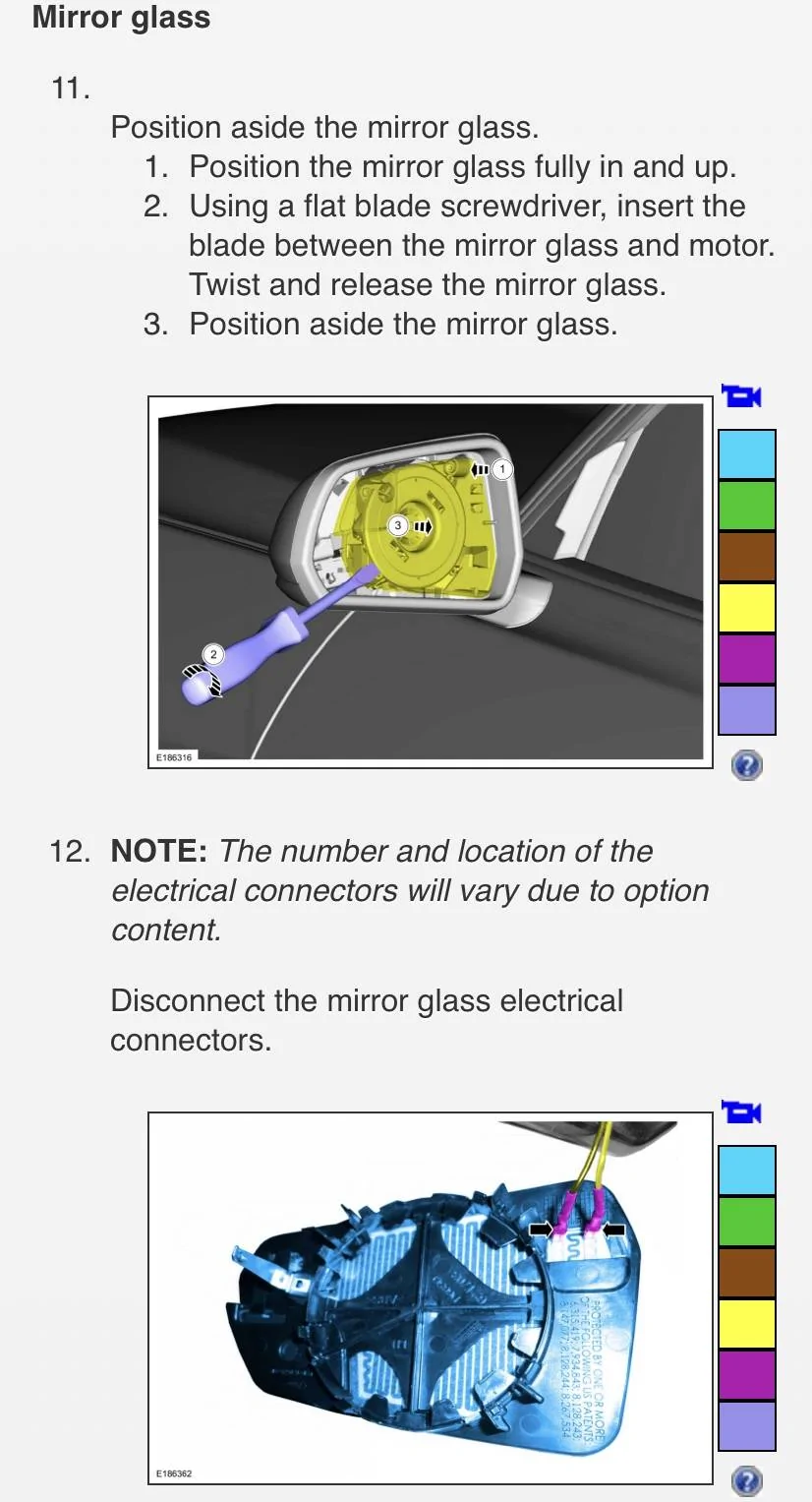

The glass part # will be different due to having the smaller mirror in that housing.
Here’s the directions for replacing the mirror glass:

The spotter mirrors are standard is you do not have Blis. It is not hard at all to remove the mirror just be careful to not break the clips that hold it on and watch out for the heated mirror wires if equipped.
Thank you!

The blind spot mirror in my hand is from Auto Zone. I put it on wrong and when I tried to pull it off the mirror broke. I blame 3M for their excellent tape.
