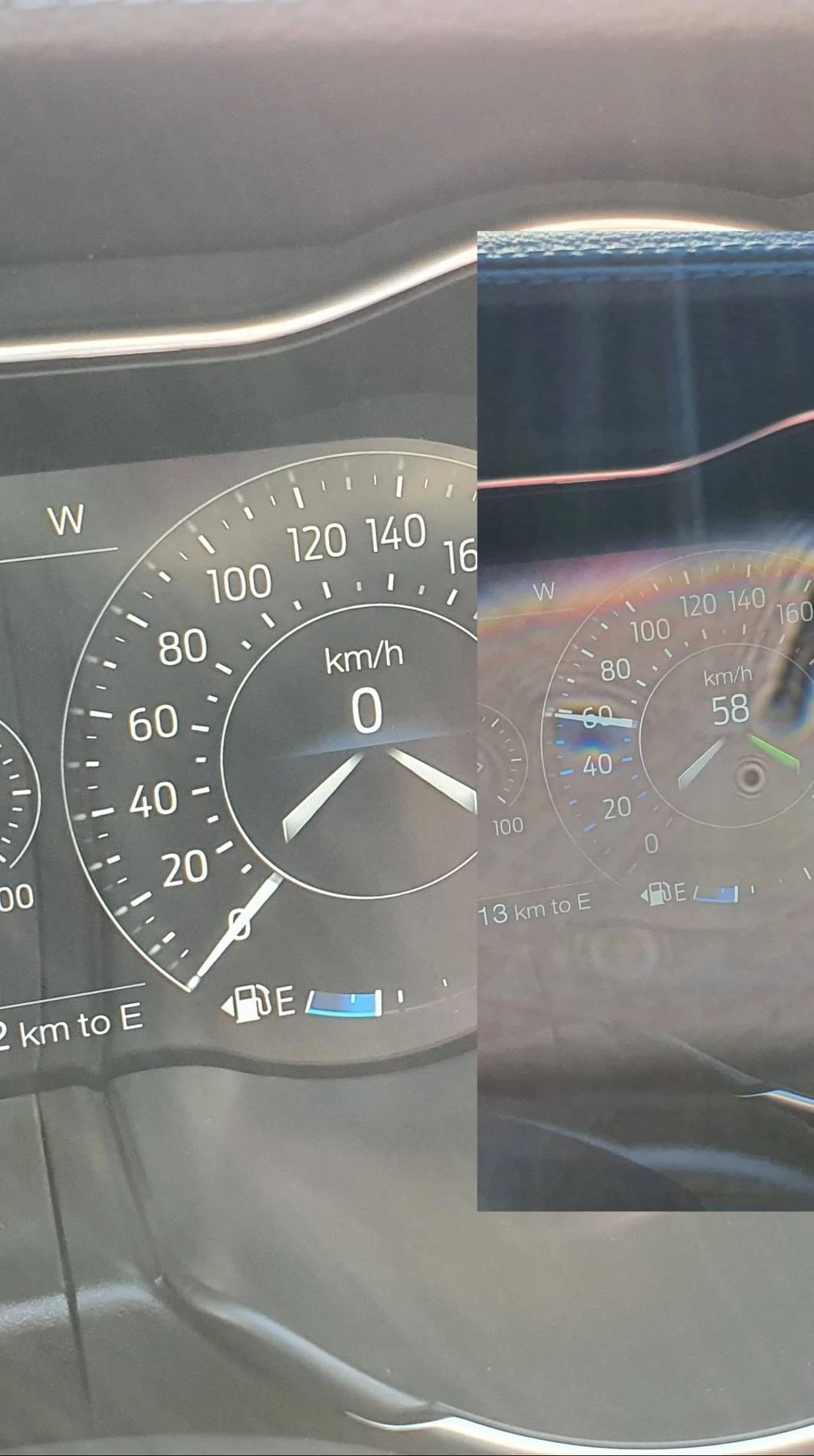

Have gone through the manual
Cannot for the life of me work out what these two lines mean,
I thought it might have been a clock but it hasn't changed
It also has changed colour too
Can anyone tell me please

Lane assist, green line means the camera sees the side lane markings and the car is centered, red means you are out of the lane, white is the camera doesn't see the lane markings. Lane assist shuts off if you are going slow, cant remember what the speed it turns back on

That's the stupid lane assist. Designed for morons who write text messages or apply make-up while driving, instead of watching where they're going.
Luckily, it can be turned off. Press the little button at the tip of the turn signal stalk.

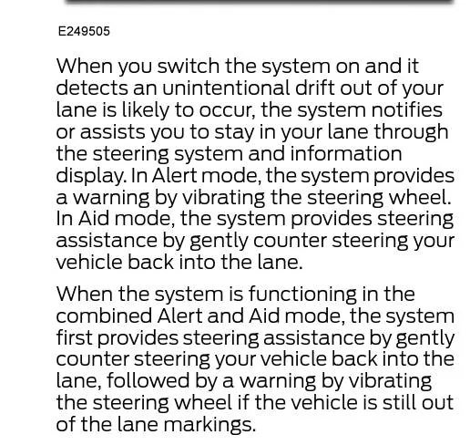

Look in your owners manual under “driving aids”. Fully explained there.
great, managed to find it, I went through every page of the manul looking for the lane pics but missed it
its a very nice feature, not too sure useful it is in practical use,
also it explained why my steering wheel would shake a bit when driving on a slightly turning road,
