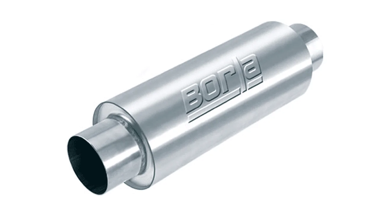

Basically glass packs, but get quality ones that use stainless steel packing.
This, or they are commonly sold as resonators. Takes a lot of the rasp out while leaving the nice, low rumbles.

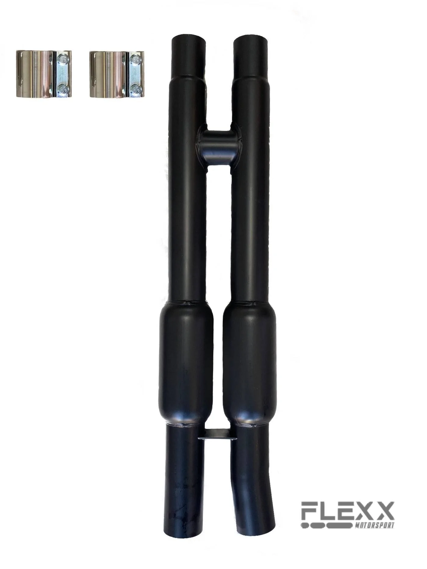

Something like this instead of the x pipe, could take the edge off a little. It’s a H pipe with “hotdogs”.
Thinking about getting this unit with my AE system. Apparently it’s less raspy than normal h or x pipes.

Look at vibrant products. They have some killer resonators. Maybe put some cats back and a set of resonators. The hardest part is going to be finding one short enough to fit in some of the small straights in the tubing.
