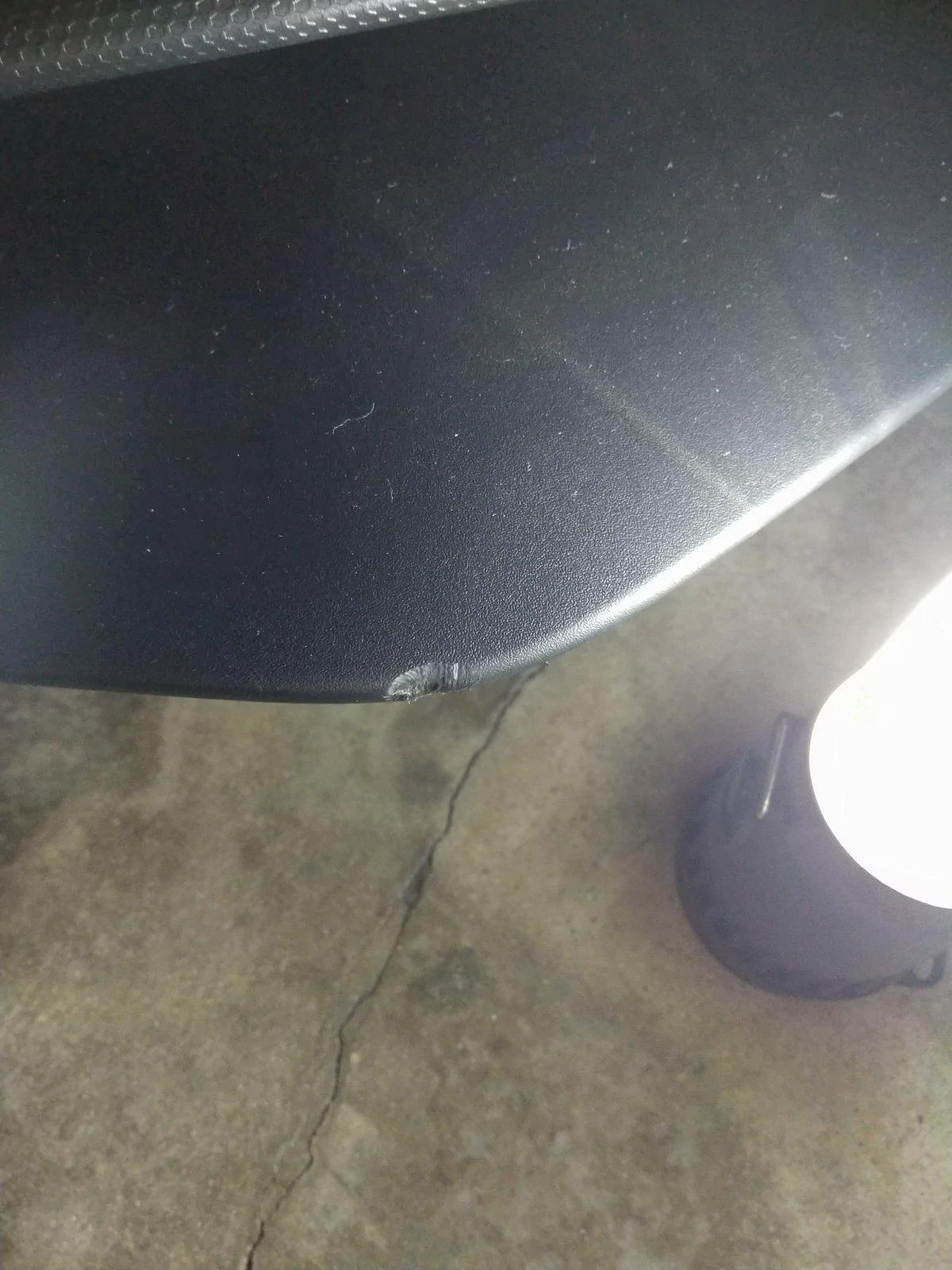

it's a pain. my brand new R, a few drives around town, bumped a parking block at my local Lowe's already (see pic). and yeah the underneath of the splitter is scraped up just on my driveway. but oh well.

I bought about a dozen of those hard plastic surface, self-adhesive furniture sliders from Lowes, painted them black and stuck them to the underside of my front splitter. Even stuck a couple under the rear bumper pan for good measure. They take the brunt of any light scrapes and bumps. Have sacrificed one to a harder scrape but easy to replace. Don't want to subject the splitter to a hard bottoming though as it can bust things up in the bumper and splitter pieces in the bumper.
