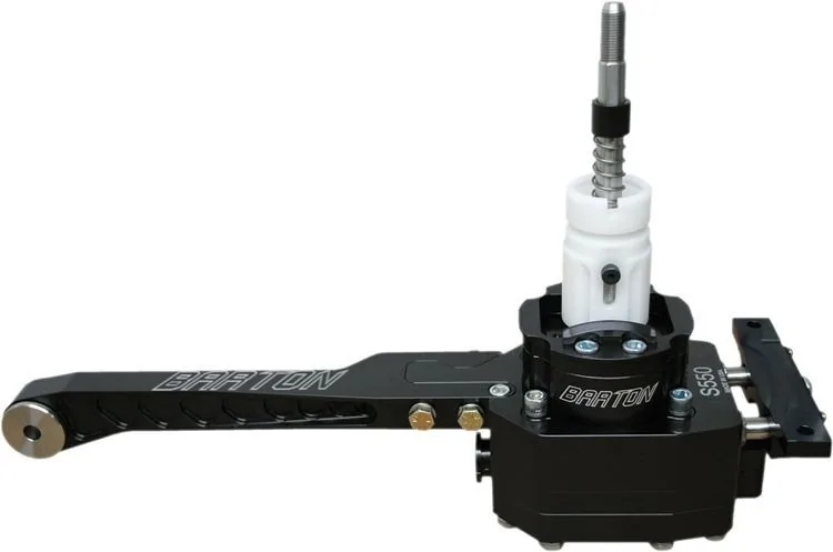

I ordered a Barton last night. I'll post up my honest opinion once I get it installed.

I finally got around to installing the Barton shifter. So far, I like it. Shifter is a lot stiffer to move than stock. There's very little play side to side. It also seems like it's impossible to miss a gear and in the 50 miles I've driven so far, no lockouts. My only complaint is that the pin removal tool they provide only causes headaches. The screw that pushes out the pin snapped which left me no choice but to cut the stock shaft in half with a sawzall. Oh and use a Barton lockout collar. Steeda won't fit. Not sure if this info helped you but it may help someone else decide on a shifter.

I also have the Barton and have no regrets! I did get to drive with the MGW on a friends ride and while it is a bad ass shifter, I felt as though the shifter was too short for my tastes. The throws on the MGW are really short gear to gear (flick of the wrist).
The barton is very nice, but very stiff new. Reading past reviews, it should lighten up with use. You do have to deliberately direct the shifter into gears 1,2,5,6. If you don't you will push/pull it into the shifter gate. This has to do with how stiff it is (which is user adjustable). You can also replace the shifter length by replacing the entire center cartridge (20%&15% optional reduction).
The install was a 5/10 to me in toughness scale. Over-all I am happy with the shifter. Mine DID NOT come with a Barton shift knob. The only hitch during install, was breaking the tool which removes the factory lockout collar roll pin. It was an easy fix with a hacksaw (cut the protruding portion of the pin). As far as I can tell, I don't believe Barton even sells their own brand of shift knobs.
I have zero experience with Steeda's Tri-Axe, so I can't comment on it. All three companies have a strong presence on this forum and so far, I can tell you that Barton has good customer service. Lethal Performance had a hell of a deal on the Barton Shifter.

I just bought a Barton from the classifieds here. Looked at both carefully for the past two years at Mustang Week. Barton won out because I like the trashy reverse lock out. I just ordered the billit replacement this morning.
I'll be able to install it in a couple of weeks. But I am planning on removing the springs all together. I want the stock feel.
