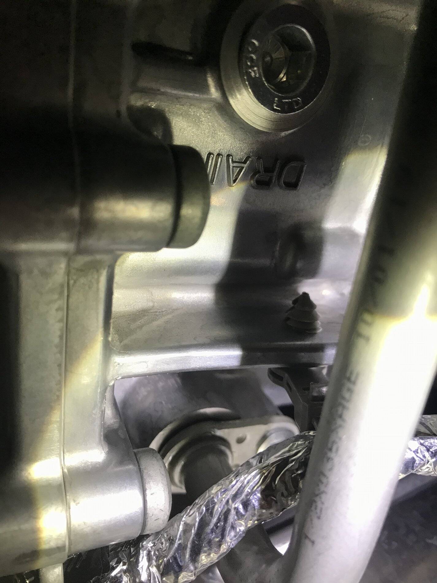

So I have 1800 miles and my return line for my tranny was leaking enough to puddle and leaked while It was running. Didn’t lose anywhere near the fluid Big John did. Been to my local dealer and replaced the set of seals, one is plastic and the other is rubber. Still leaked. It looks like the line was bent or enough pressure was applied somewhere in the line and It won’t line up correctly to seat. So we bent the tab where the bolt attaches and I get one drip per night. Ordered a new line and as soon as It arrives back to the dealer. At least this time I won’t have to have it put up on flatbed.

I saw that. Both of our issues are something someone did during production. Sucks for both of us. I’m hoping my line is the problem. If It leaks after replacing, last is the tranny! My line was fine for 2 months. Then one day I noticed a few miles from my house It burning on my exhaust. Looked under and it was leaking enough to puddle in a couple of minutes. Drove home and waited until I went down and talked to my dealer. We ordered the seals hoping that was it.

From looking at the picture of the stripped threads and the blue loctite on the mating surface, I'd guess the guy assembling this overtightened and stripped the threads. So he probably put loctite on the surface and snugged the bolt, hoping the loctite would hold it.
I fully agree with this analogy. Who knows how many more were delivered with the same loctite bandaid. The use of pneumatic tools to install a steel fastener into aluminum is recipe for disaster. Especially like this when you are collapsing an o ring seal offset to fastener.

Ok guys, I got great news to report today. The service manager called me and said they are going to do a complete transmission swap.
They are replacing the transmission in part because of “the lack of parts availability, including the housing” and because of “the potential of unknown international damage.”
Transmission comes off back order on the 17th, so hopefully it will ship out fast. The front splitter is also being warranted due to a wrong size screw being used during PDI. It’s back ordered until mid December.
Looks like my driving season is over for the year, but the car is being fixed the correct way.
