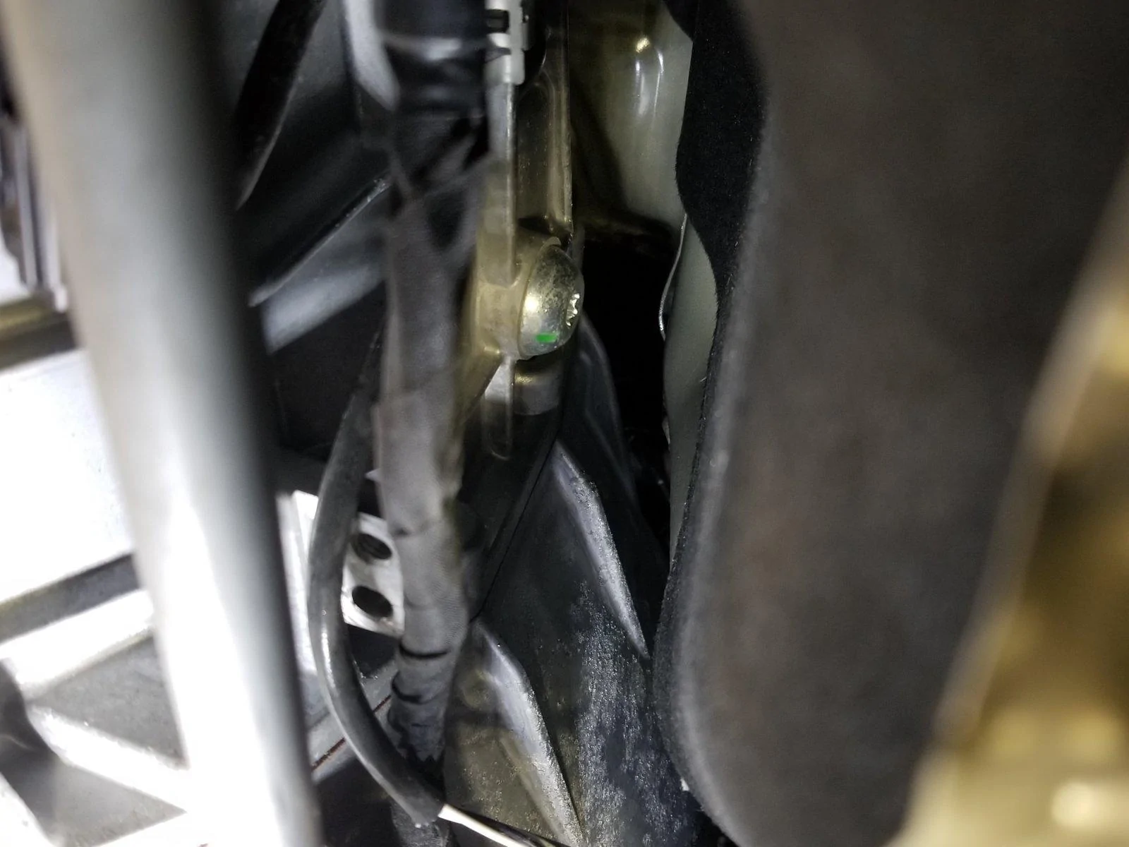

Hey guys, I am having trouble identifying the fill plug... I see a bulky shinny plug somewhere further up at passenger side, with a green marker on it, is that it ? Looks like an allen key of 8 or something?
PS. I am trying to do it now, running out of daylight soon, a quick reply is appreciated...

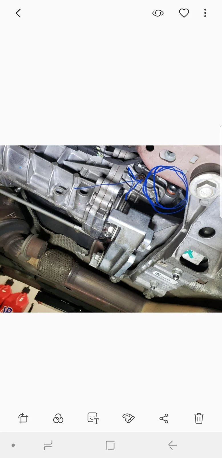

Here's a pic of it.

Many thanks! I knew it had to be similar to drain plug...
