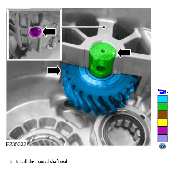

Does anyone know what the round head anti-tamper screw in the picture at the top of the arrow is for? Mine seems to be sleeping fluid and before I do anything to it I want to find out if anything internal will come loose, etc if it’s removed. TIA.
Those bolts typically hold in various pins. Not sure on that specific one, but it might be the reverse gear pin. Either way, it'll be a bad day if it comes loose.
