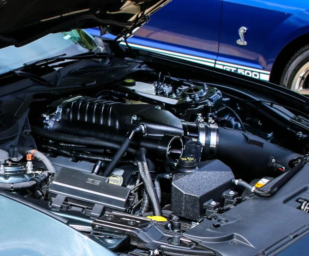

Was getting ready to set the new engine back in the car, and a deal kinda fell into my lap. 48 hours later, I was loaded up and on my way to trade my Gen3 Whipple kit, for a brand new Hellion Sleeper kit, Holley Sniper Fabricated Race Series intake manifold, with a Turbosmart e-Boost 2 boost controller.
The Whipple was a great setup, it will be missed.

I actually never put the Gen3/150mm throttle body on the dyno, but I did have it at the track though. I picked up a solid 4.5 mph in the 1/4 mile pullied the same(3.75 upper/20%lower), and almost 6mph going to the 3.625 upper/20% lower. It went 149.8@4150lbs. race weight.
EDIT: If I had to guess, I think it was in the 920-950 rwhp range with the 3.625 pulley
