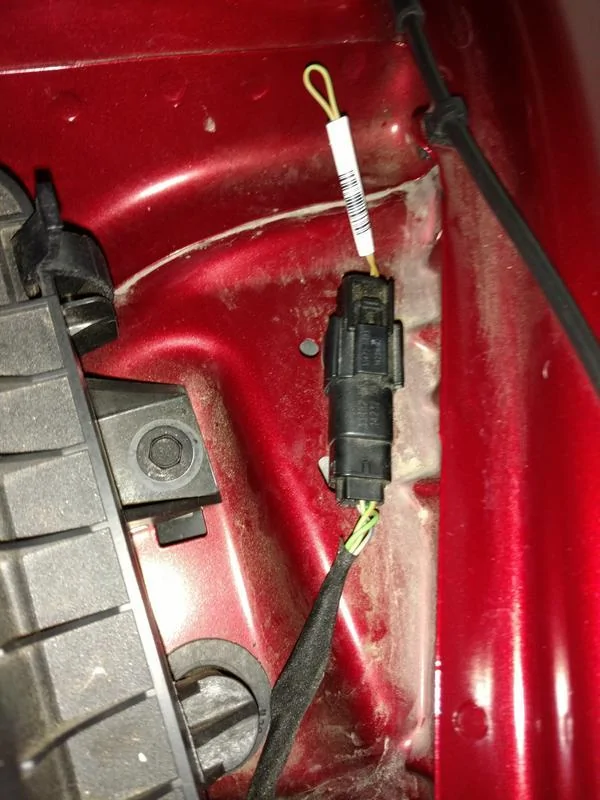

Are you guys pulling a fuse at the track to disable the traction control or torque managment? I launched hard and car bogged like there was still traction control, even when I held it up for 5 sec. 2015 manual car

Ok. I will try that first. Does the plug do the exact same thing as pullung the fuse? Or do you still have some features luke line lock with the plug out?

Thanks guys. Pulled tbat plug and can actually spin the tires now in thw burnout box. Dropped 2 tenths off my 60ft

+1 that that plug will disable everything. Always pull it when on the dyno too. Some have a plug that is taped up but in the same location and the other side of the plug doesnt go anywhere.
