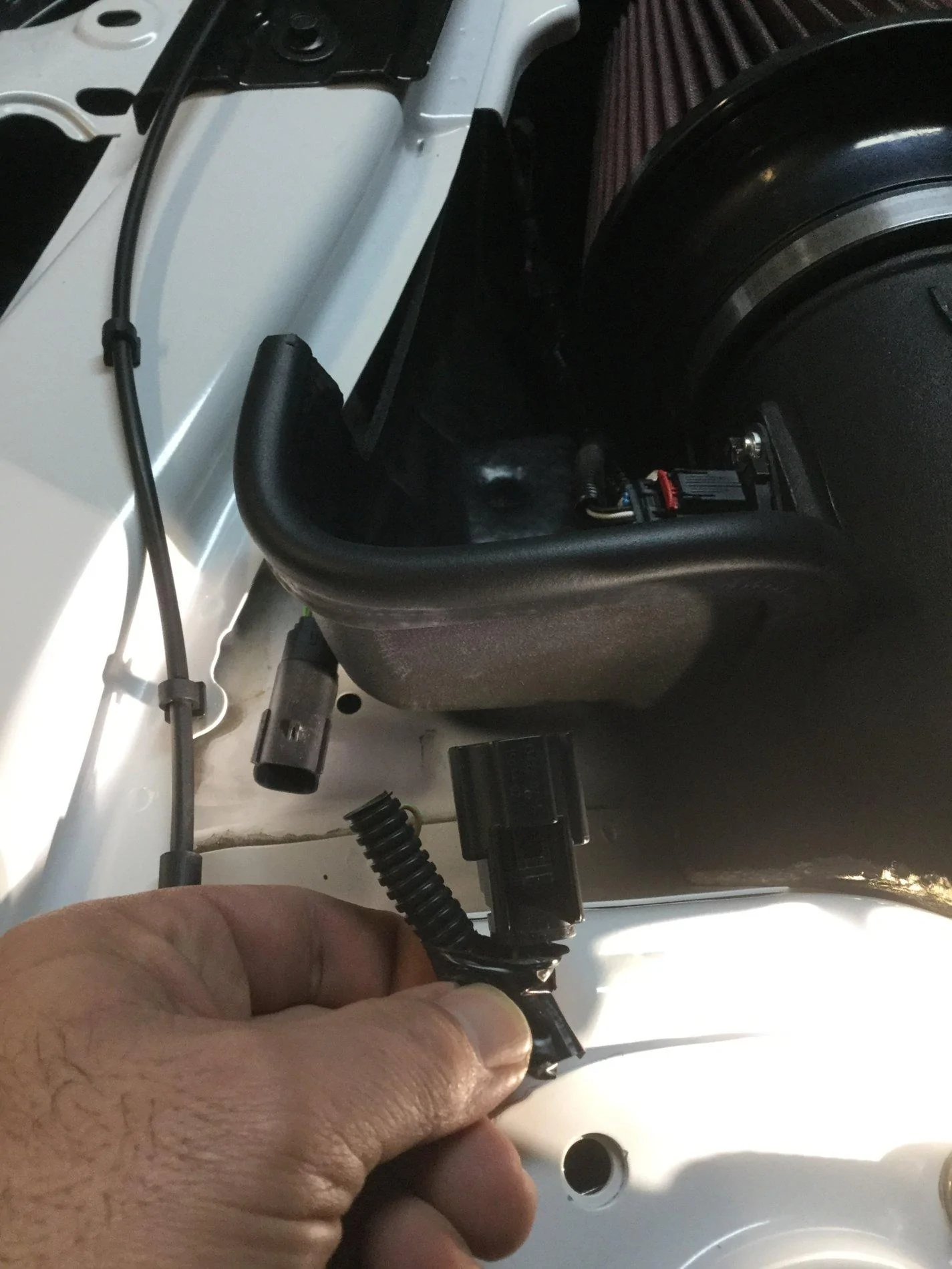

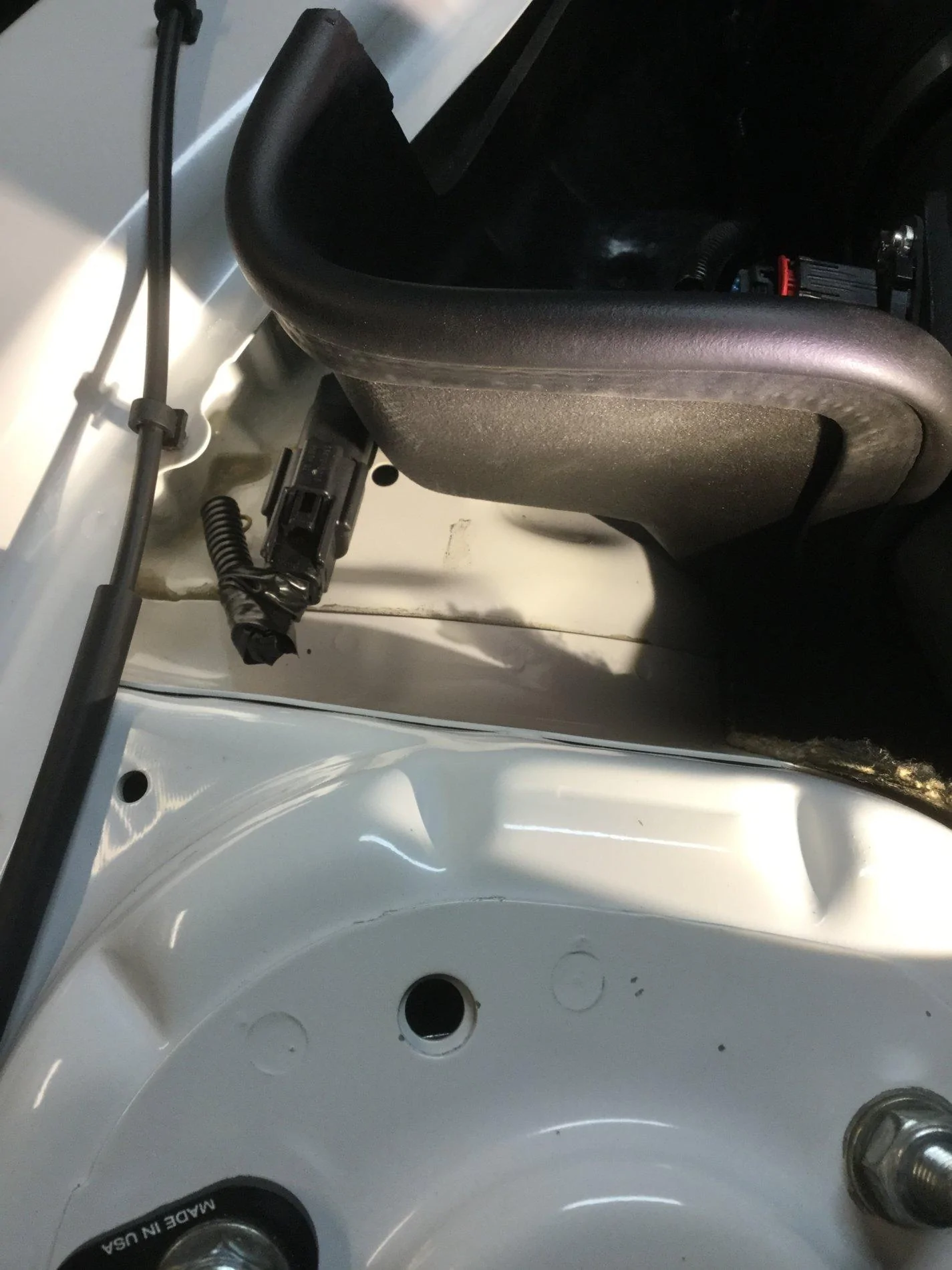

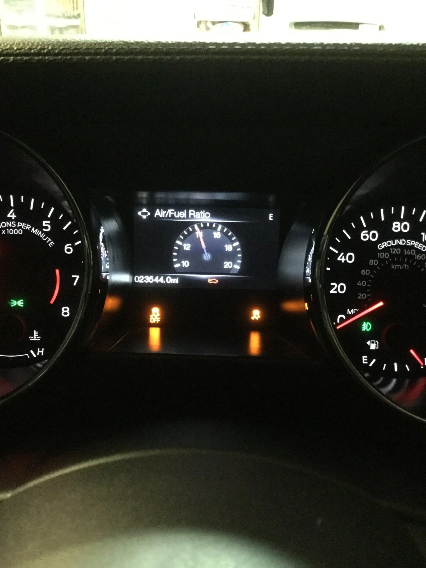

Unplug the connector under your hood right beside where the factory airbox was located. This will turn off the traction control and the stability control. If you only turn off the traction control in the car via the button on the console, it will still have the advance trac active and will engage your rear brakes during excessive wheelspin when doing a burnout or spinning on the street without you even applying the brakes. You will have a traction control light and stability control ligh on your dash while its unplugged. I leave mine unplugged all the time, but whenyou plug it back in, lights will go back out and you dont have to clear codes or reset anything. Here are pics, the first is with the plug connected. Second is what the plug looks like disconnected. And third is what youll see on your das. Hope that helps man!

I'm having a bit of stiffness trying to pull mine out, any help?
Timbuck
Mar 26, 2023
484
512
Australia
Tim
2017 s550 6r80
Lift the little tab , so it clears the little barb. Fine flat screwdriver will help.
Check first pics in thread.
