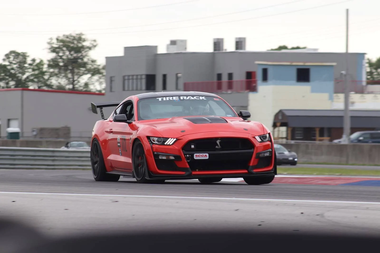

As I posted in the other thread, I run mostly Nankang crs To meet my clubs 200tw rules. They make 305 and 325 20’s. They also make a 100tw ar1 in a fat 305. Goodyear sc3r is also available in 305. 325 crs square fits on apex 20x11.5 et48 with longer studs and spacers up front. was 5th overall and 2nd in class at the scca time trial event at NCM with that setup a couple of weeks ago.

The nankangs are noticeably stickier than the SC3. They are in the range of the falken rt660, re71rs, yoko a052, but less than sc3r or R7. Mixing them might give you too much push. I ran 305/325 nankangs last summer and that worked really well for me. I'm trying to make the 325 square work now, but times have been basically the same as 305/325.
