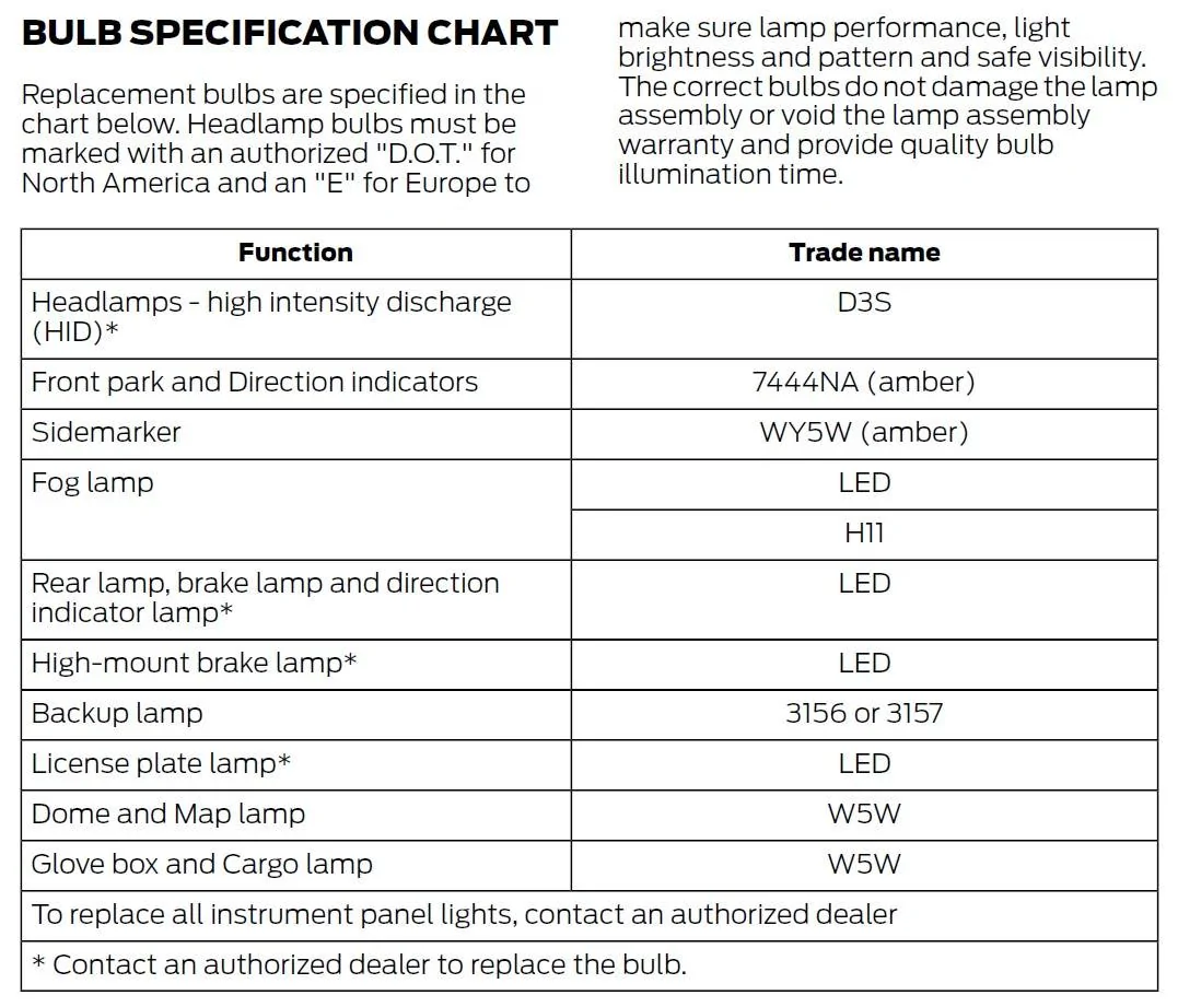

Earl,
Hate to be the bearer of bad news but this time your info is wrong for the Shelby. The turn signals on the gt500 are definitely NOT led, nor is the parking light marker lights. 100%.
This is from the 2017 Mustang Owners Manual
