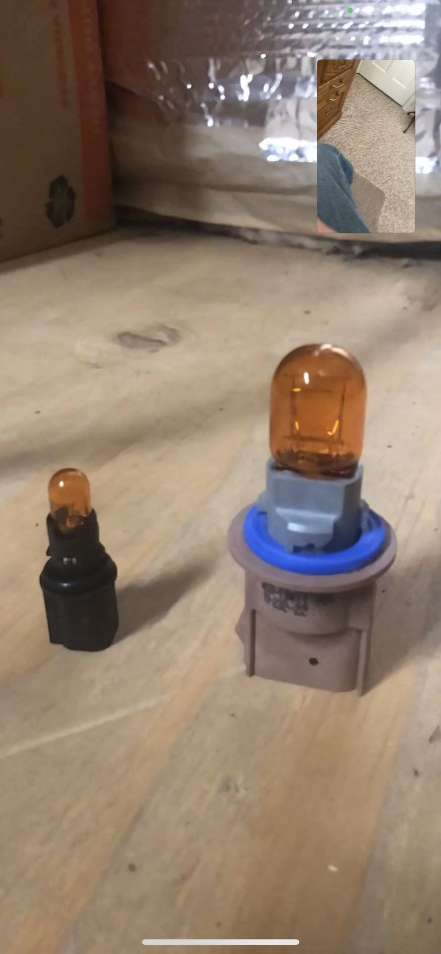

Ok, had my friend locate my stored parts. The number on the turn signal bulb is HT744NA. The number on the parking light is WY5W.

Jamie considering the picture above the Turn looks way too large to be a 194. The HT744NA closest match is 7443LL

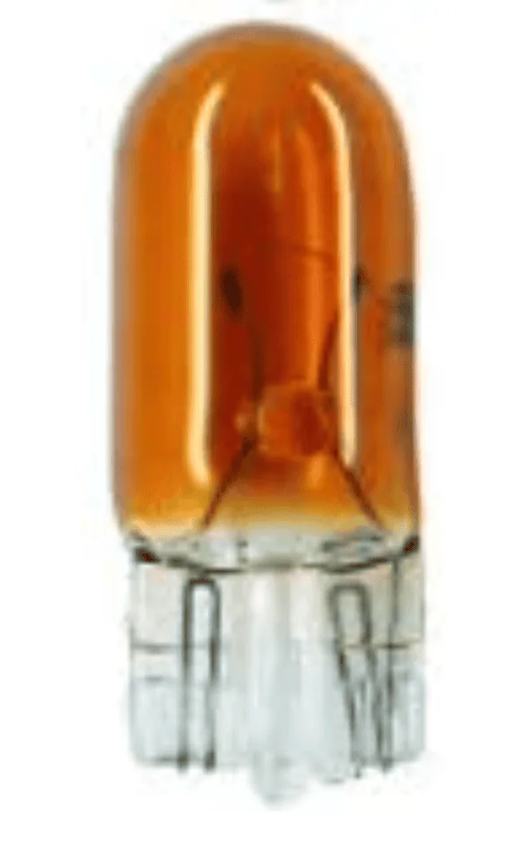

What I meant is the 194 is the marker light, and it is a separate bulb that plugs into the plastic 1/2 turn adaptor.
I think maybe the blinker might be the same style. As in it plugs into the plastic adaptor, like the 194.

My apologizes I misunderstood. Yes I the turn signal is the same type/style 100% I just cant find the alt except the 7443LL where the LL is long life what NA stands for I dont know but the Ford version also seems to be missing a number I think, which is making me think it might have been a mistype by @marklboris

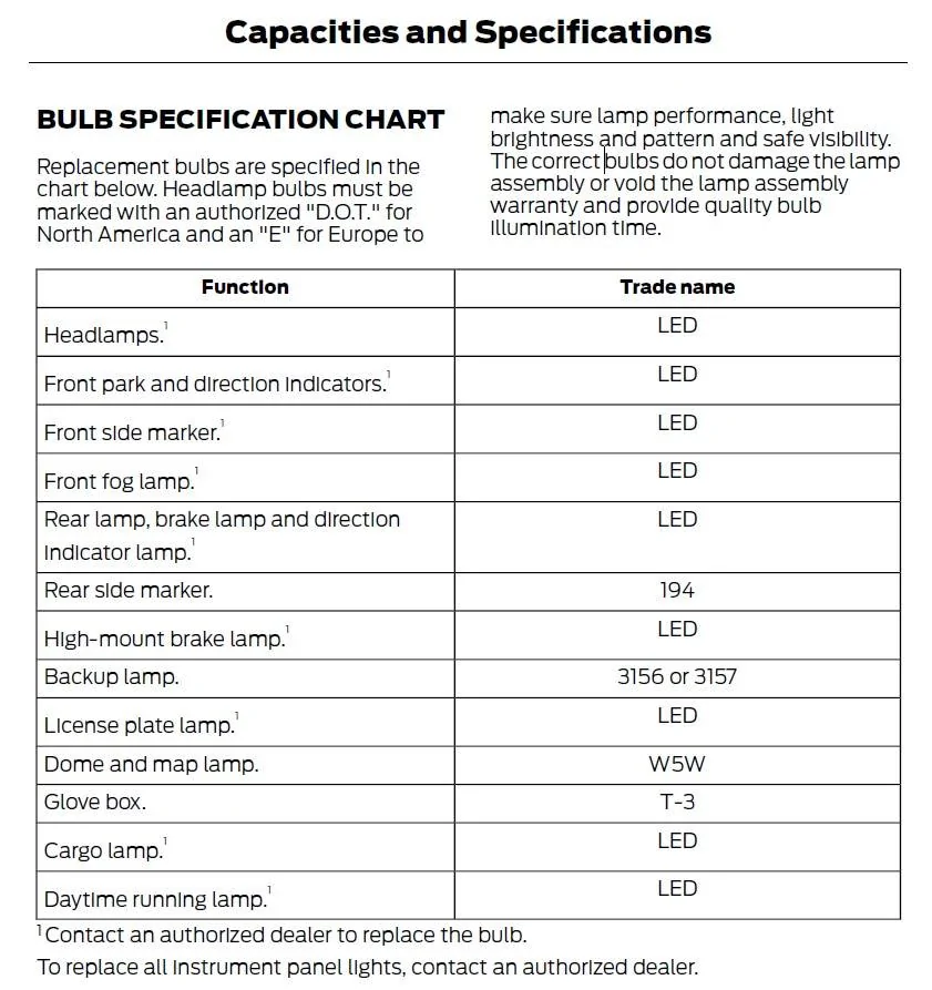

From the 2020 Mustang Owners Manual

Earl,
Hate to be the bearer of bad news but this time your info is wrong for the Shelby. The turn signals on the gt500 are definitely NOT led, nor is the parking light marker lights. 100%.

Okay I think I found it, its missing a number it should read HT7444NA not HT744NA @marklboris just need to confirm if I am right, cause if not then I am at a loss.
*EDIT*
Its the same as the '15-'17 lamps. My 2016 CS was a 7444NA or T20
