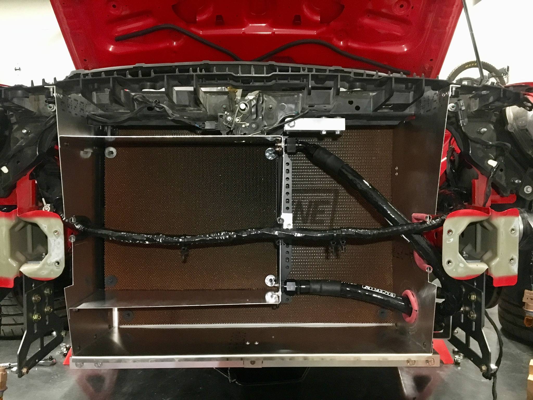

For my setup it is was a all in one kind of deal once you know what to buy. The Watson racing radiator close out seals off the supply side of the radiator better than any home brew solution I could have come up with. It also is a mount for a series 9 60 row oil cooler, which seams to be the right size if you just don't want to worry about oil temp again. Mine was only 232 deg while pounding the hell out of it driving at least 9.5/10. The Watson set up works with any of the radiators that mount in factory location, mine just happens to be the same as NeverSatisfied's with the mishismoto. Then just put race louvers in the hood. For my setup you do have to get rid of the AC condenser coil but in my case it was not a huge deal as a track only car, and I took the compressor with it and lost a few pounds. Look back in this thread I have some pictures as I was installing it all. So for the quick list of parts it would be as follows:
Watson racing radiator close out kit
race louvers (I did the center and sides but probably could have just done center)
Radiator (You chose) mine was mishimoto
Oil cooler Setrab series 9 60 row or equivalent by Earls (mine is Earls due to availability)
Mishimoto oil filter sandwich adaptor ( mine was the thermostat controlled unit)
30 deg -12an hose end fitting for the filter plate side. I had to get mishimoto -10an fittings then straight adaptors to get to -12an
6' of -12an hose
-12an fitting to go in the oil cooler
one -12an hose end straight
one -12an 90deg hose end
In my case I also added gauges on the oil and coolant since the computer does not know what they really are.
I think at this point there is enough people that have tested this combo out to say that for sure if you do this handfull of things you can keep it cool, and there are options from complete fabricate it yourself to buying mostly ready made options.
If any one needs it I can get, add the part numbers to the list of parts, just let me know and I will do that.

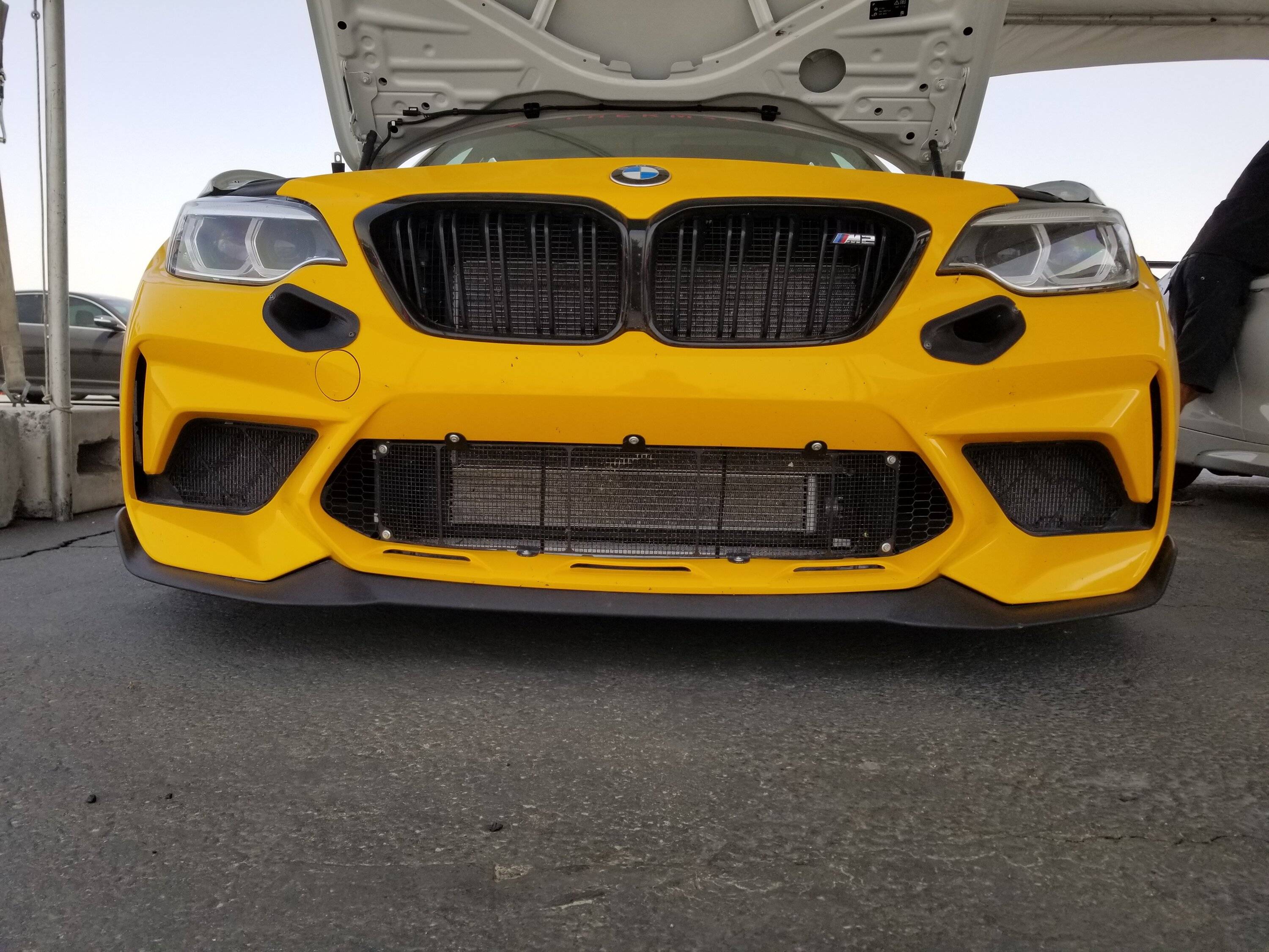

This is the front end of a BMW M2 Clubsport. It's a ~450hp car which is specifically meant for track duty, but is basically a street car. There are at least 5 different rads in this shot and there is at least one more on the back for the diff. Cooling a car on track is not such a trivial task for anyone.

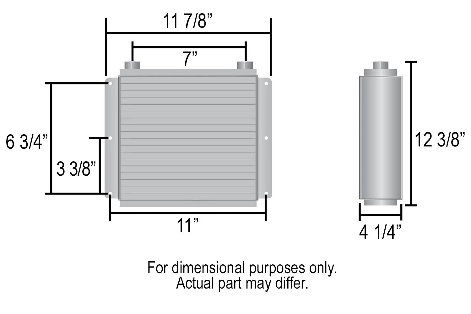

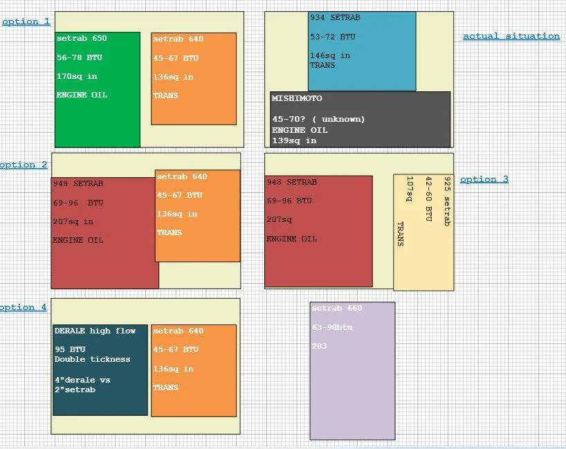

Seems there are a few votes for the 948 cooler. But what about replacing the OEM trans cooler with a larger one beside the 948?
@Flyhalf :
  1. In your layout diagram below, do you believe Option 4 is best to put in the largest oil and trans coolers?
  2. Did you research to find the Derale high-flow 95k BTU 4” to offer more oil cooling than Setrab 948 or 650? Is it Part Number 61878 ? [dims below]
  3. Or did you research to find that it fits beside the Setrab 640 (trans cooler)?
@Flyhalf :
948 is a very big HX and seems like a good fit for the oil cooling. But you do have to carry the weight around. Can you get by with something smaller?? Not sure, have to test or at least run some calc's. Note: Neversatisfied has a slightly smaller oil cooler (setrab 650) which should be working well once system is fully sealed. That 4" derale is a monster. Not sure that much is needed.
Flyhalf commented awhile back on the A10 trans cooling that he is using the setrab 934 and is working great for him w/ his bypass mod.
On the Mach 1 oil and trans cooling, I haven't seen pics of the HX's. My understanding is that the oil to air cooler is in the driver side "cheek" and the trans coolers are in the (1) passenger side cheek & (2) same location as the GT (sandwiched between cond and rad) in front of the condenser, lower section. But I'm not 100%.
If anyone has photo's of the Mach 1 coolers, would appreciate seeing them. Curious of the sizing and confirm location(s). And wondering if the hardcore track folks are finding the oem coolant, oil, and A10 cooling systems are adequate?
On your Mach 1 parts list, nothing wrong w/ the oem oil adaptor and such and can go in that direction. But most seem to go with the aftermarket oil adaptors when installing a remote oil to air cooler. Maybe a little less money and gives easy location for temp and pressure measurements.
