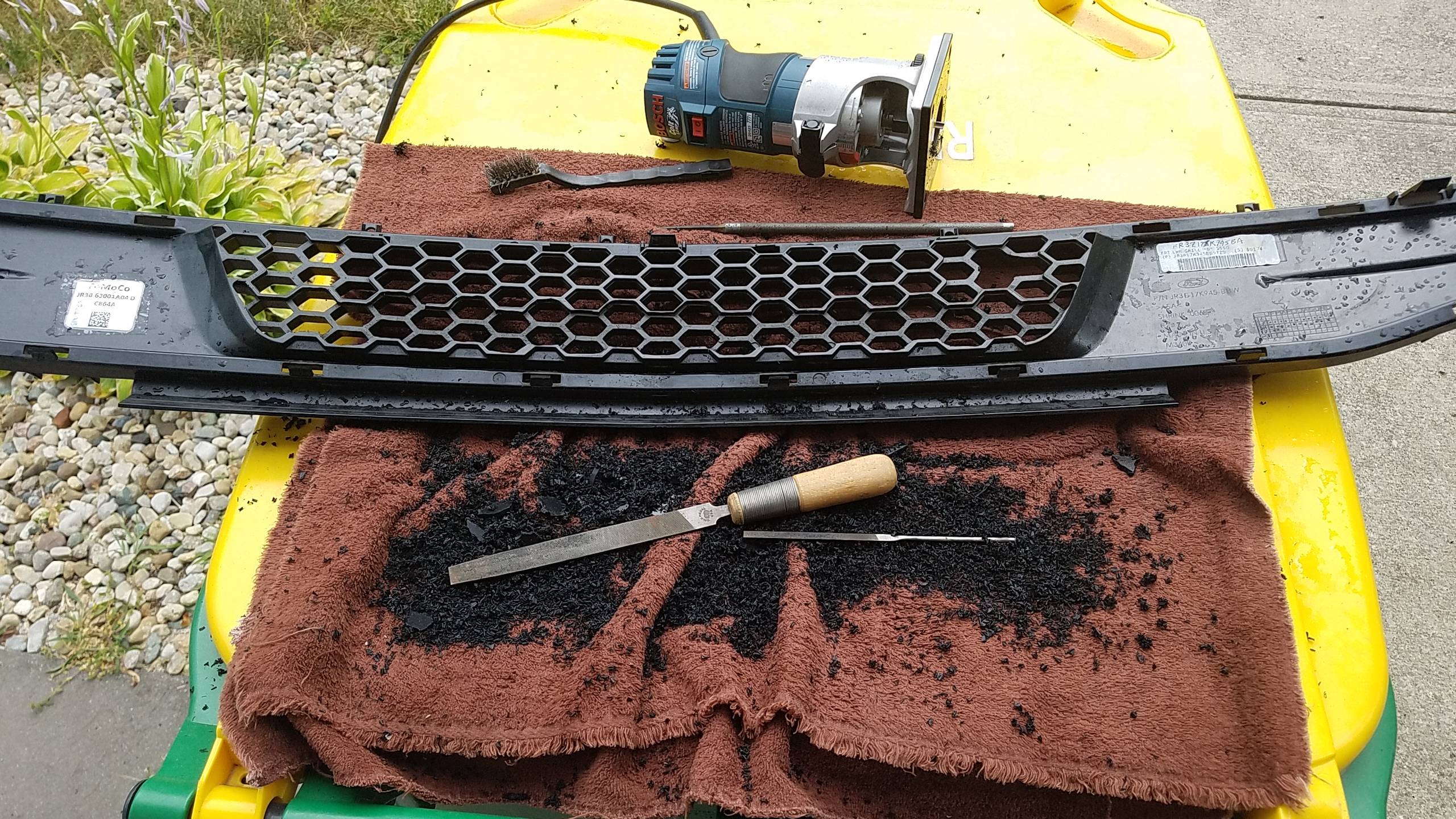

I spent two days in 90+ heat with my front clip off, studying and measuring to see what is possible.
I also opened up all my upper and lower grille cells using a router. A full two hours.

Now that's a serious grille mod ... some heavy duty whittling. I did mine with a drill and dremel tool. Took a lot longer than 2 hrs. Change the units for me. Very tedious, especially when you are close to a "perfectionist"☹. My curse.
You said you were serious and wanted a homer at the 1st at bat. Keep this up and you might do exactly that 👍. If you remove the oil heat load from the coolant and seal this system up with that big grille, you will have ice sickles forming at the track:) . Keep going.
