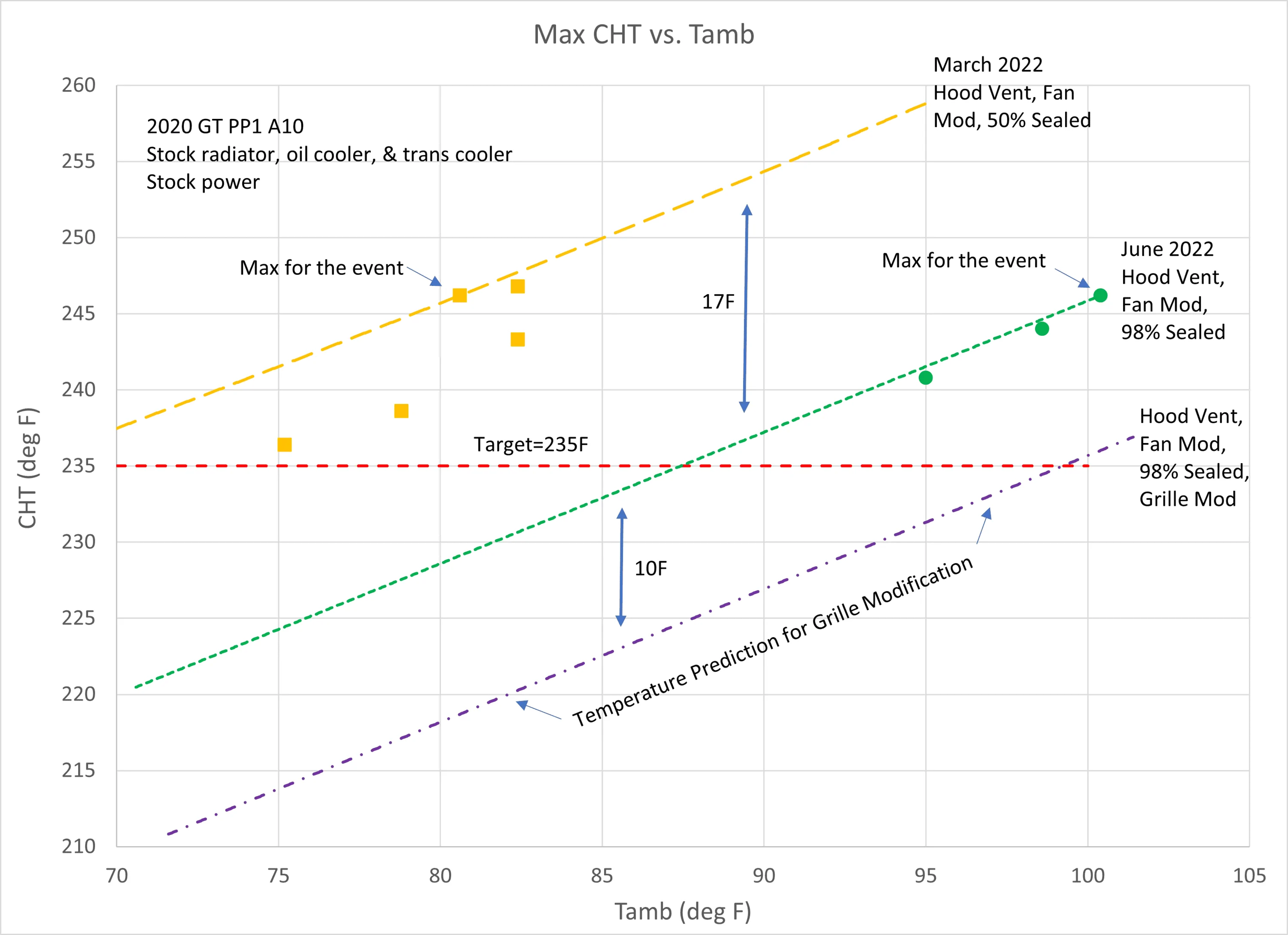

I finished looking and analyzing my recent track data. See attached chart which I hope will help the GT track folks out there better address their cooling issues. I'll make a few quick points.
1) As mentioned previously, sealing the radiator really helped cooling but this chart makes it very easy to see. Going from ~50% sealing to ~98% sealing was worth 17F. Maybe I left 2 degs on the table with intensity, so maybe it was only 15F benefit. apples to apples. Still very significant.
2) The trend lines were created using my flow and heat transfer models, after anchoring to the max CHT point as indicated for each Track event. And if you look at the other data points, the trend lines look very reasonable.
3) You can see how ambient temp influences CHT. As expected, it's significant. I sorted of glossed over this mid way through my mods, since most of my track days were close in Tamb. But not last weeks track event (+15-20F hotter). Hence the need to generate this chart.
4) You will notice in the March data, that there are points below the curve. As forum member Never and others have pointed out, how hard you go will influence the max temps. This data shows that clearly. In the early sessions in March, I was loafing☹ .
5) As discussed previously, my next mod is the grille. I needed to decide how much rework was required to reach the goal of 235F. Max rework or something less. As can be seen, I need the max. Target of 235F CHT reached on a 98F day. Anything hotter will exceed. Also note the grille mod is worth 10F in CHT. Decent improvement.
@nbjeept, your 235F CHT is right in the middle between 50% & 98% sealing curves (82 inlet - 5F = 77F Tamb). This tells me that you could do more sealing and get some additional improvement. Good luck👍. Cheers.

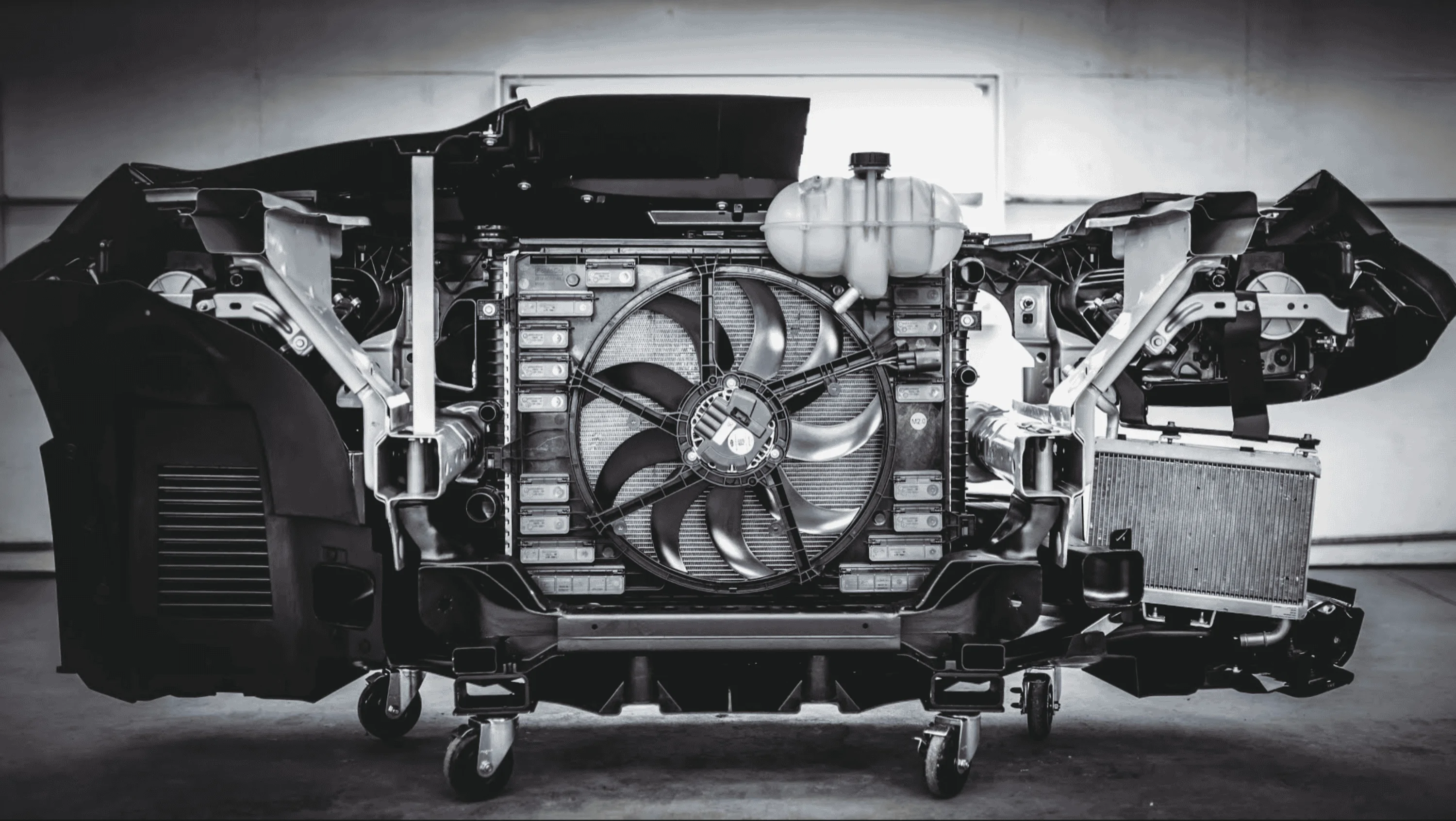

I keep seeing the images posted on here in various threads of the above GT500 electric fan. But what I don’t see or can’t find are the specs on it.
Does anyone know what the CFM (cubic feet per minute) is of that fan - and is the CFM based on the high or low speed?
CFM’s are also key to keeping any rad core cool. The higher the CFM, the cooler you can keep the rad core.
The other important thing with any electric fan shroud is that a high quality fan will have the integrated “flaps” as seen on the GT500 shroud. Those flaps allow air pass through at certain speeds to reduce the pressure around the system.
Just as an example, on my 94 Cobra I have the SPAL dual 11” fan setup, where the shroud also has integrated flaps. This fan is rated at 2720 CFM (some specs show 2780), which is more than enough for a street application. I also have wired it into a aftermarket fan controller (but tapped into factory harnesses so it operates exactly as the stock unit did), but when the fans do come on, I also wired it so they come on at “high speed” even though the unit can do the gradient low to high operation.
I am very interested in the GT500 fan but am very curious as to it’s specs - can anyone get the CFM of that unit?
If some are having cooling difficulties, despite upgrading other components, changing t-stat, etc., look into upgrading the electric fan and compare CFM ratings, higher CFM is best and it may help.

Glad it makes sense and is helpful👍. On the tips for sealing, go to post #96. That should get you started. The only thing I would change is the part A = 50% and part B is 50%. After I sealed the front and instrumented the system, it turned out that the front leaks are bigger than I originally thought. So instead of 30% of the total leak, it's more like 50%. To complete A+B, is 2 days. It's very tedious and takes time. There are leaks all over this system.
As far as the length of this thread, yes, I agree it's very long. I started in Oct 2021 with a question cus I was clueless on how a brand new GT w/ PP1 package could overheat really in only 3 mins on the track. Now 8 months later, there are answers.
After some advice from the Forum, inspections of the OEM cooling system, analysis, mods, and track time, I now have the cause and solution ... which is outline in the simplest possible form in post #278. As they say, a picture is worth a thousand words.
Took 8 months to have enough data, mod time, and analysis to be able to make that chart ... and a lot of interesting discussion and additional data from other members along the way in this thread.
So whoever is reading this now and wants the bottom line (cause & solution for post 1), go to post #278. On long threads, I usually start at the end and back up.
Let me add this ... are there other solutions .... yes, absolutely. But none more effective in my opinion from a cost, weight, and simplicity perspective for the non-competition track focus. Now the wheel to wheel guys, they will need more than post #278.
On your temps, they don't look too bad. 240F CHT. But as you hammer it and as ambient changes, they will be increasing. Good Luck and have fun driving the car. I wanted that gauge cluster but couldn't afford. Cudos. Cheers.
