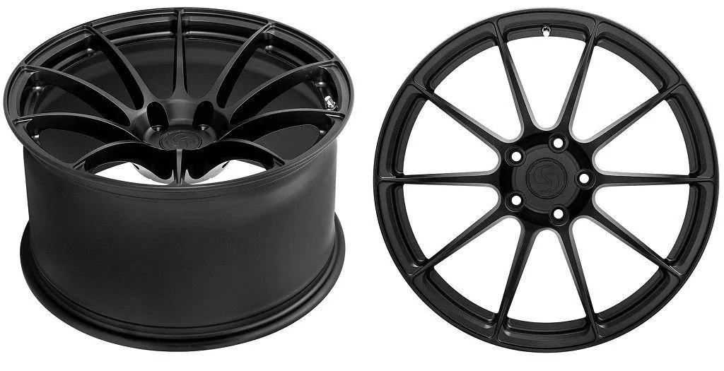

I run a 19x11 squared setup with 305/30R19 Cup 2s on them. I went with the Signature SV502s. They're fully forged - so extremely strong and light (mine weigh 20.4lbs, 46.4lbs with the Cup2s mounted). They also have 1/2in of caliper clearance - my OEM wheels had 1/4in.
I rotate after every track day. I did 2 days at Thunderhill a couple weeks ago. Thunderhill is REALLY tough on the right front tire, so the beginning of day 2, I put the right front on the left rear, moved the right rear to the right front, etc.
Really, really happy with my setup. Super light, very strong, and built specifically for Motorsport. Price will come in between your typical $2K wheels from 6GRs/Apex/P51 and the Forgelines.

Do these come in an "R" look? I want easy to clean...
They do not. My understanding is because the R style wheel is inherently heavy (when not made of CF of course!). If you look at the Vibe wheels, they weigh in close to 22-24lbs (if memory serves correctly) even though they're fully forged and made similarly.
They're not as bad to clean as you'd think. Because the face of the spoke is so thing, so it's very easy to clean with a wheel woolie since you don't have to attack each one at multiple angles.
Signature does offer the SV501 - which is a thin 10 spoke wheel.

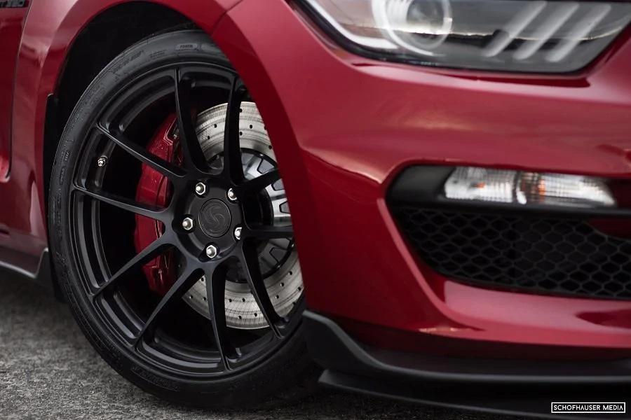

Have in mind rounding up another set of wheels for the track.Would like to hear from you guys that run both the stock set of 19x11 & 19x11.5 'R' & the 19x 11 squared. Want to make the right choice if there is one.
Another question, how often does one rotate with the squared set up?
TIA, Rex
Often wondered why Ford just didn't use a squared set up to begin with on the 'R' wheels?
I went through the same process about 6 weeks ago looking into every wheel available to run a 19x11 square setup. Lots of call and research.
Criteria:
19x11 square setup
Strength as I will run these both on street/track
Caliper to barrel clearance
Weight (as close to OEM R wheels but at a reasonable price)
Knurling
Price as mentioned was important.
In the end I choose the Signature Wheel SV502, gloss black with knurling. Terrance has been great during the whole build process and surprised me with some swag in the mail as well.
While the non fully forged were strong and proven they did not have the caliper clearance or weight I was looking for. There are many threads on caliper/inner barrel scratching with limited clearance wheels. It has been known to happen on the OEM carbon wheels as well.
Coming from motorcycle racing/track days where we run lightweight wheels every half pound of rotating mass reduction makes a very noticeable difference. Same effect on 4 wheels.
I also plan on running titanium lug nuts for additional rotating weight reduction.
Hope this helps. PM if I can help answer any questions.
