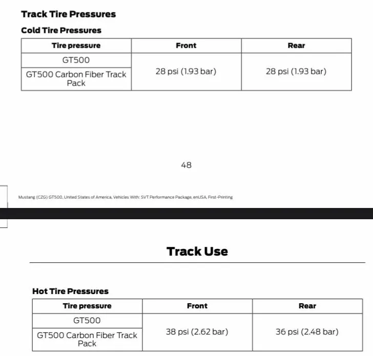

May 20, 2019
Canada
Ben
2017 GT350
Something interesting I found in the 2020 GT500 owners supplement. It suggests 38 psi F and 36 psi R on the base GT500 as well. The base comes with PS4S tires.
