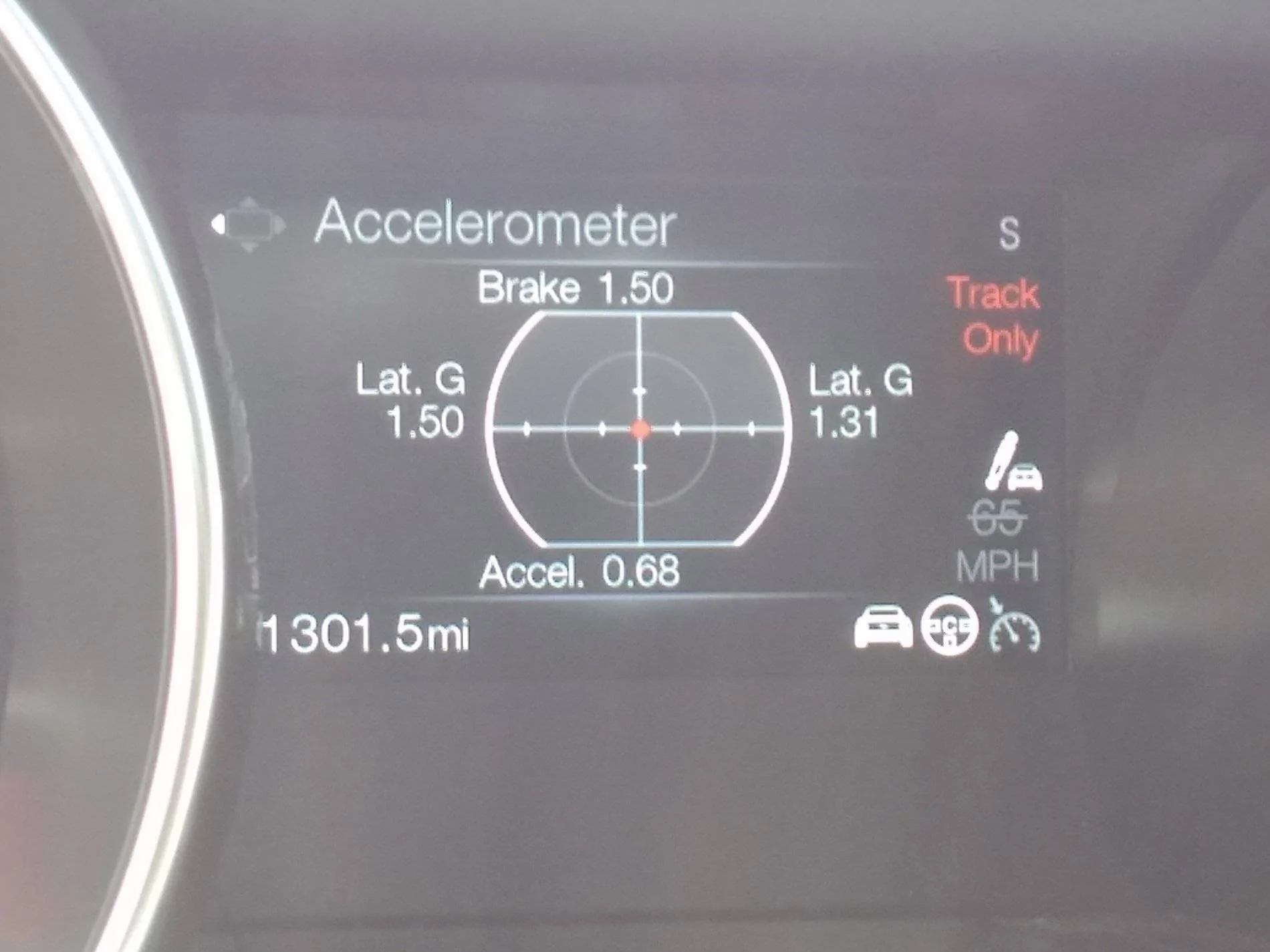

And, by the way, this is what the tire is capable of: 305/325 stagger

how many days/hours do you get out of a set? what track and what lap times? I don't think my 3-4 day experience is that far off of normal...
As you can see in the dash photo there are 1300 plus miles of track time recorded. Lap times at Pacific Raceway are between 1.3 to 1.34 minutes per and speeds are up to 158 mph into the braking zone at turn two. Speeds at The Ridge Motorsports Park aren't as high, around 130 mph but cornering is similar. Ask Honey Badger, we have played together. I have been a team owner/ racer in the past and have 30 plus years teaching.
