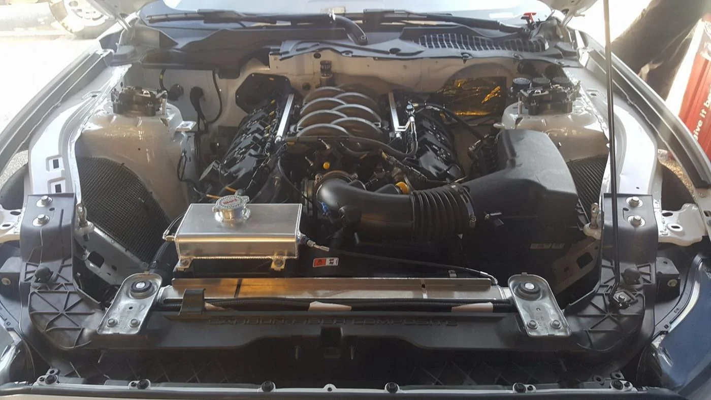

LOL This one? This car must be slow and handle like garbage, no CAI, No K-Brace, No Strut Tower Brace, No 2 or 4 point braces, No Cradle Lock Out.
:ford: ..........:ninja:

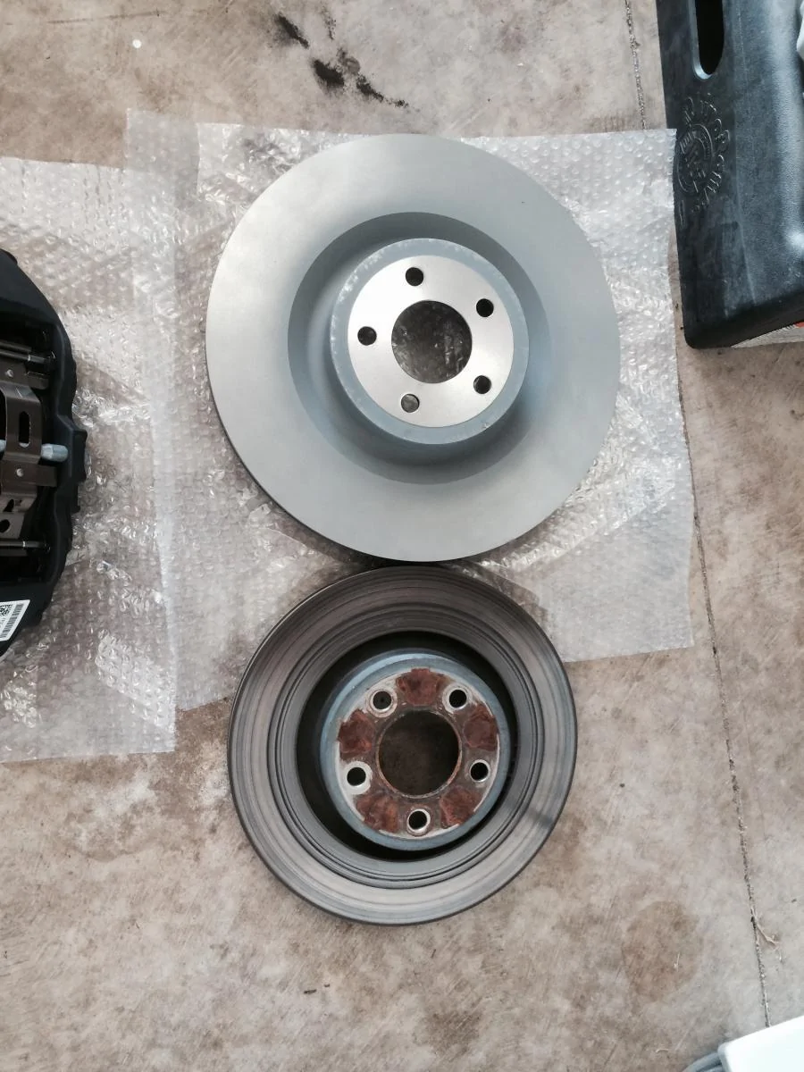

Stock base brakes (not 4 piston, the itty bitty 12.6") on bottom after 1 track day with stock pads, no cooling, stock fluid.
Replacement Brembos on top:cool:
FYI- those groves are very deep. Rotors were tossed.
Doesn't that little pony have a full cage?;)
No debating the issue at hand, just think it might be a little more "sturdy".
But I agree, it's probably super slow without a JLT.....:D
