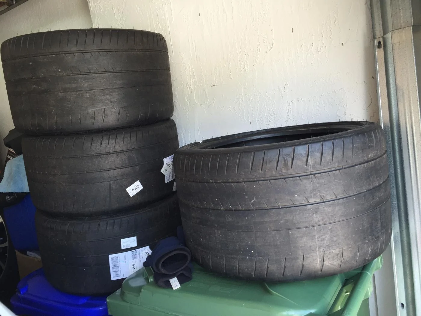

If it wasn't for the stickers... :shocked:
Yeah they were new takeoffs from another C7Z with <100 miles on it... many C7 buyers who won't ever track their cars end up replacing the Cup 2's with more streetable tires. Hence it's a good opportunity to buy a set at nearly half the original cost... these tires are approx $500 each! :eyebulge:
I know for sure that eventually when I change the GT350's MPSS tires to Cup 2's... there will be a major difference in terms of grip and handling at speed and at high G's.
