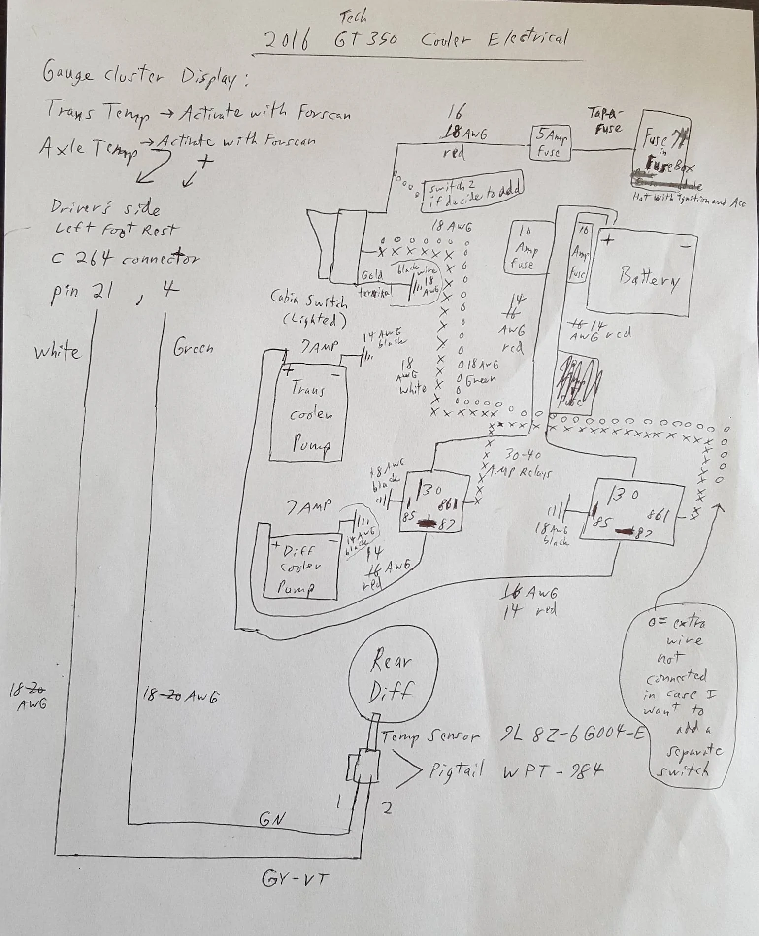

What transmission cooler setup did you use? Do you use thermostatic control? Does your setup retain the factory temperature sender?

Here is a pic of the complete electrical diagram I made, using a switch for activation. On the left is the wiring to install a sensor into the diff so it will read in the factory dash display.
I used the Ford cooler and lines, had to cut the end of the lines and use AN fittings with stainless steel braided hose to attach to the drain/fill ports of the transmission. Works awesome, drops temp very quickly. You don't touch the factory transmission temp sensor, no need to.
You will need an external pump, I recommend a gear driven pump instead of a diaphragm pump. Much quieter. I can't hear mine from inside the car unless I really try hard (put windows up, turn off radio, turn off air conditioning).
Cost me about $1000 total to install, but I got a great deal on the ford cooler/lines, if don't price shop will probably cost $1,500. This is with me doing all the labor.

Similar as rb92gt for my trans cooler. Used a gear driven pump (RB Racing scavenge pump); it’s fairly quiet and to date reliable). Used the factory trans cooler kit which contains brackets, radiator, and cooler lines. Cooler lines cut around the front of trans location and AN fittings attached. I use a manual switch via relay to turn on the pump. Temperature readout is factory sensor and used Forscan to activate it on my center digital display.
I did the work myself (except for AN fittings attached to factory hoses) and everything cost me about $1000. To date I have over 35 track days on this setup and many hours of it being on during the road trip to and from the track.
