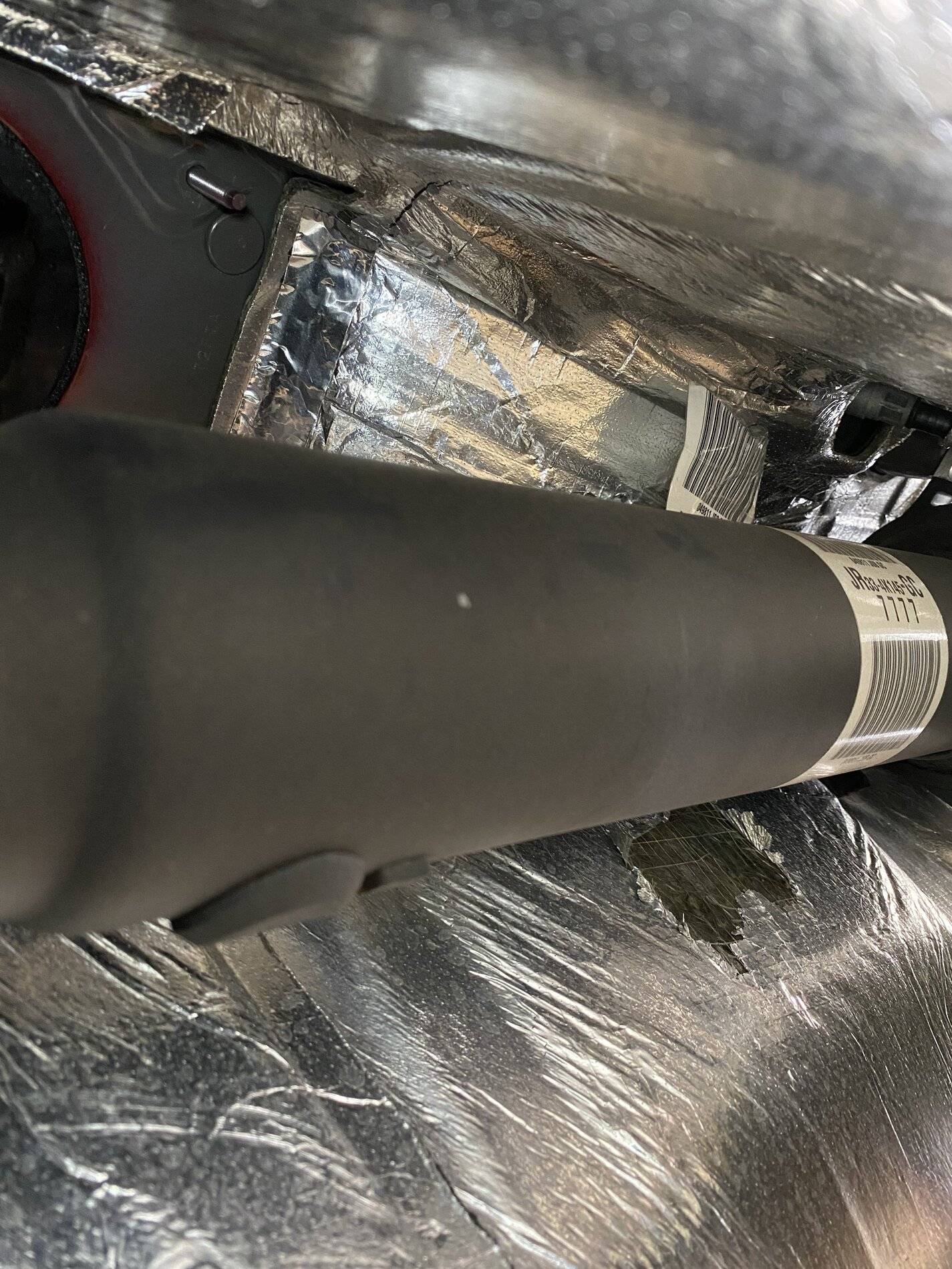

Well CJ, I finally found the issue. Darn label attached to the front driveshaft towards the aft end upstream of the bearing. See photo. Really surprised I missed this after my 2nd check prior to the dealer visit. But it's dark inside the tunnel and with the resonator in the way, I just missed it.
Notice in the pic that it beat up the insulation, but not bad. Minor. Head scratch why Ford would wrap a label around the shaft vs. a small 1" x 2" paper sticker like 95% of their other parts.
Let's see, I wonder if the glued on label right above a 700F component would soften and come loose??? And let's see, I wonder if there is any centrifugal load on something glued to a shaft that rotates at 6700 rpm (155 mph in 7th gear 1:1). And if the label came loose, I wonder if it would make a noise and doing any damage?? Mind boggling to me.
Thanks CJ and other for the tips. Nice and quiet now.
