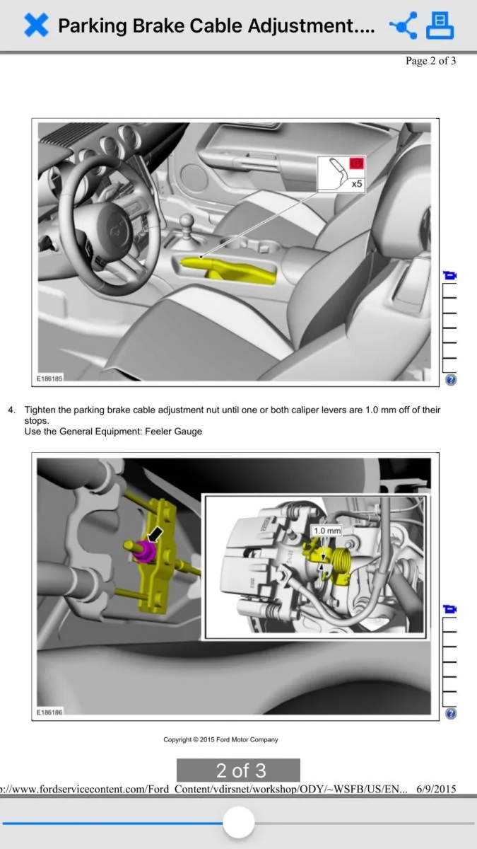

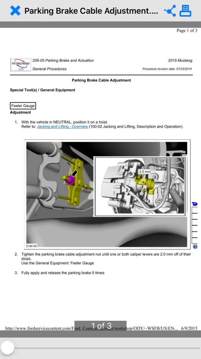

Here is the pic of the OP description.
I was having some exhaust work done and wanted to get access to the adjustment - it's on the left side of the car 'standing' vertically on the drive tunnel. You will need a socket/open wrench and a grip to hold the other end (other wise it will turn infinitely).
Hope this helps!
