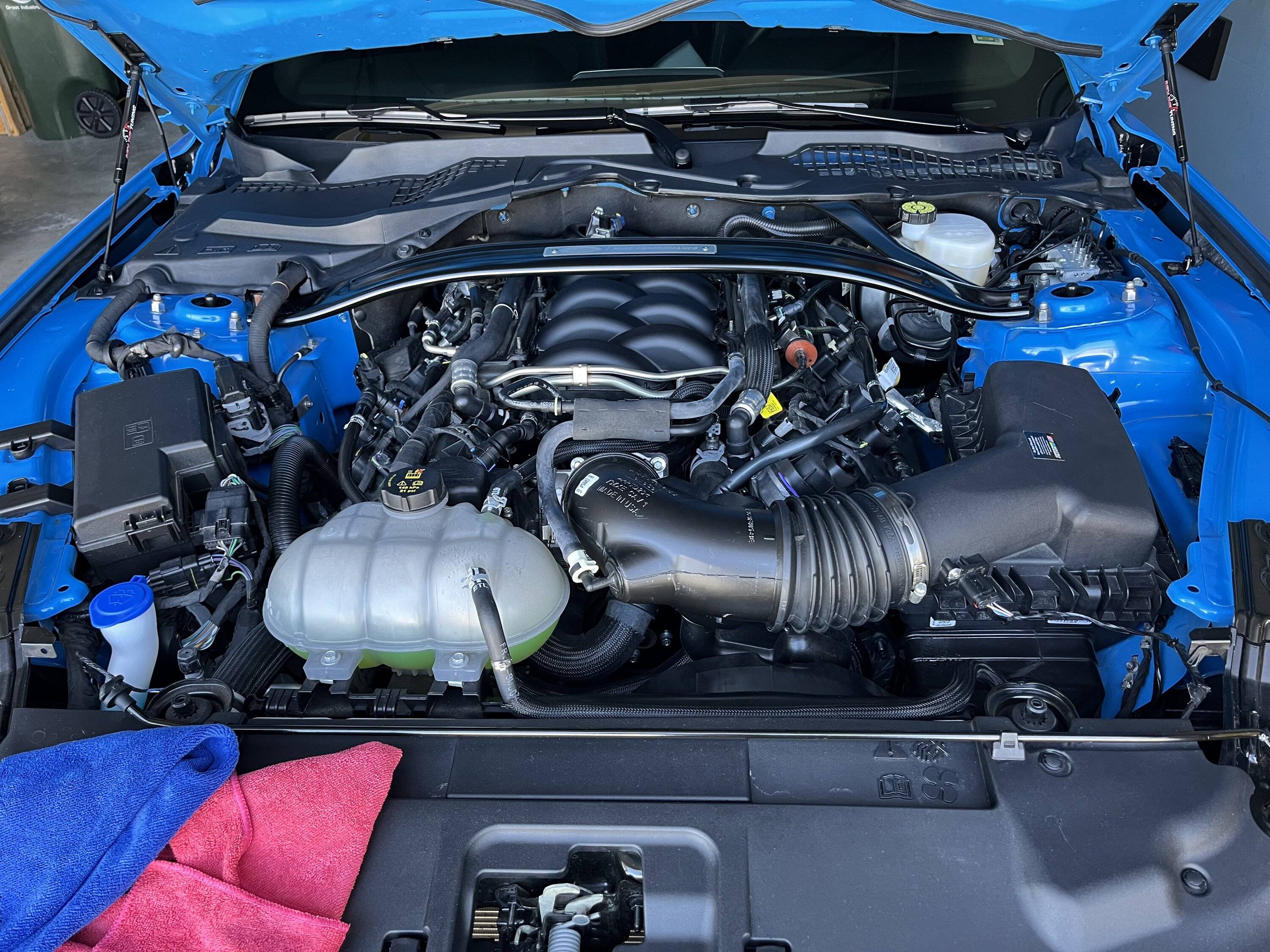

Just added the Ford Performance strut bar and cowl extension piece. Heavy suckers, was really surprised by the weight. I had to remove the wipers, used the Lisle tool on amazon, solid tool. Easy install, just be careful when you're positioning the strut brace as you don't want to strip the studs. And hope you have a flexible ratcheting combo wrench, even with the wipers off i dont know how some people were able to even get a socket wrench under there.
Steering feels a bit tighter and immediate and the car a bit less jiggly on bad pavement.
Have the Ford Performance Track Handling pack on order, can't wait. These cars feel like marshmallows glued to twinkies in stock form.
