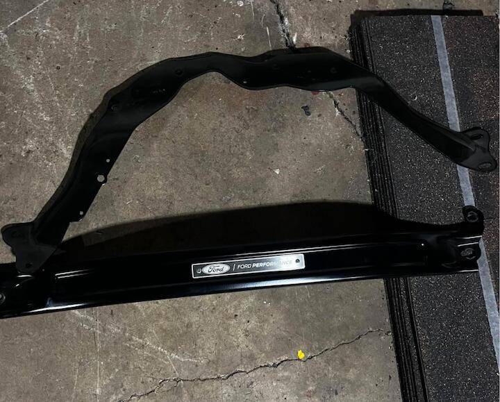

Strut tower brace
HuskyDad
Aug 31, 2022

$100 a good deal... off a '23, going onto a '21...

You need the cowl extension to go with those parts as well. 100$ is half price so would be a good deal.

What is this "cowl extension" you speak of?
(I'm interested in procurement of a shock tower brace at some point, and it would be a bummer not to get all the parts...)
In HuskyDad's picture, I take it the cowl extension is not the "boomerang" looking part in the pic?

No, the "K" brace is the boomerang piece in your pic above and there is also a smaller/lighter metal piece that bolts on under the engine cradle/undertray as well.
The cowl extension ties the rear of the firewall at the base of the windshield into the front of the wiper well where the K brace bolts under the wiper well cover. here is the part number 2015-2024 Ford Mustang Extension Panel FR3Z-63016A52-A | TascaParts.com
This thread had all the parts number lists and tons of info on how to install the parts, page 1 has the parts list for all except the strut tower and upper K brace you already have page 10 shows the rest of the parts needed. Your car may already have the lower K brace so you may not need it.
(3) PP Strut Tower Brace kit + Cowl Extension + Lower K Brace Install Guide | 2015+ S550 Mustang Forum (GT, EcoBoost, GT350, GT500, Bullitt, Mach 1) - Mustang6G.com

$100 is a good price for both of those pieces HuskyDad.

That extension panel is needed, don't think it is not. I made the mistake of not installing it and ended up having to remove everything and installing it later. Not fun doing the same job twice.

Echoing BD and others, make sure you order the cowl extension piece. Not sure why Ford Performance never bothered to include it in the brace kit. $100 for the FP brace kit is a good price as others have already noted

Thanks BD! I didn't realize there were all these extra parts to complete the project. I've always assumed (looking at what parts houses offer) that the main bar between the shock towers was it. Now I'm wondering if they're just selling us a cosmetic package (I'm sure the shock tower brace does some good, but....)
Again, thanks for the additional information, and the link to the "parts needed" thread.

My car came with the lower K brace on the subframe, but I added the strut tower and upper K brace but did not know about the cowl extension until I found it in a thread here.
After adding the strut tower and upper K brace my car felt much more planted in corners but even more so after installing the cowl extension since it ties the strut tower and upper K brace into the chassis even more for much better rigidity. IMO it all works together to improve handling and road feedback.
