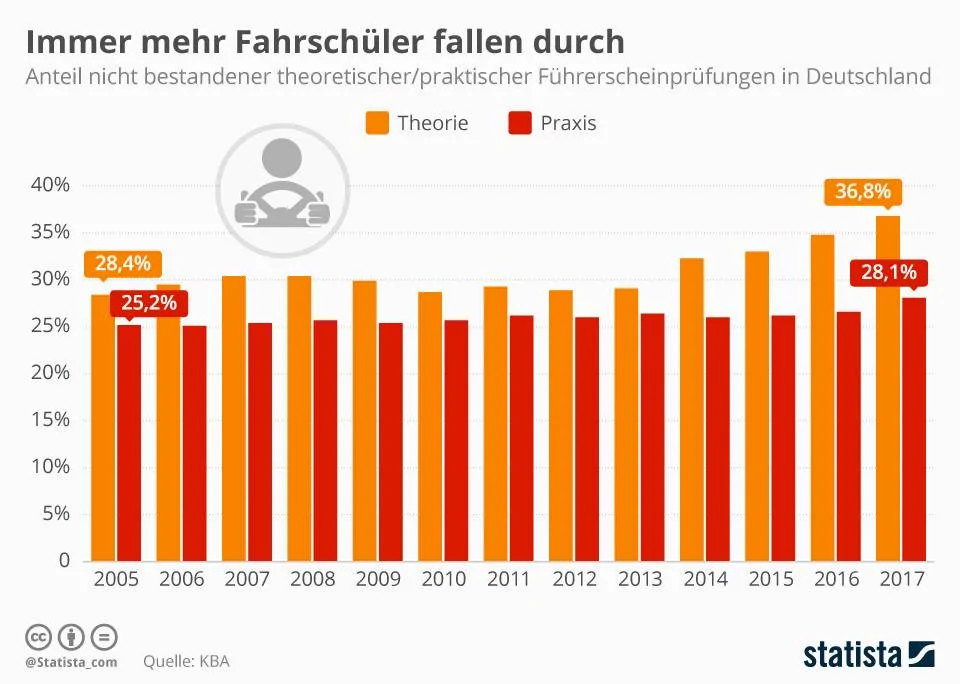

I have your driving education is a lot better than here in the US.
That may be the case, but the proportion of those who don't make it through the test at the first attempt is also increasing from year to year.
Maybe we're just better at keeping the incompetent away from the wheel.
But when I see what's going on on our streets, I don't think we're doing too well either.
orange = porportion of failed theory exam
red = porportion of failed driving exam
