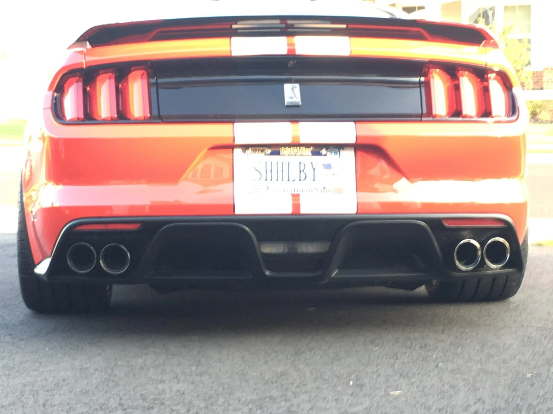

I've been using contiforce contact 325s in the rear and they fit and look good. I don't even know if they make those particular tires anymore, but they work well.
The red center caps are now Ford (black), but you get the jist.

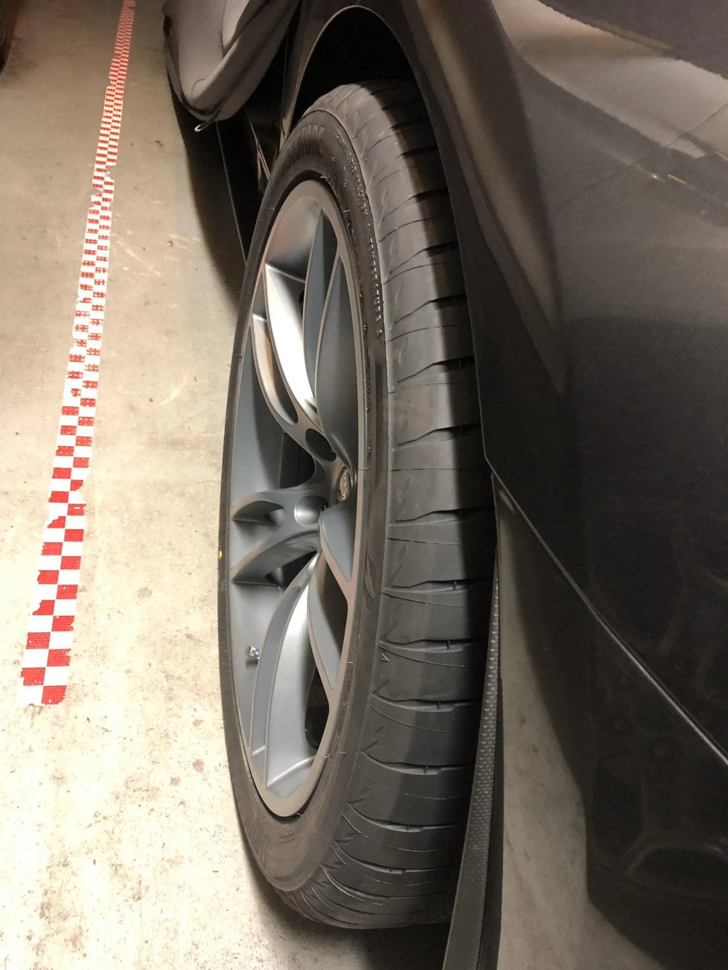

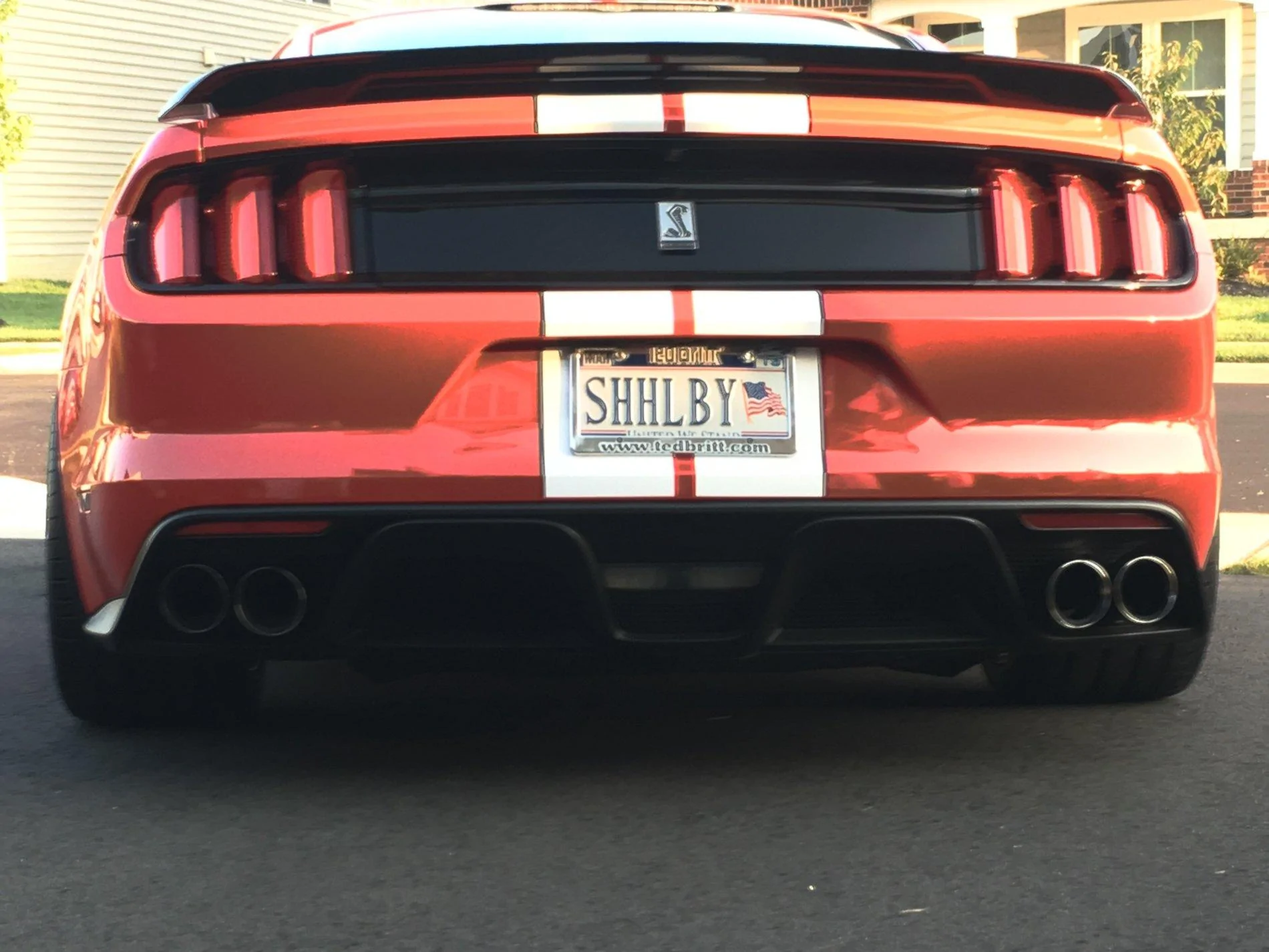

Here are Michelin 325's on 6GR wheels (rear), 305's (front). IMHO, they don't stick out too far.

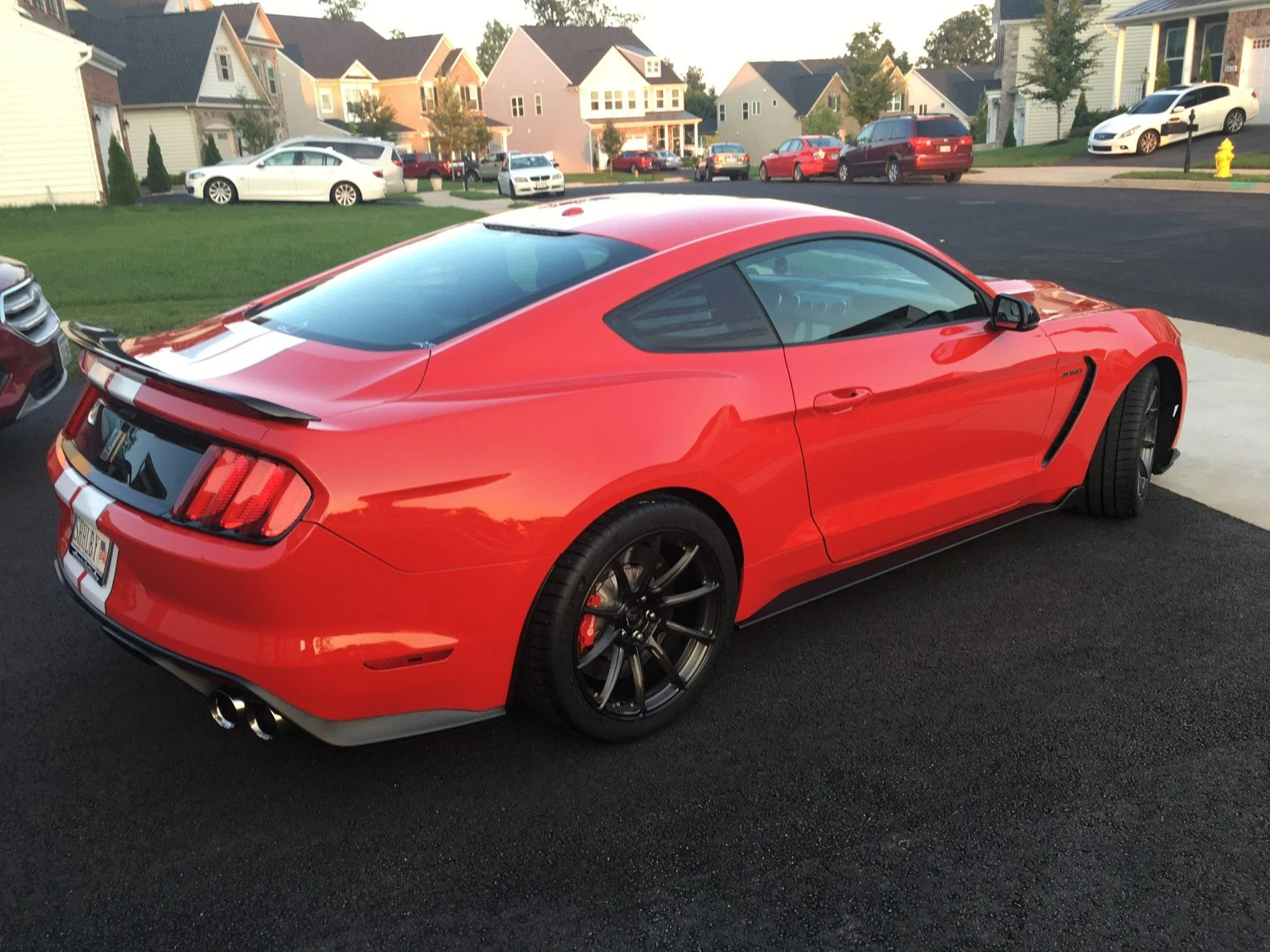

not 6GR but BC Forged in R spec with offset for 350. 325”s 30 19 rears....look good to me. I say go for it...unless the 6GR wheels have different offsets which make them poke more, the 325”s should look awesome.
