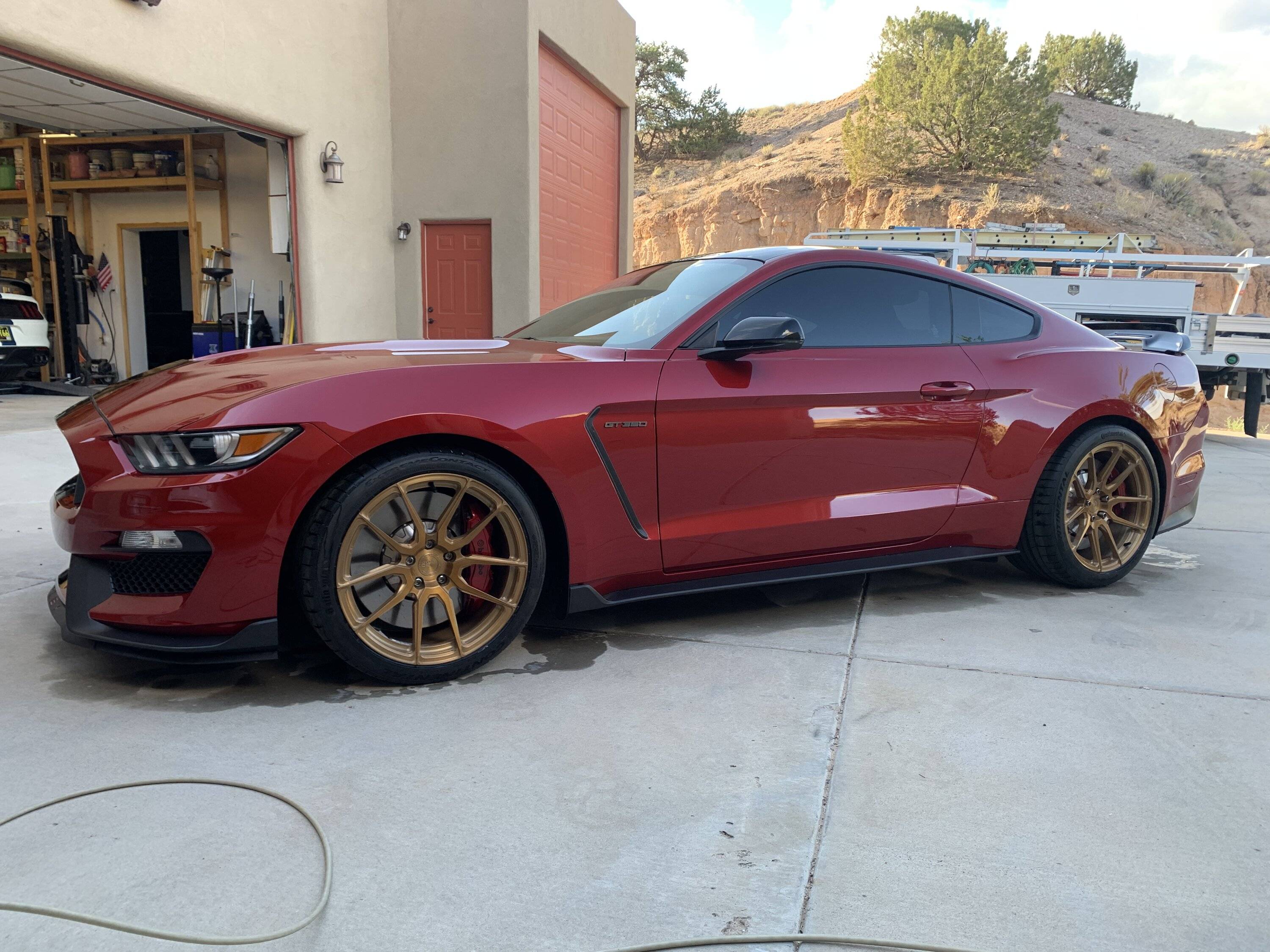

You could just use the R spec tire setup. 305’s front, and 325’s rear(oem is 315). The R setup looks better to in my opinion. Looks even better lowered and handles very well. Ideally you want a 10.5 front but the 10 would work fine. This is conti’s on r spec and down an inch.

These are 30’s on 19” rims? Any rubbing?

Yes. No issue’s. 305, 325.
