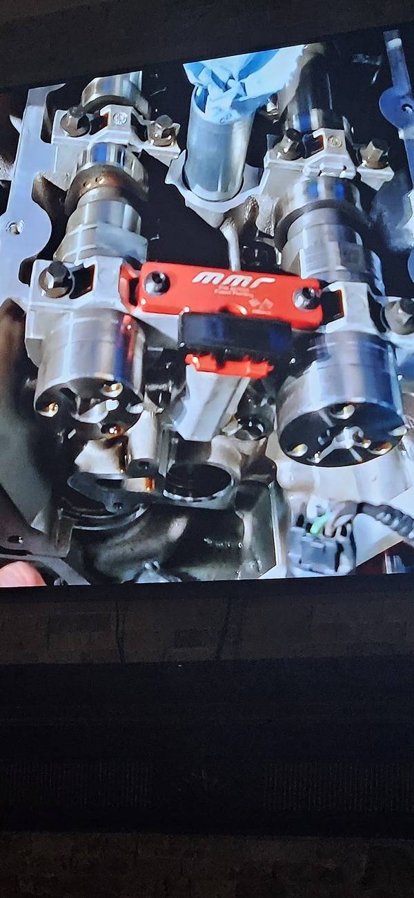

The MMR "Flip bracket" is worthwhile, I used in on my cammed build. I added the lightweight phaser plates (intake only I think). I did MMR secondary chains.

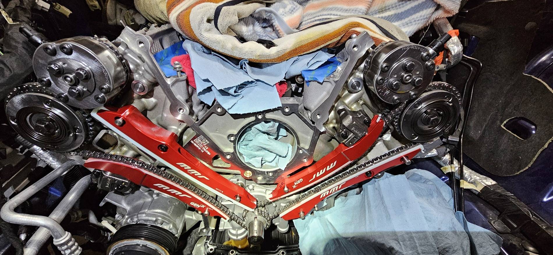

Since I was removing the timing cover, I decided just to do it all. MMR Hurricane High volume pump assembly, Boss 302 chain tensioners, MMR secondary HD chains, MMR secondary chain guides, plate, MMR Billet timing chain guides (someone I think had issues with the guides teflon strips coming off) MMR CS. Now is all of this even needed on a street whiple setup? Some say no. To me it was piece of mind. Good luck

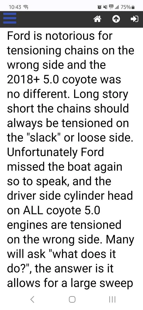

What exactly does it do?

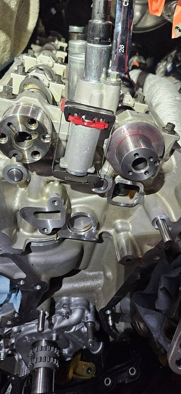

Do you have any pics of them installed?
Realistically, unless your planning to turn high RPM and HP I don't think it would be necessary but; I did it because it was cheap insurance and I didnt want to go back in to upgrade if my needs demanded it.
