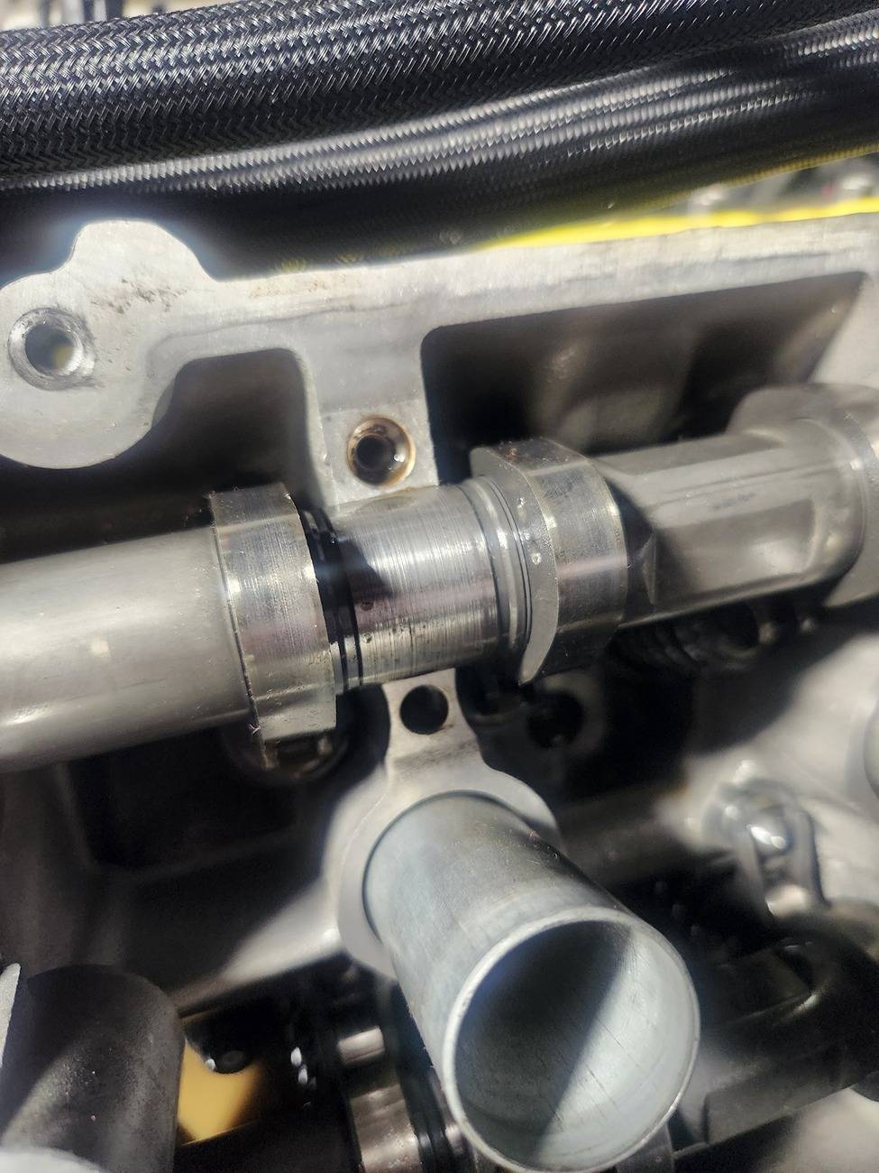

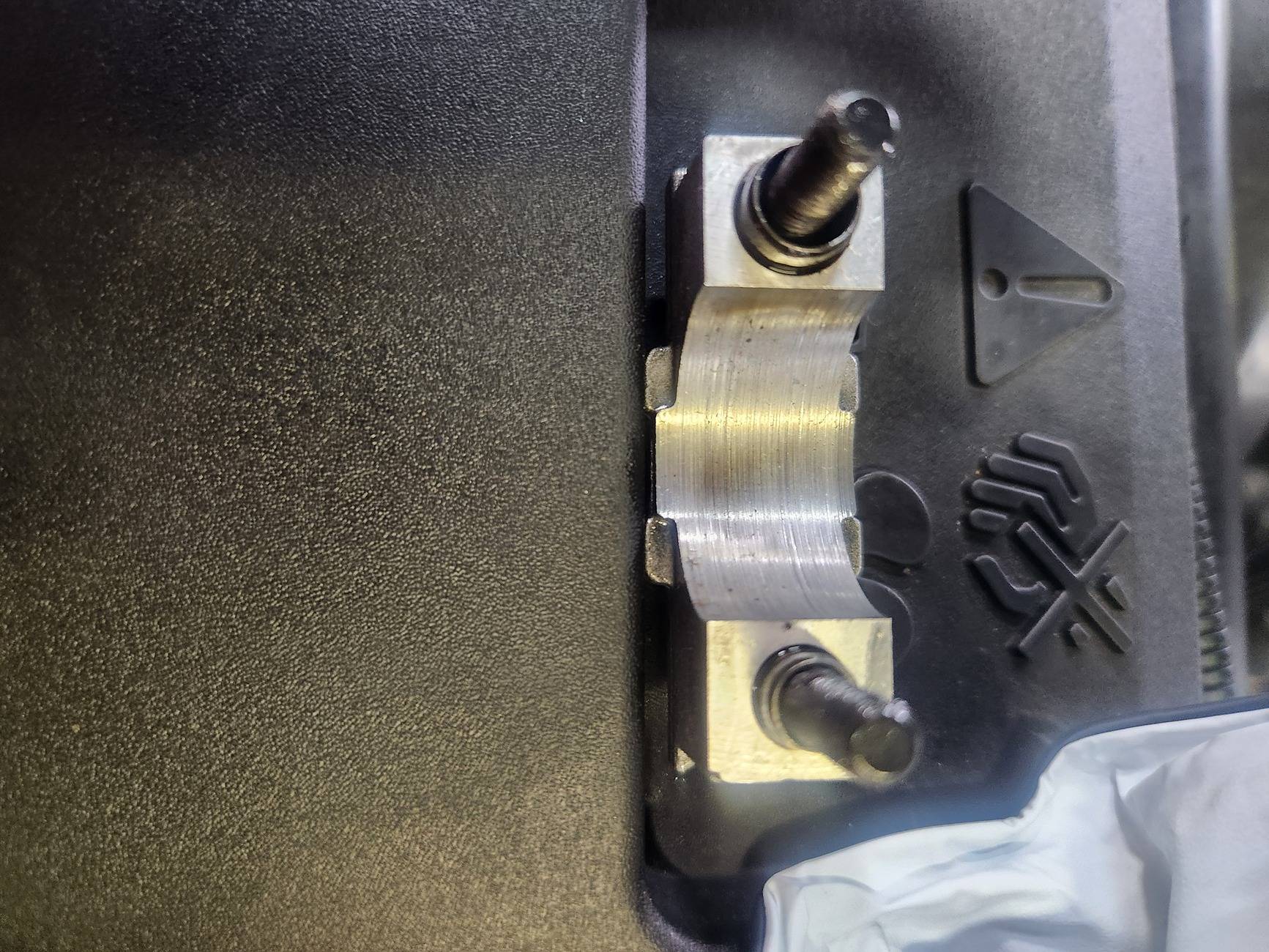

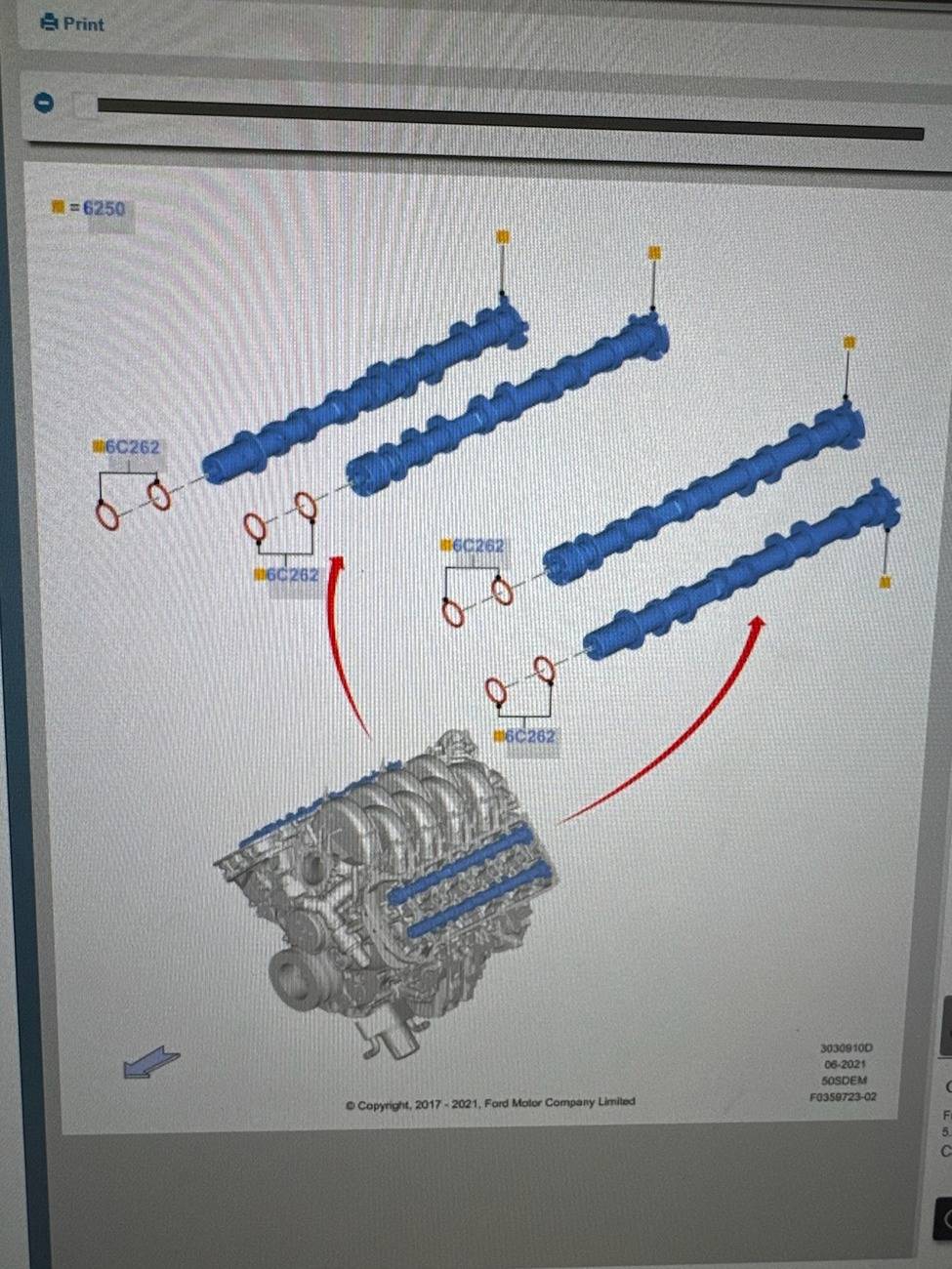

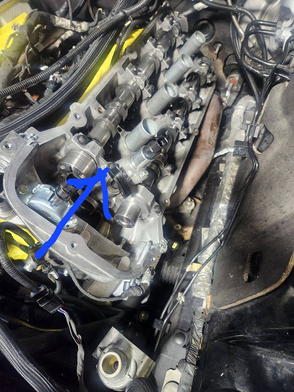

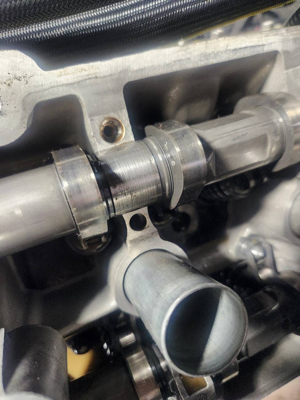

Still getting a cam correlation code, P0019 Camshaft Correlation Bank 2 Sensor B, and P0025B camshaft position-timing over retarded bank 2. There is a very noticeable tick that sounds like a lifter or an exhaust leak. I am thinking about running it up to about 8300rpm and keep it there until it lets go. I am so frustrated. :angry:
HKusp
Jul 22, 2021
39
2,302
2,950
Hampton, Md.
Jason
2018 Mustang GT
